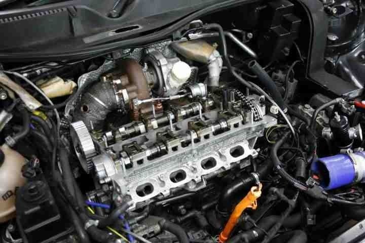

Will add some more when I get them :

Looking good, it seems to be taking them forever to rebuild it, no doubt i'm sure there doing a good job but i bet your dying to get it back.
Are you doing anything with the cam belt tensioner to stop the belt snapping again ?

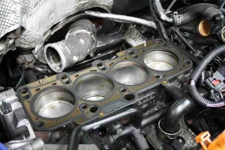

As far as i'm aware the reason behind the belt snapping is still a bit in doubt..... i'm just thinking maybe Danny never did anything wrong but was supplied with a duff cam belt tensioner.... or something along those lines.
Hopefully everything will be fine when it's back, but for me i would NEED to know what caused the failure - if only to prevent it again.

Didnt an allen key go through the cambelt at some point in its life? maybe one of the sprockets has some damage now..
Im sure Alex has checked everything thoroughly though.

Anyway yeah i agree with the spending money bit I done it all over again but have gona further this time,hence why I took it too Alex..it needed work I couldn't do...
The reason for it taking so long as I'm in no real rush and with Alex's just opening up Aks tuning he has a lot of work todo..and I mean a lot...it's he has took my engine to a whole new level..nothing has been unturned and everything has been checked within bentley spec...which I couldnt or know how too...

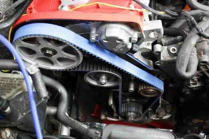

Smileys : gates racing belt, Ina Manuel tensioner, helix water pump,new bottom crank pulley/ bolt *and new cam head crank pulley :)...

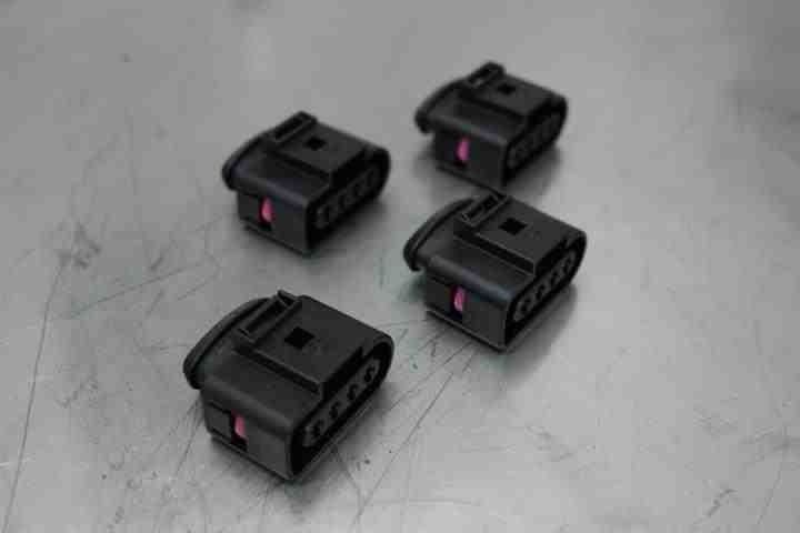

New coils plugs and loom,

Im guessing its part of the manual conversion. However He is sure going to have fun getting that metal engine mount bracket in ;)
Slots straight back in with the manual tensoner fitted :p
Whole other story with the hydraulic tensioner.
Its almost finished now. All the parts are in now ready to get it running next week.
I know about the hydraulic tensioner being different, Just be careful it doesn't add more tension to the belt once the idler roller is fitted.
I know my I.E one does.
Good luck with the run up, hopefully everything goes nice and smooth :thumbup:
