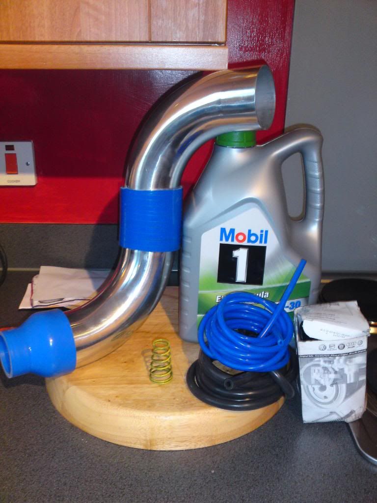

An Old Picture of some Bits that turned up last week..

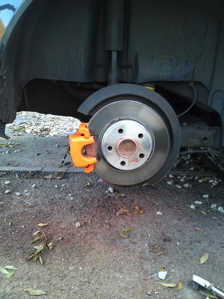

Also Did the rear calipers to match the front..

Finally got Round to Precisely Fitting the Ports Needed for the Leon And i needed to work out were they Needed to be as i didnt want any Ports Specialy the 25mm DV port Near the Maf....
Plus Im gonna Keep the Silicone Coupler In the Middle Due to me wanting to Move the Battery in to the Boot Over Christmas...So when i do i can simply Loose it and Change the degree To fit a Bigger Filter...
Anyway Its all Done bar the welding Up Which il be getting Done Next week if i get time...Its Turned Out Rather Nice..
