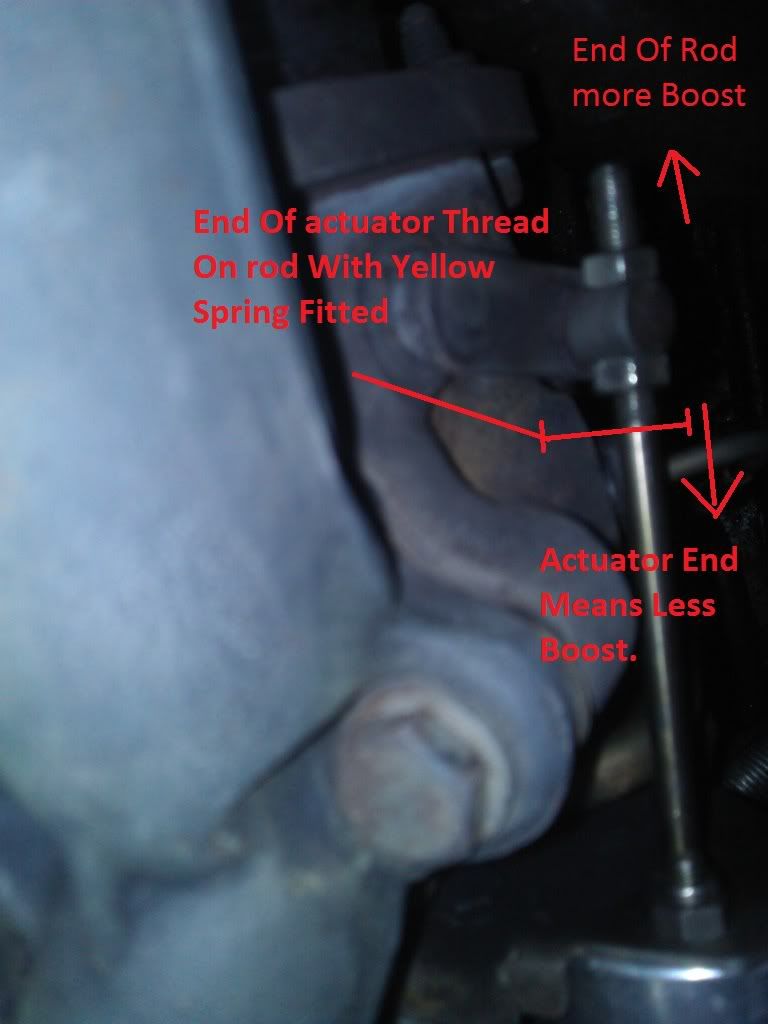

Were could I get that push from bill?I havnt manged to get in touch with forge yet either.i refitted the actuator with my yellow spring but I drill the bung put to make the rod sit straight and secure.lucky enough it has worked.but the purpose of me doing this is so I can still drive the car.so when setting the wategate you push it in so its closed then give it a few turns?
Still Adjusting the yellow spring at the moment as its still Peaking too high..
I took a Picturs earlier of were it is and have i got this right.Im Guessing theres gonna be a sweet spot for this?

So im going to Undo the actuator and start again by taking up the slack with 2-3 turns then fit the mbc and set that @ 24psi....

So should I do what Alex suggest bill wind actautor out then give it a 2-3mm tension turn then fit the mbc to 24psi....or leave it were it is 9-10psi pressure and fit mbc to 24psi...il get the unos.mbc when I get paid..

I thought the tension wasn't enought or it was sticking but bother are fine,I took it off and reset it all with 2-3mm Pre load tension,so with the N75 unplugged went to 10-12psi on the gauge...
Then i tested with the n75 plugged in,It instantly went to 27psi + But soon as it did the car went in to a Lumpy peice of ****...(Bit like a Coilpack had gone) I then pulled over and turned the car off then restarted it and it was fine..
