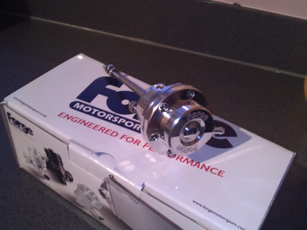

Big thanks to forge my New actuator Arrived yesterday...Looks to be a totally different setup( Less Gaskets) that is installed..
Anyway finally got round to installing it tonight which took around 10minutes just a shame the bracket is the hardest part to fit lol...

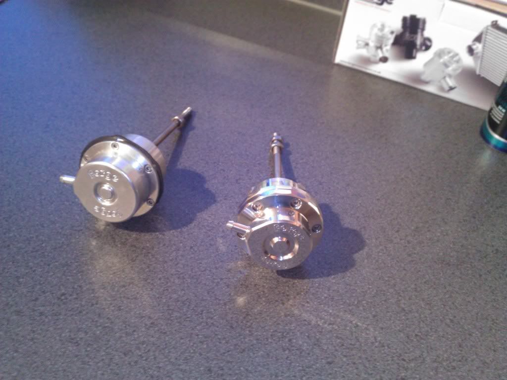

anyway New & Old One...My Old one is perfectly fine all it needs it Blue plastic Seal,Actuator Bracket And 3x nuts....Also got a spare yellow & Green spring..
Ive adjusted it tonight and only managed one complete little drive to oldham and back around 30 miles or so...
Boost comes in Extremely hard low low down and spool is 100% louder too but only managed to take it too 20psi...Ive checked the static pressure and its sitting @ 12psi which to me is a little bit high...So will turn it down to 10psi if i can....9psi Would be Great too...
