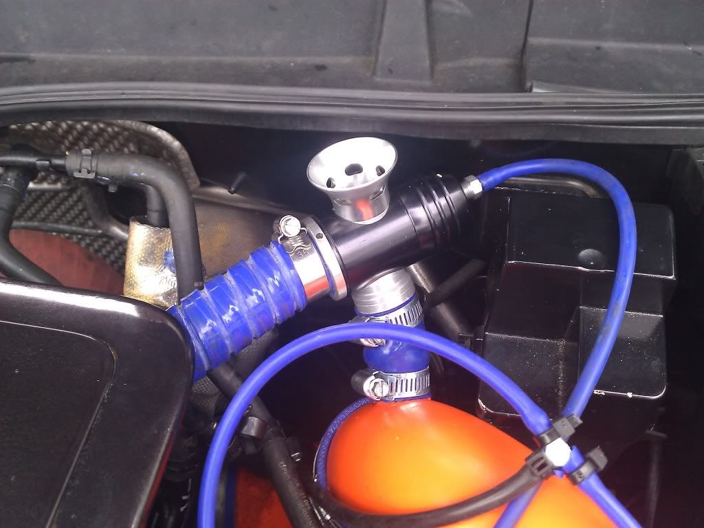

I Just finished under the bonnet off the car sorting out the wirings,cables ties,vac piping and charge hoses....
They had been abit of a mess since me doing work under the hood so i double checked and inspected all the hoses and jubliee clipped & Cabled tied the vac pipes....

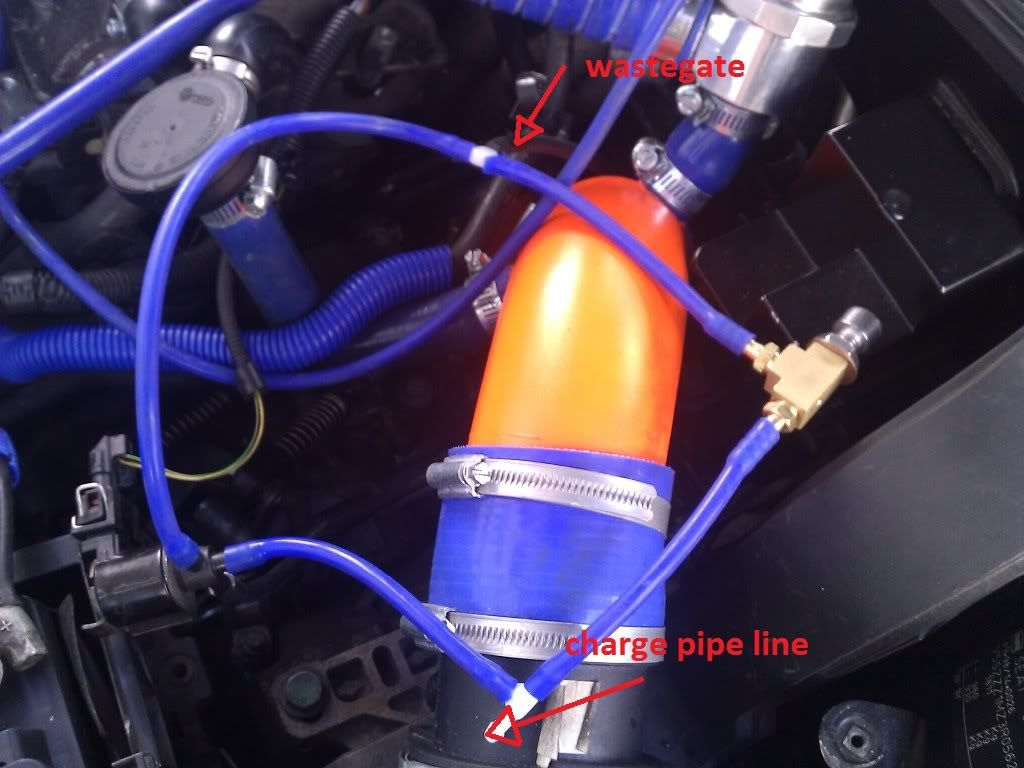

Also Had a split PCV hoses under the inlet which i bodged to secure a new one from seat on monday...with chatting the bill & others ive put the n75 in parrell ( i think) with the MBC so the n75 can control part Throttle Because at 70mph @ just under 3,000rpm its spooling its tits off @ part throttle and alot of surging...
Anyway i think ive done this correctly with the n75 and mbc in together...i havent drove it yet but will do it soon have i done this soon...
hows it looks all the t-pieces look fine? correctly done?

I Tested how ive got the hoses and adjusted the mbc to suit @24psi...now it currently hits 24psi @ just under 3,500rpm then it holds 21psi and as the rev increase the guage needle moves to 20 the 23 then 20 then 23 then 20 and then as the revs go near the back end of 6,000rpm the guage is saying 16-17psi....
But it defo feels quick as the power "Doesnt" tail off it stays there at 5,500rpm which you can still feel in your chest...Also 2nd gear in WOT is saying 21psi peak which is correct for the selected gear is it not?

I desided to re-fit my GFB 50.50 hybrid which my mate ash has had i havent had this on my remapped lcr at all..so wanted to see what it sounds like at 24psi...
Yeah Id have to agree the MBC cost me £20 posted but i can see why know...Its working well with the n75 now as im guessing the n75 has took over the main objective of controlling the boost...
best of all no 6th gear surging...My gosh that was horrible...
