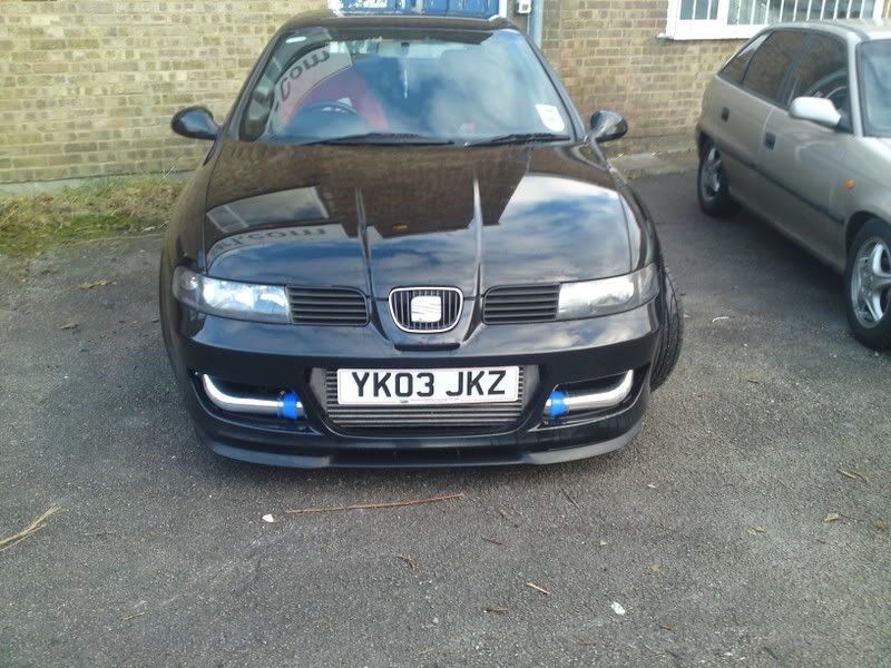

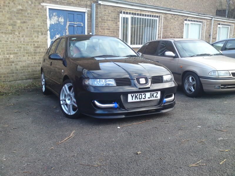

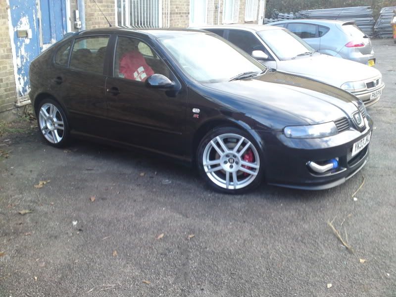

I noticed a slight increase of boost, peaked higher and now holds an extra psi. It does feel slightly quicker bit it couls be all in my head.
Pipework might not be to everyone's taste, i'm going to ahve another go and fit my fog light grills. I have had to cut the fog light and i'm going to fit a smaller number plate.
