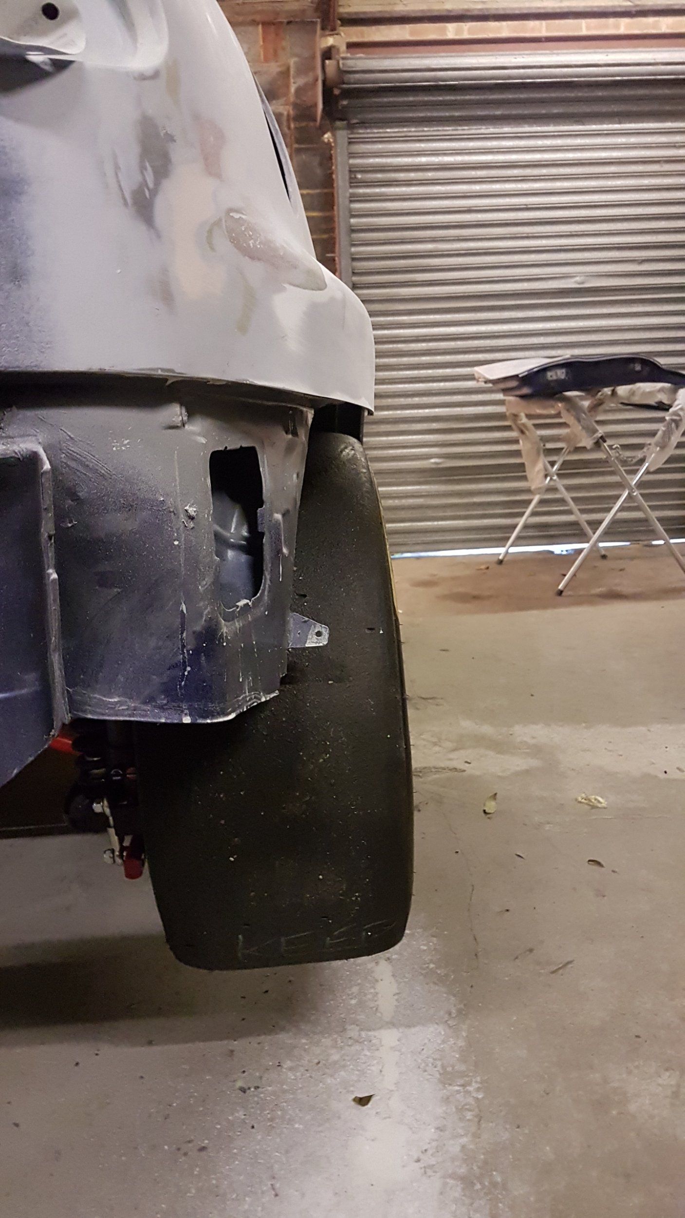

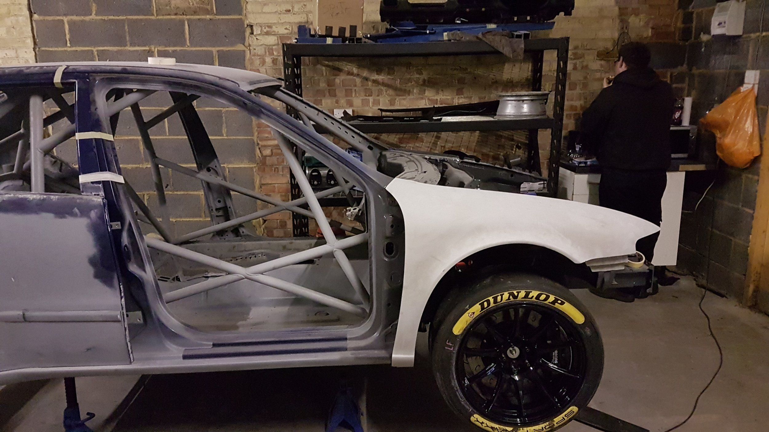

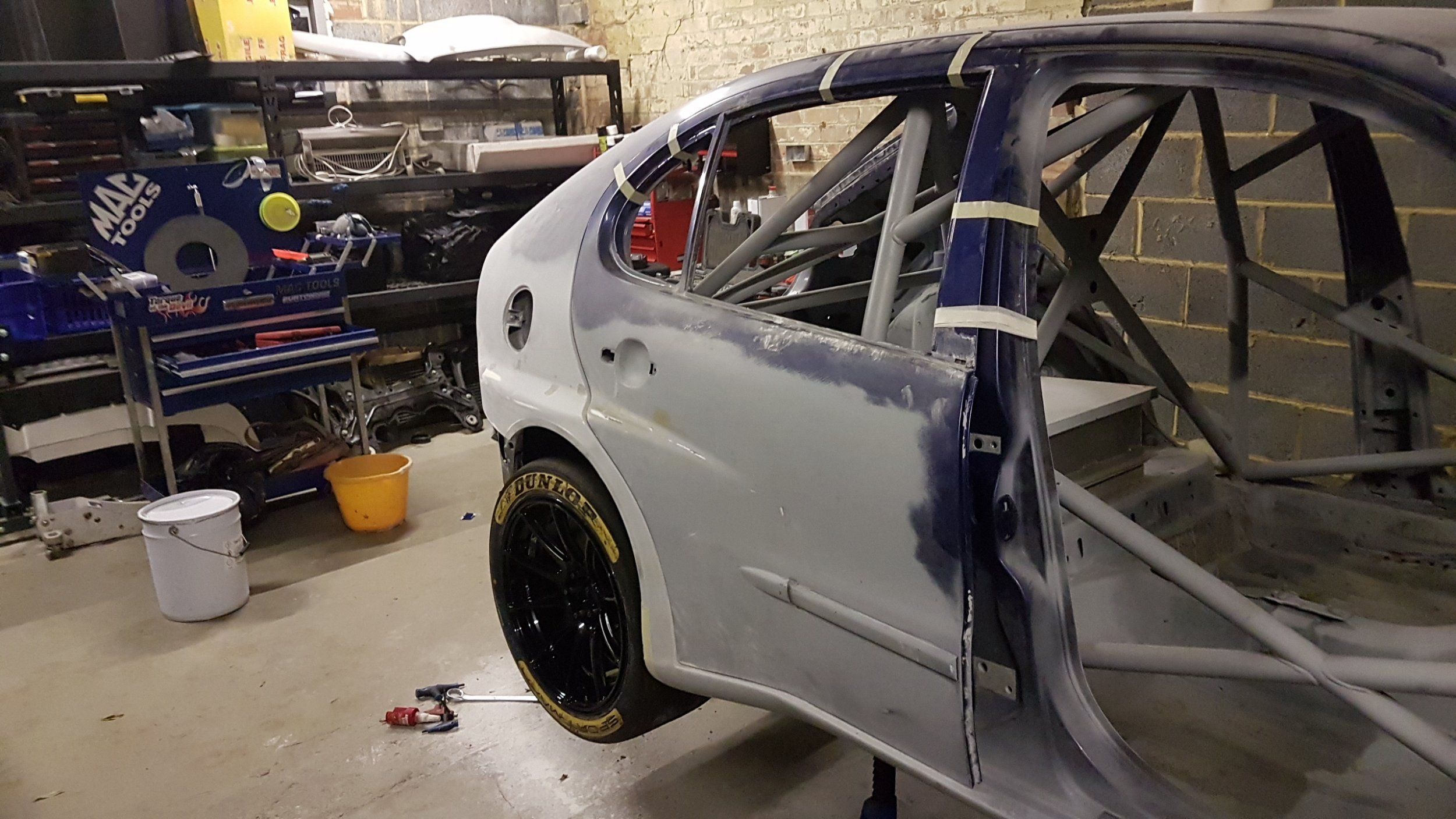

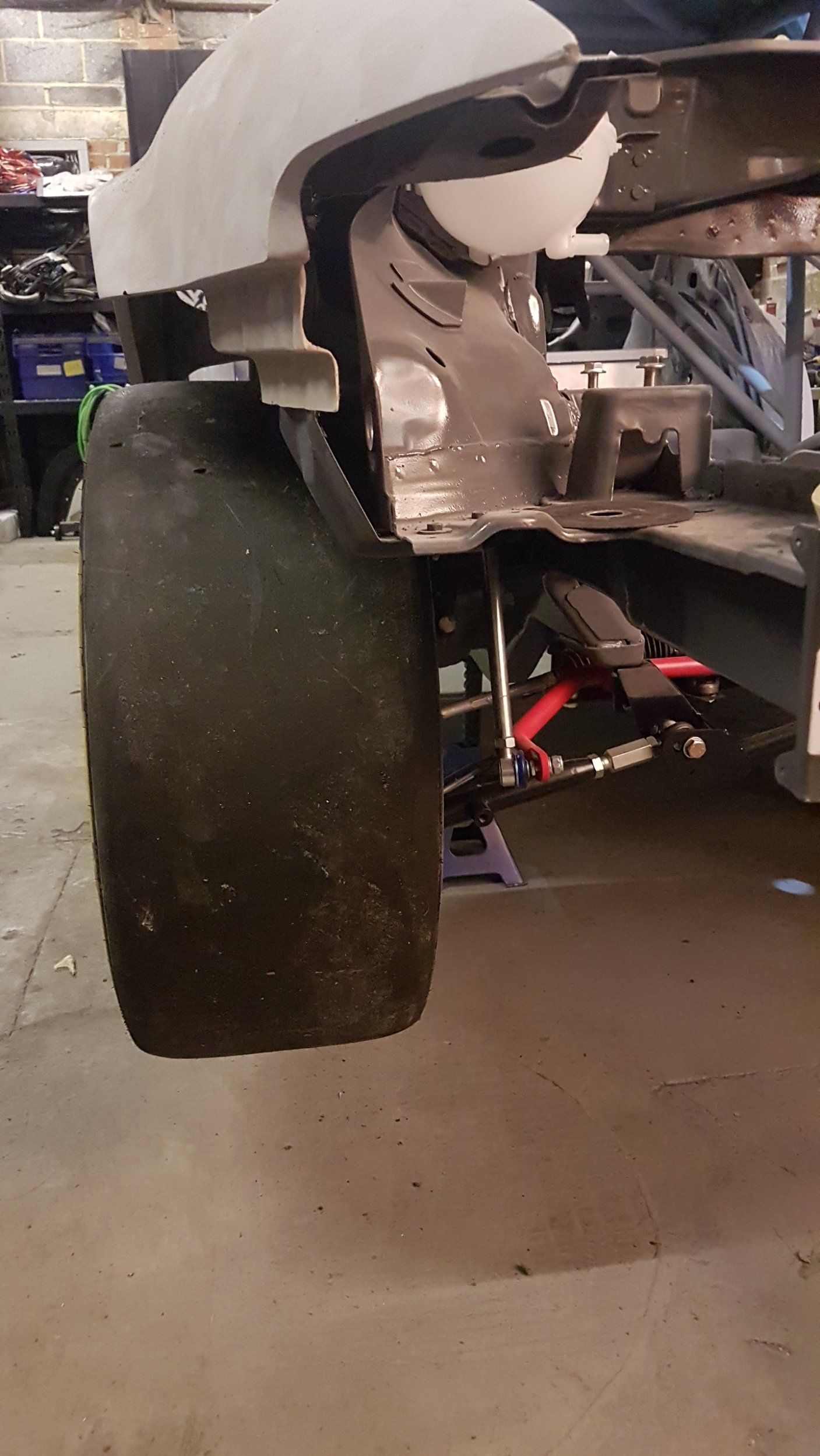

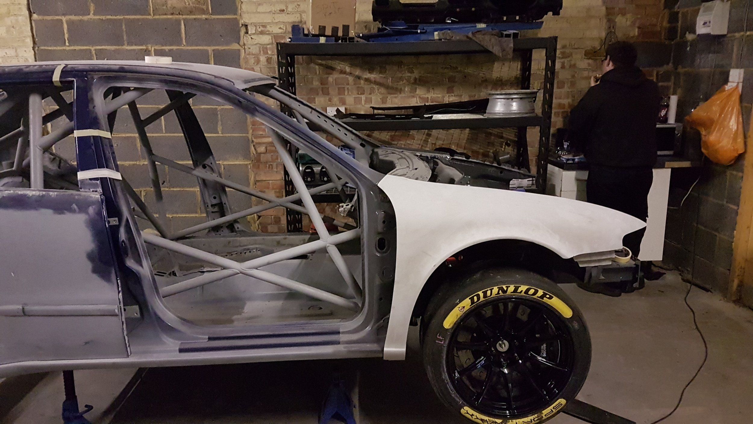

Not a lot done tonight... bit of fibreglass and filler in the near side rear arch.. and then started lightning the front panel. Cut off the braces I don't need View attachment 19277 View attachment 19278

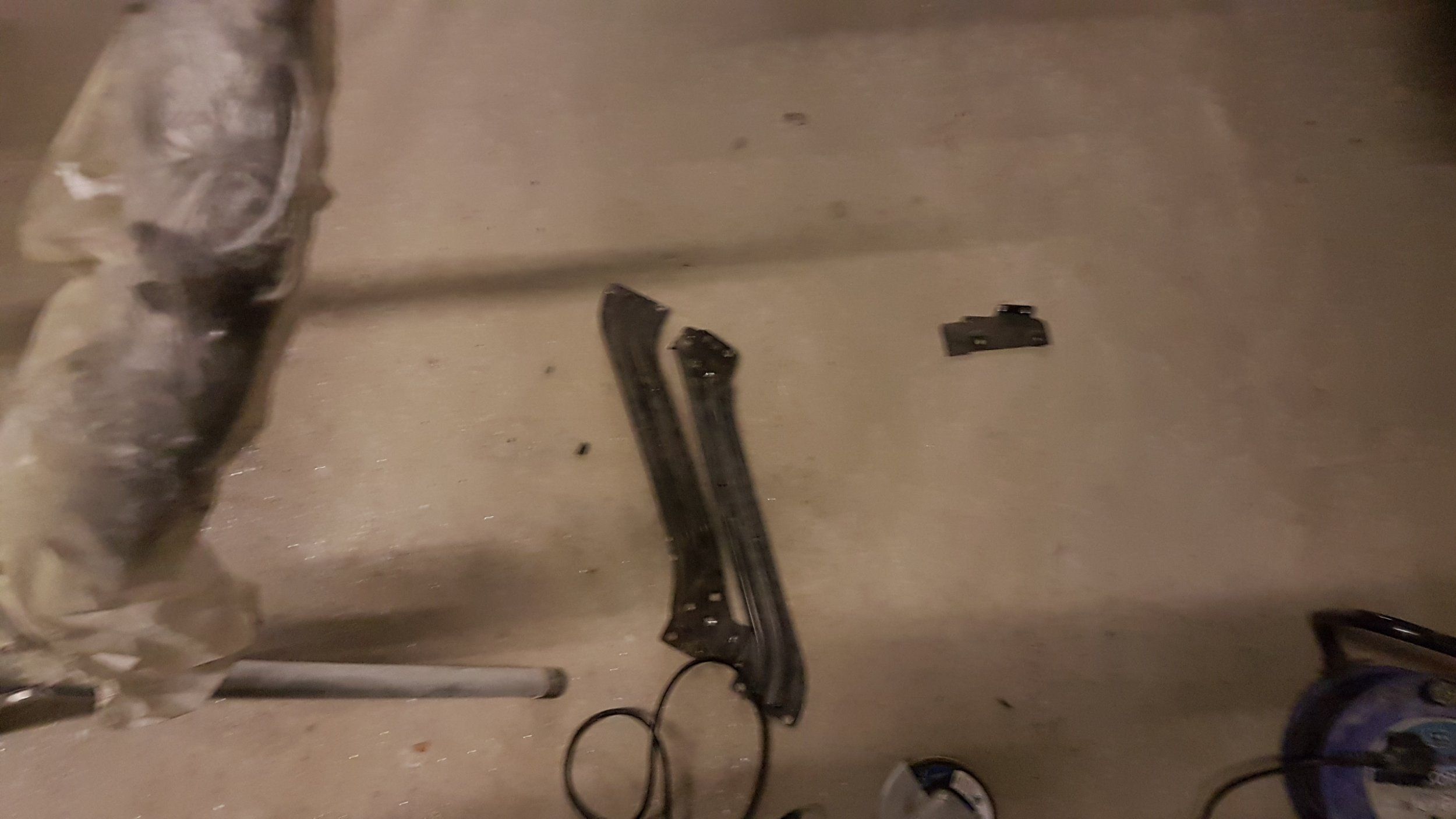

Right... quick 30 mins lunch time project...

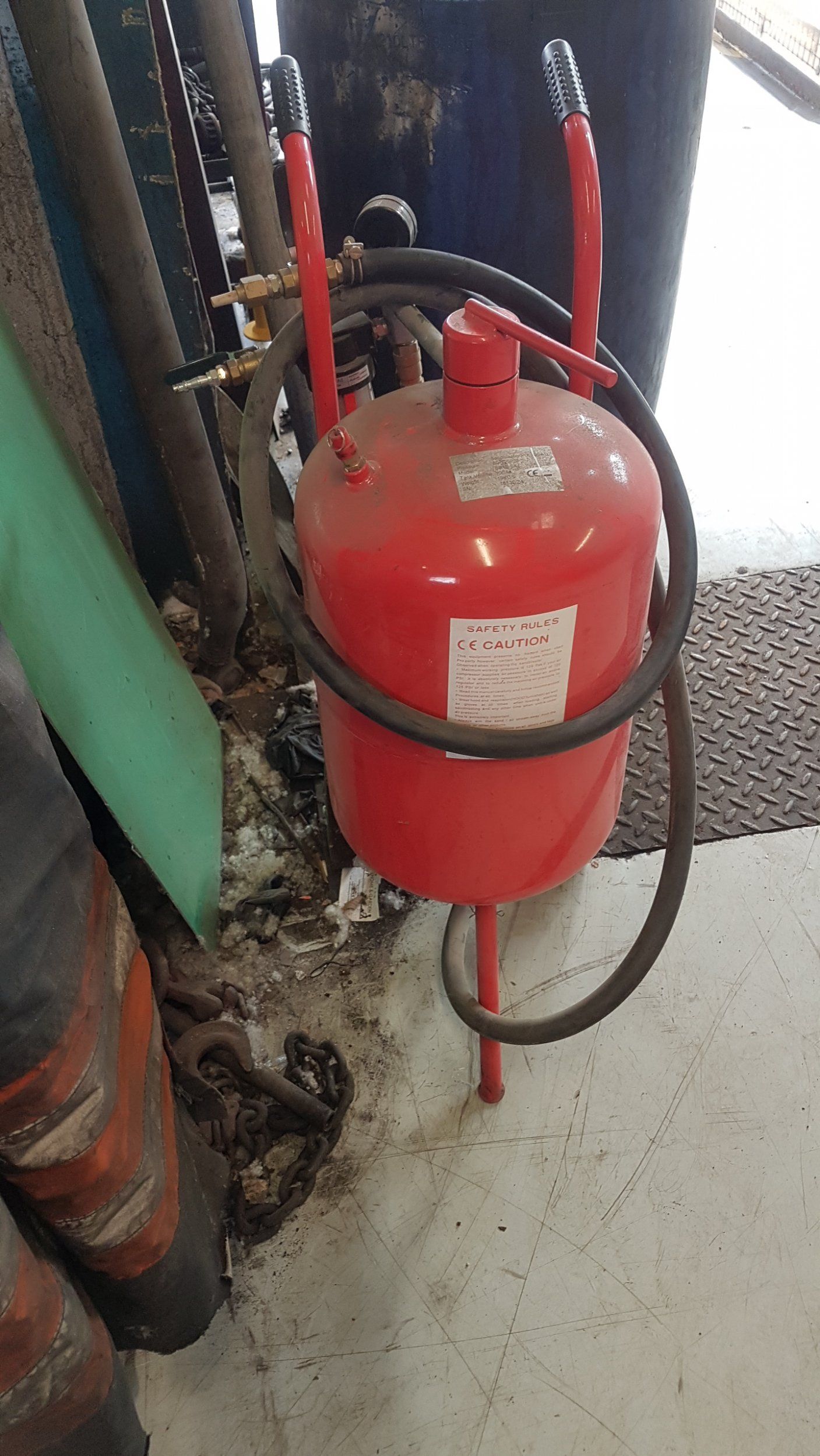

Take some scabby and flaky paint calipers and then wheel out my sand blaster ( I would do this at my workshop but my compressor isn't big enough.. So leave it at work poked round the corner..
It took less than 5 mins a caliper ... wearing a balaclava and ski goggles... sand every where but I now have good looking clean caliper
After work I am going to give them a quick spray with primer and then tomorrow some heat resistant paint .

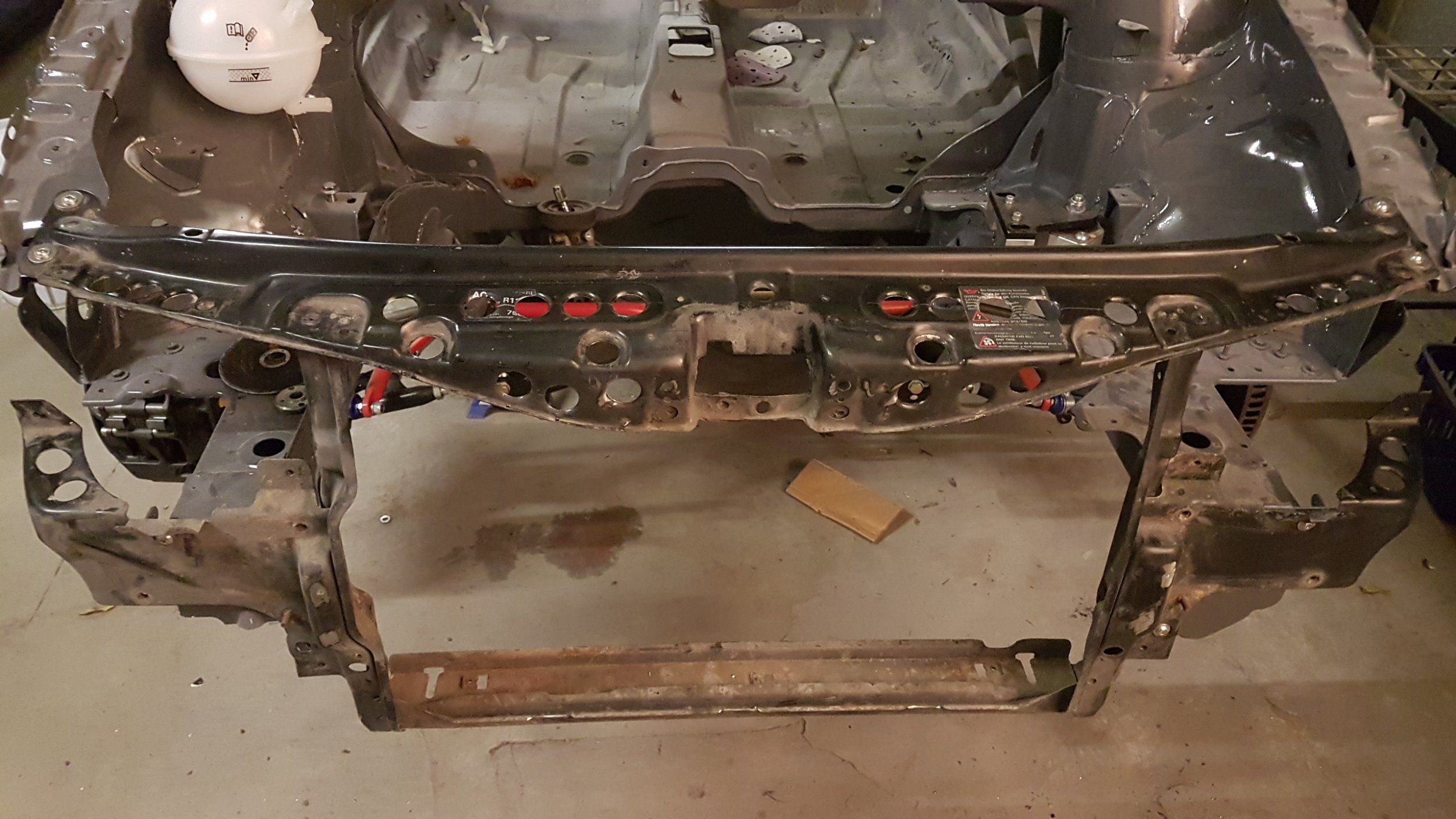

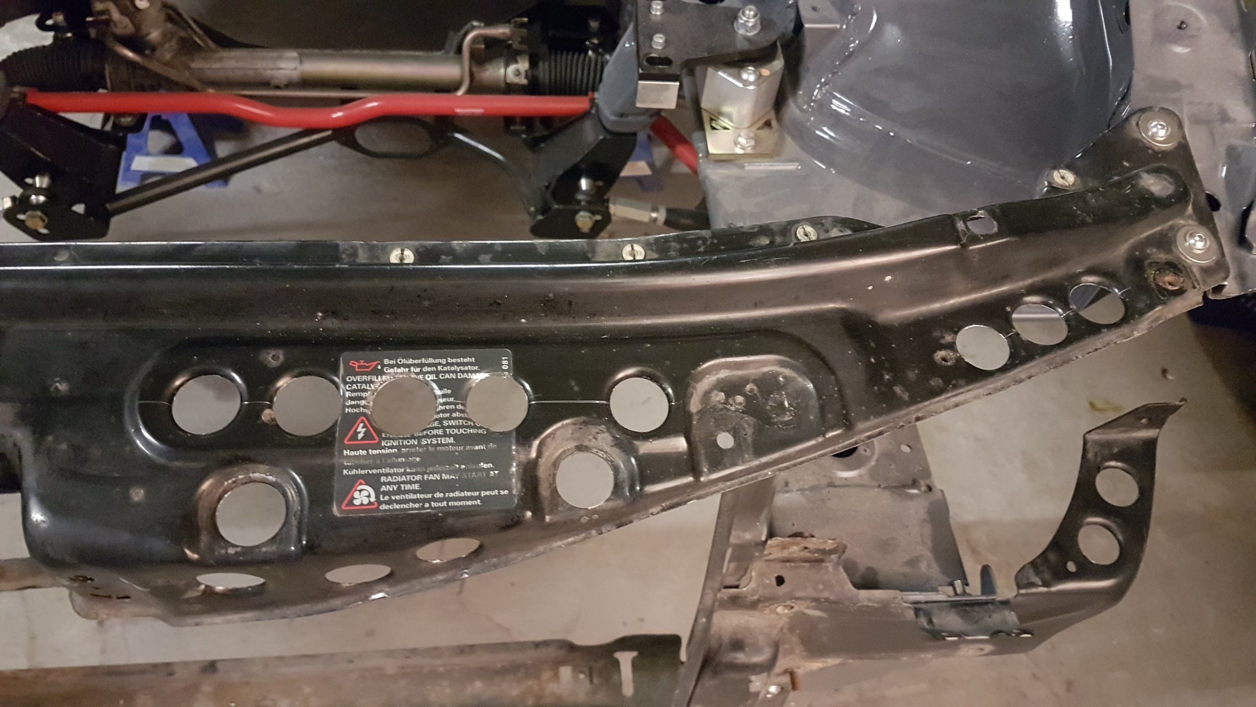

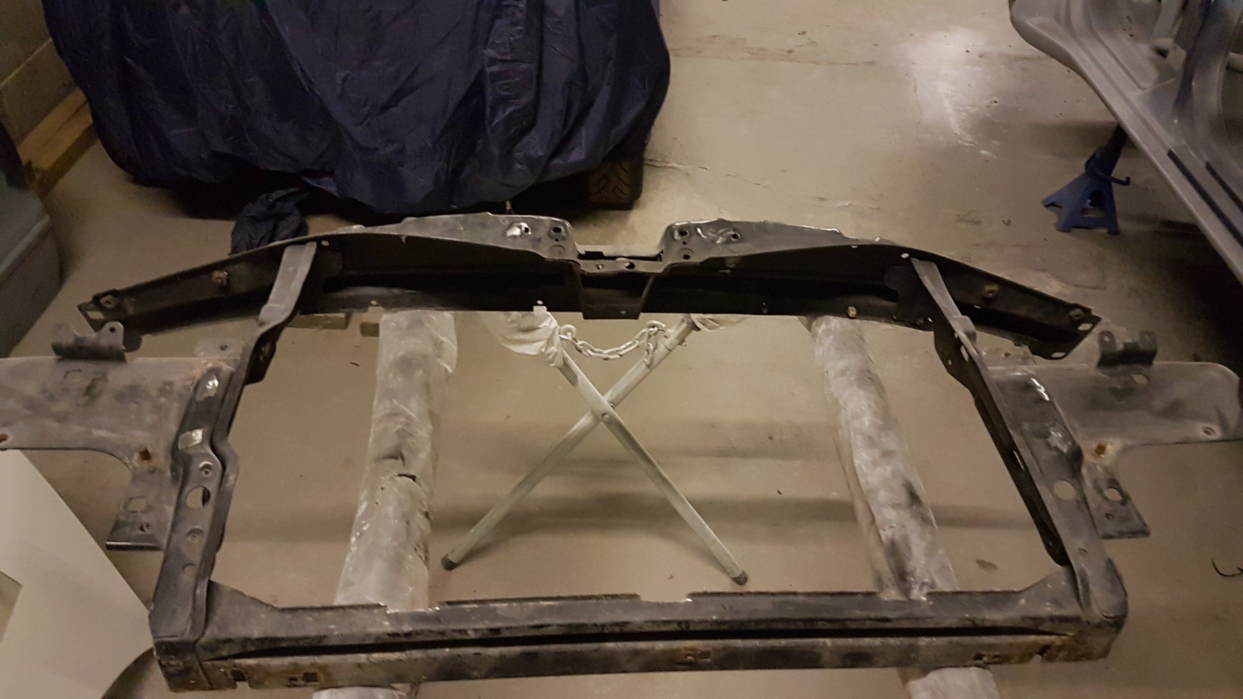

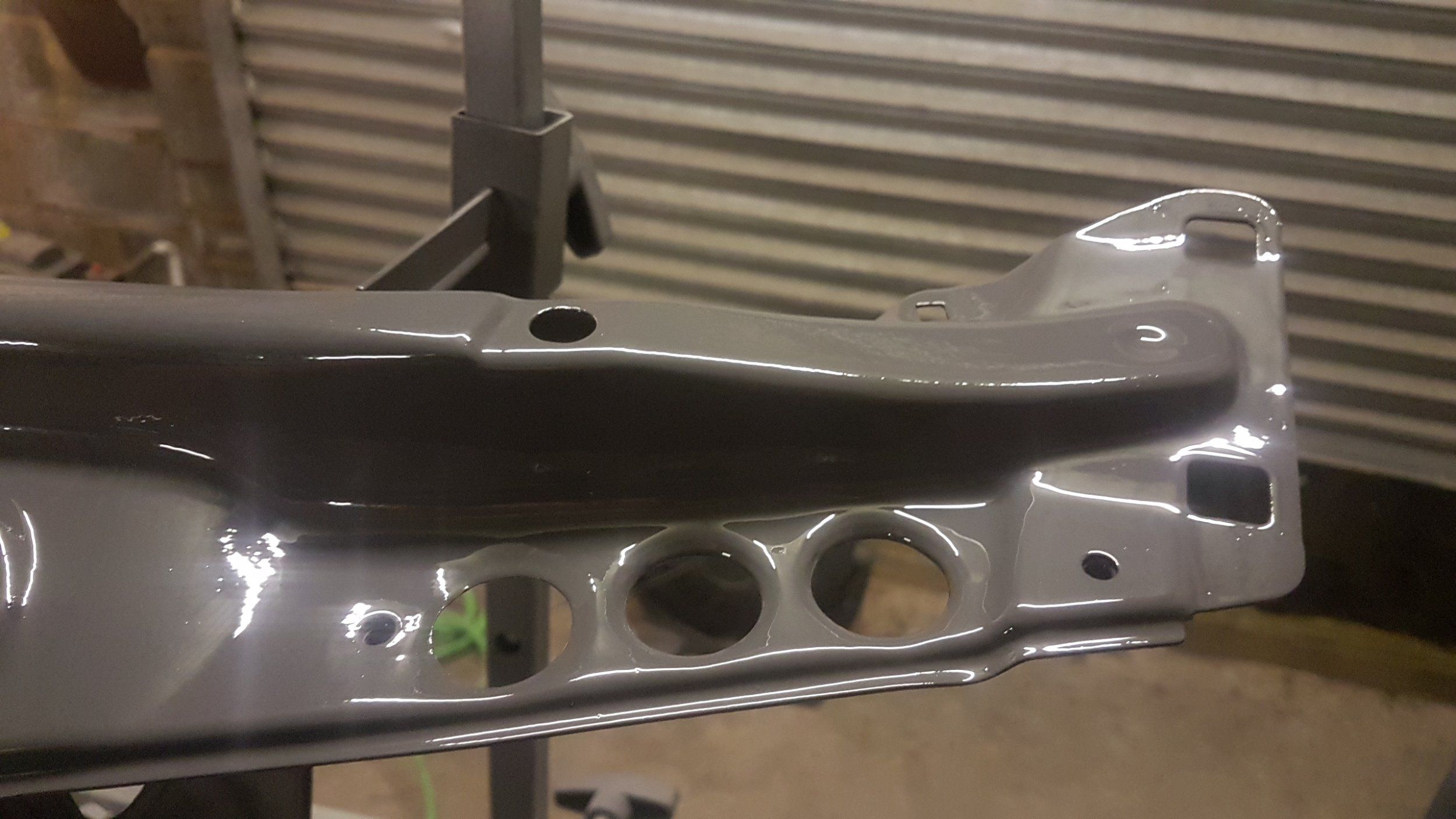

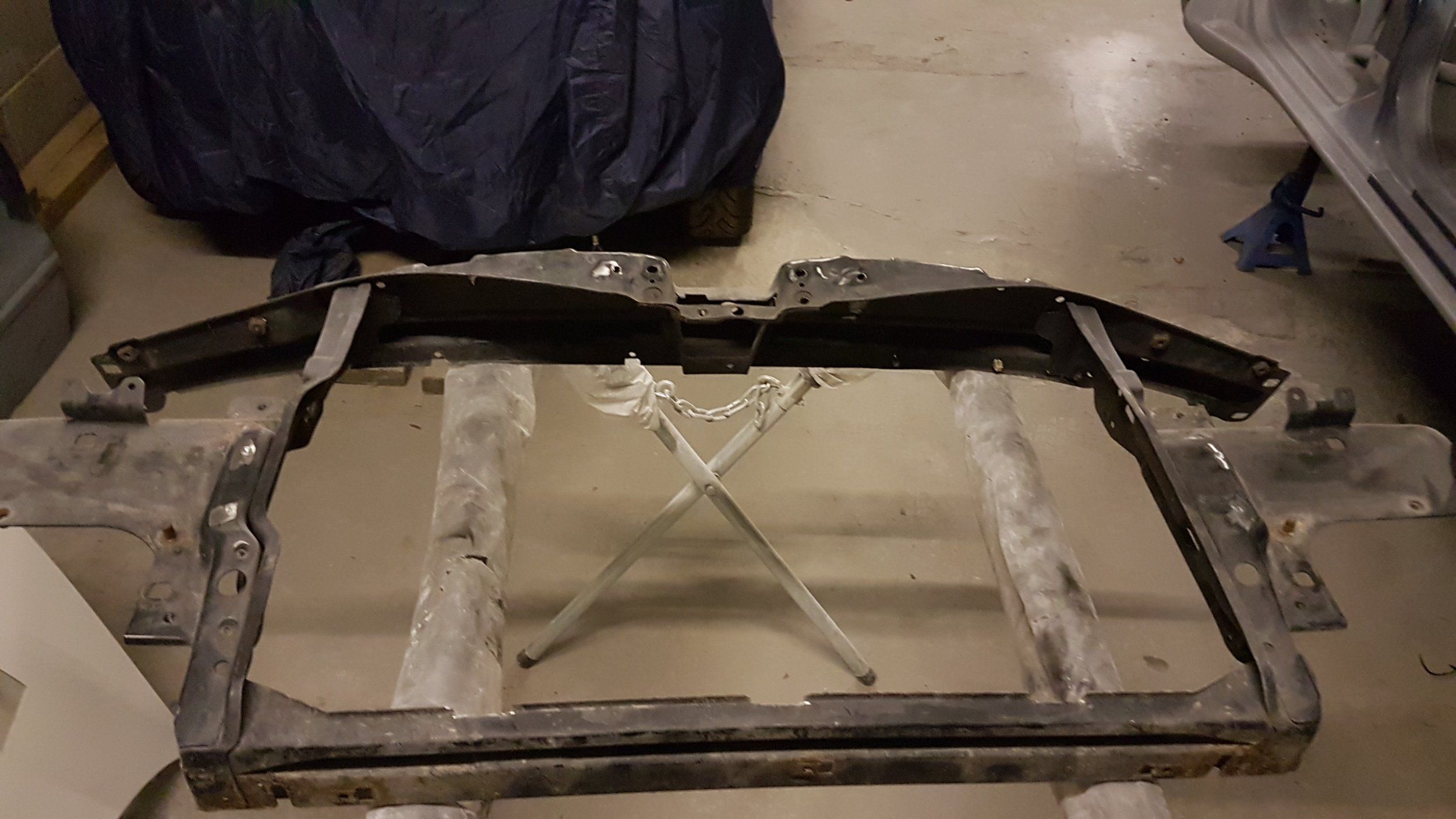

Not a lot done this week really ... stupidly busy at work doing 14 hour days so no time in the evening . But got to the workshop today. My boy was still sanding and scotchbriting the rear door ready for paint. Put the car back on axle stands and took all the panels off again..
Then started to lighten the front panel. Cutting holes then sumping them for a bit of strength and style
Will take it to work and then sand blast it . Also got all the door hinges off so they now can be cleaned up and blasted too to get all the paint off . Gives me some thing to do at lunch times..

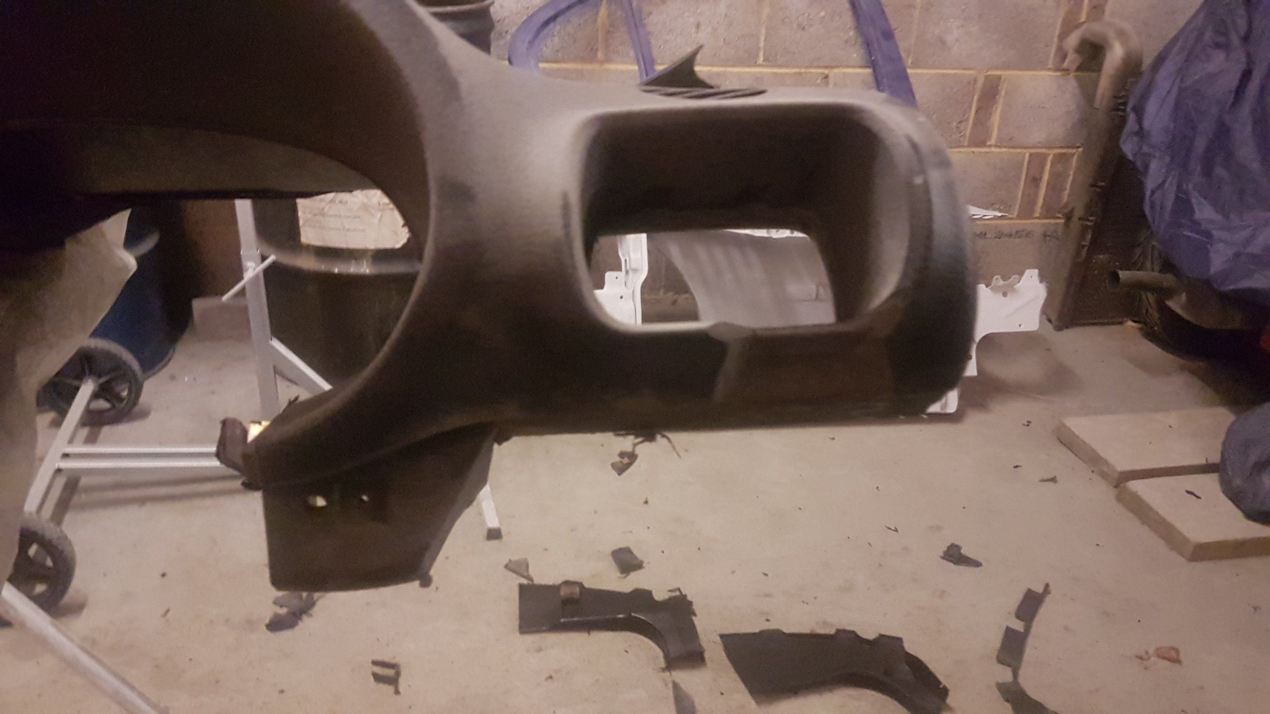

Right done near on bugger all apart from working. But I have primered the front panel and now just sanding it.. also now cutting down the dash to fit round the roll cage

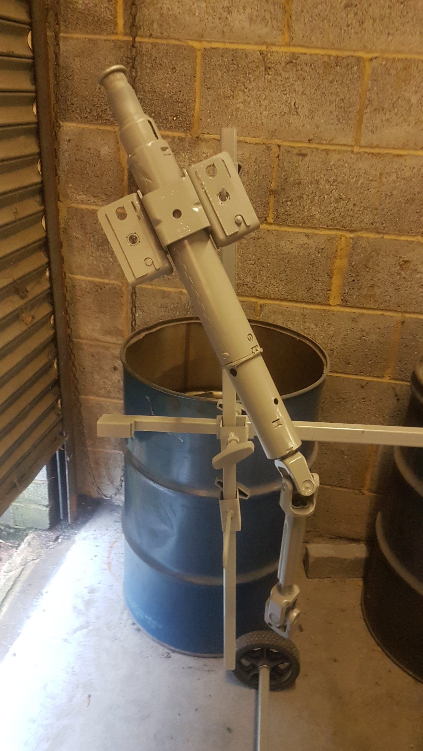

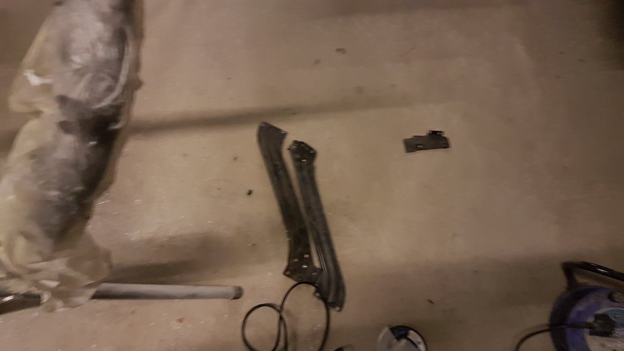

Also cut down and stripped the steering column of all bits that arnt needed....
Just primered and sprayed it black so it not go rusty.

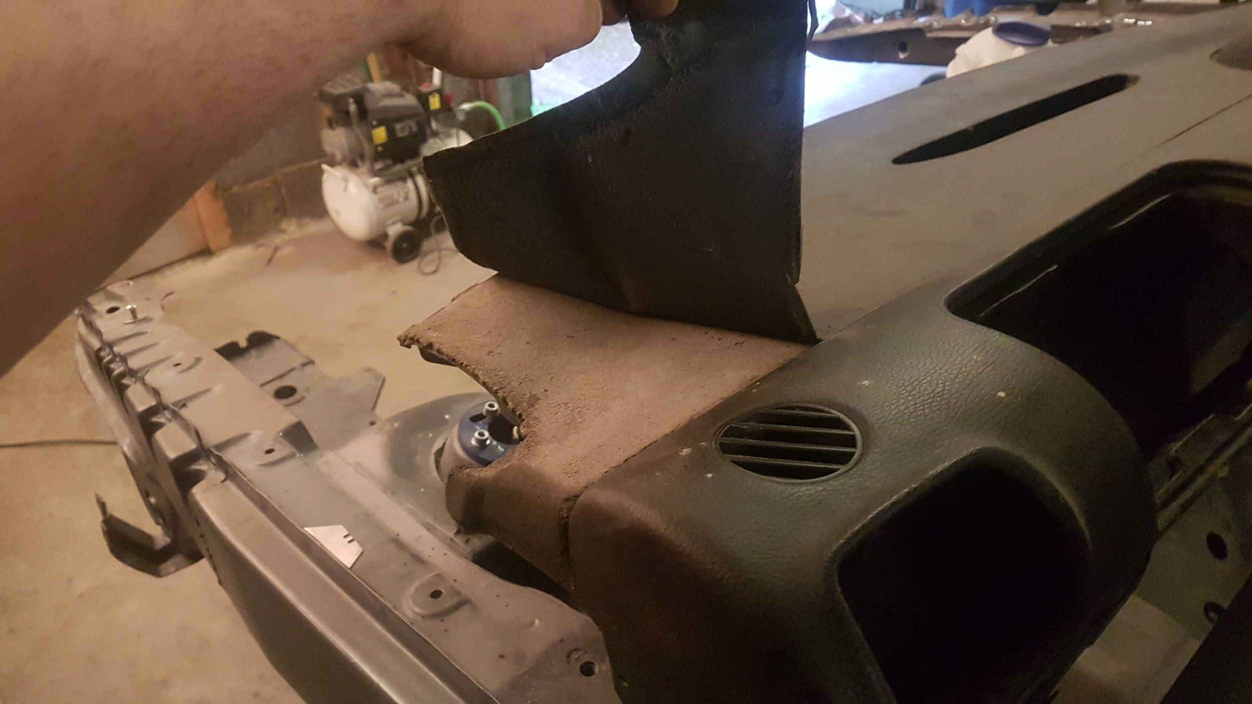

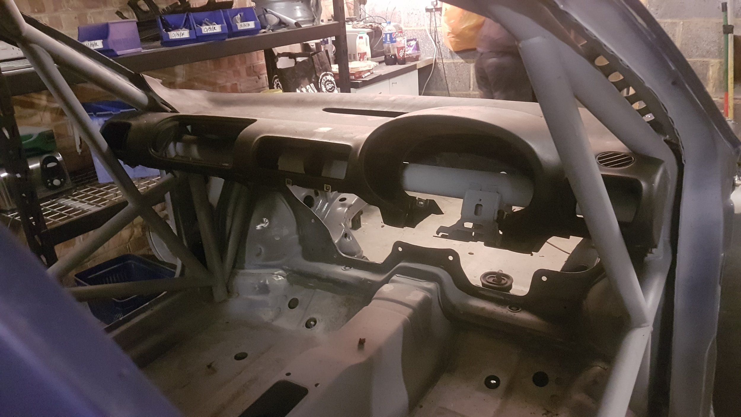

Here we go... first fitment.... and cutting
Bit of cutting and grinding
And it's in
Drilled threw the dash and in to the bulkhead then fitted some nutserts to hold the dash. Will go on eBay and get some black washers and bolts so they don't stand out

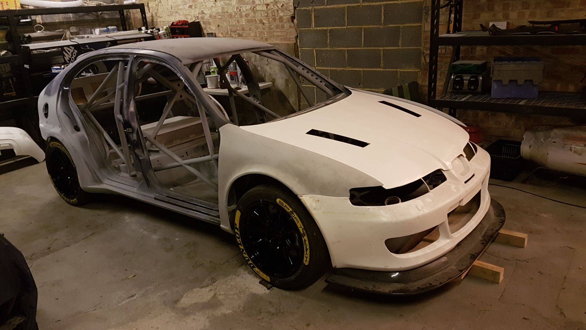

Also painted the front panel.. I do need to slow down on painting and learn to do it properly
But it has a shine to it... hopefully it will still be there tomorrow and the temp don't drop to much tonight
