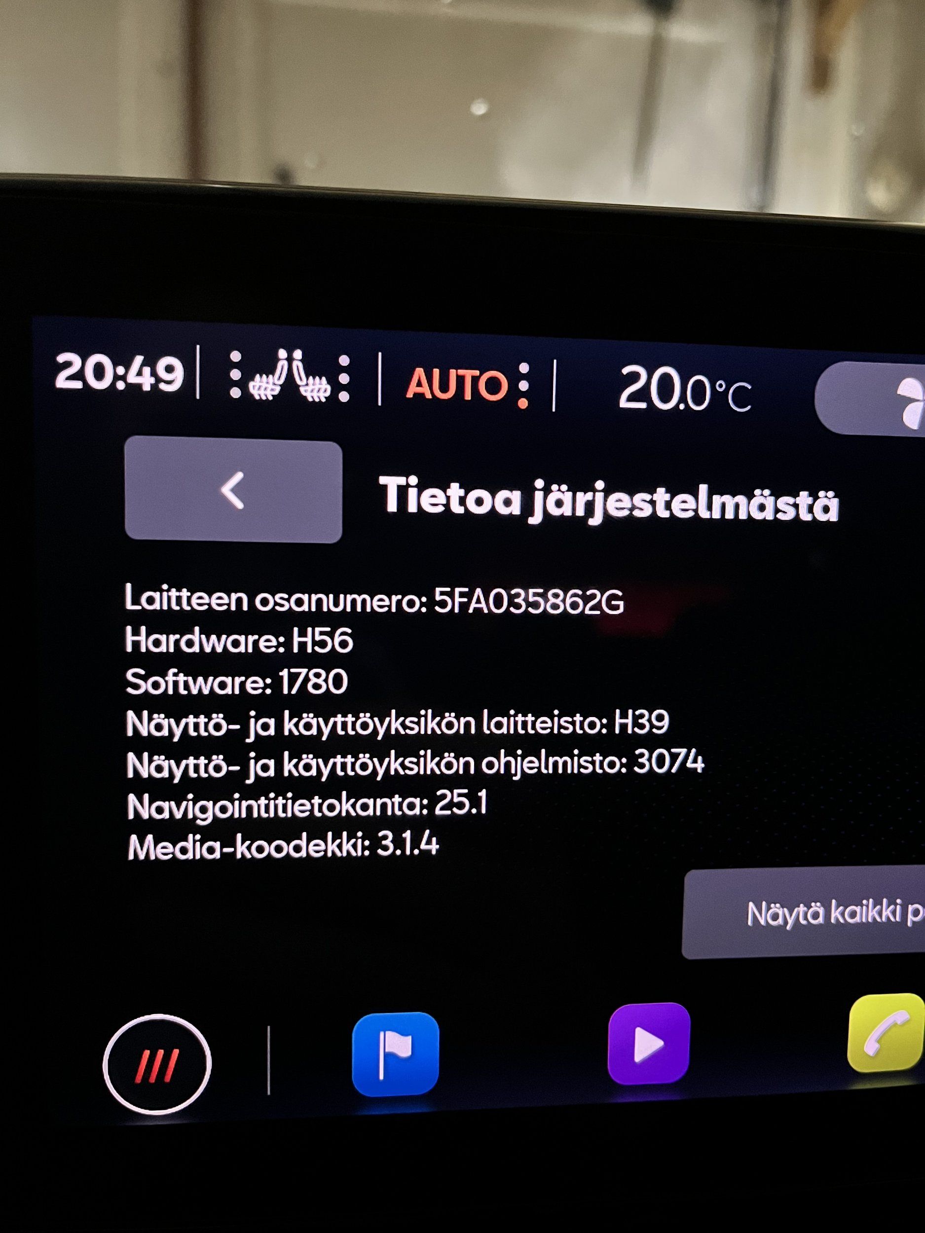

Just got a new (to me) Leon eHybrid myself. It has an 1780 version.
Are these files linked suitable for me to safely update my infotainment to the newest version? Firs 1899 then 1969?
Car is still under warranty (5 years here), but the local dealer told me they are not willing to update (for free that is) if there is no faults in the system as it is.
So i am a bit scared to do it myself.
Download those files to USB-C stick (one at a time that is), stick it in the car, push menu button for couple of seconds for the engineering menu, choose update and cross my hands?

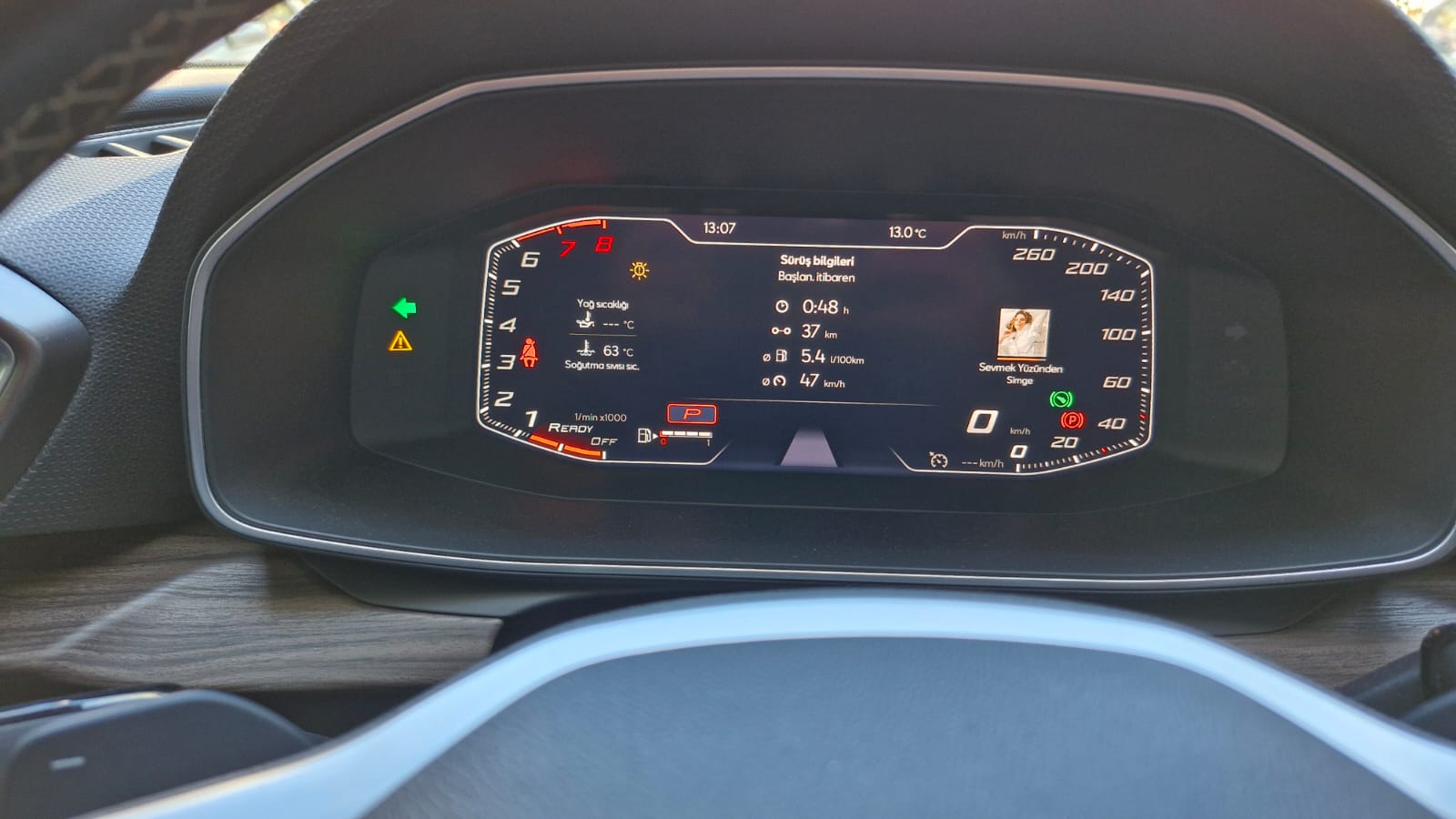

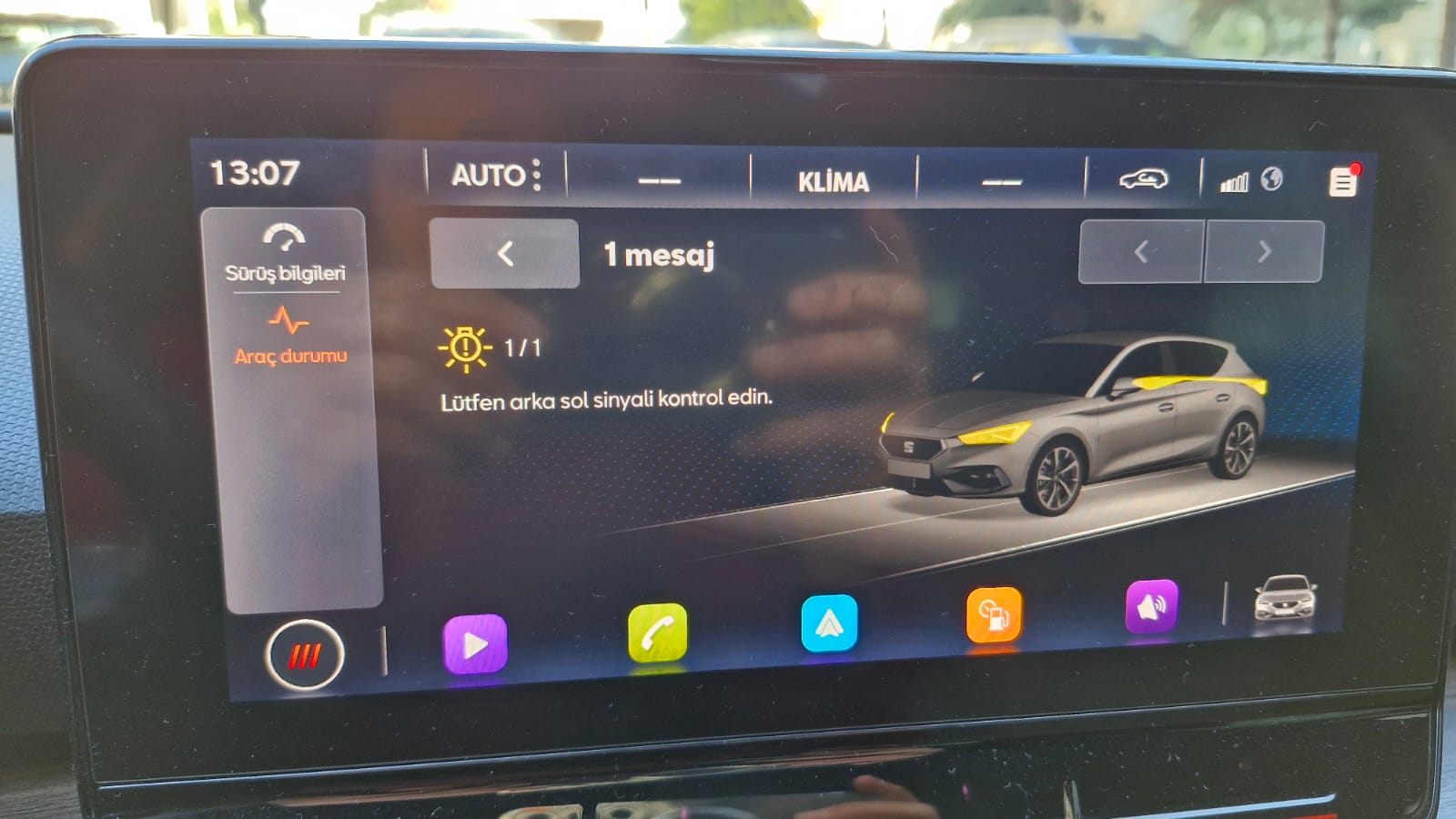

Hello, after the update, the left turn signal tail light indicator started working. It starts beating rapidly 5-6 clicks after the signal is given. There was a problem with the tailgate signal to the taillights. It is updated whether there is any information about the update. Could reinstalling the same update solve the problem? Anyone have any ideas?
Nothing to do with updating your infotainment. Likely you have a water inside the lights or the LED element is damage or corroded connector or light is faulty.

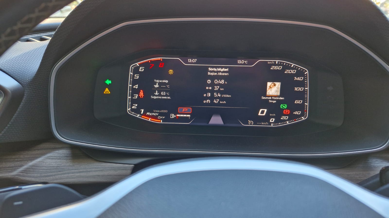

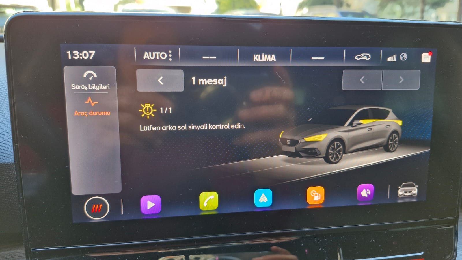

View attachment 46613View attachment 46614
Once in a while it happened to me, but as soon as I exited the car, lock and unlock and start again it would go away.
You keep all the time with that error, never goes away ?
When I turn the ignition off and on, the error goes away. It usually crashes after 4-5 clicks after giving the signal. I will leave the vehicle to the service when I have time. Let's see what the result will be.
