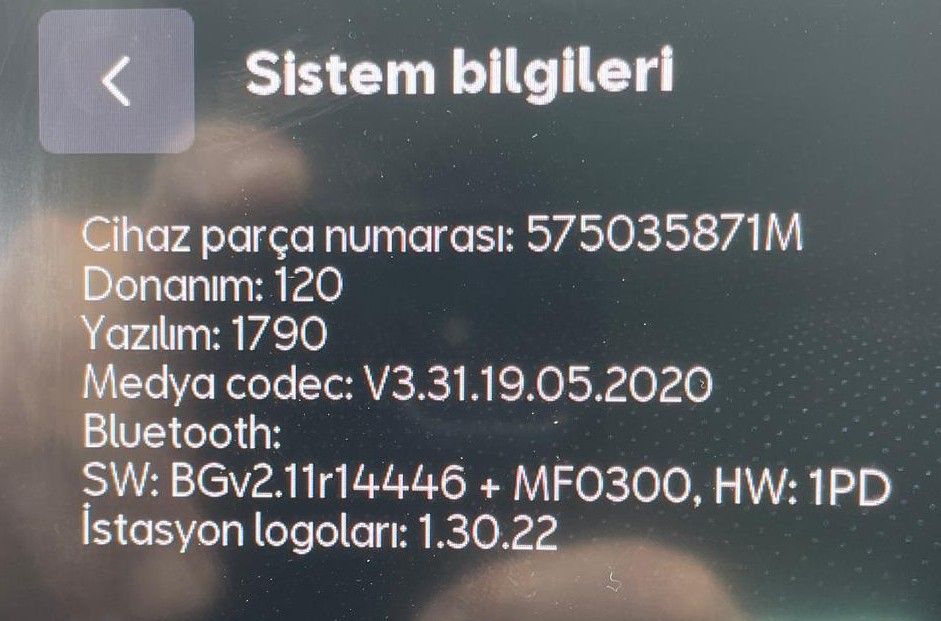

Hello, I just joined you. My name is Tolga and I am writing from Türkiye. I have a 2021 Seat Leon 1.0 TSI style package vehicle. I want to update this multimedia screen but I don't know how to find the files and how to do it. Is there anyone who can help me? Thank you in advance.

This is an international english speaking forum.
Everyone could probably answer your questions if you try again.

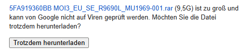

The latest released version for MIB3 in Leon system is 1969.
I would advise you to first update to 1899 and from there to 1969.
Everything can be risky if you are unlucky, personally did 3 updates on this unit (while driving - don't do that) without any issues.
Regarding OTA, yes, if there will be ever be another OTA update coming you'll receive it.
Relevant documentation can be found in this post:
