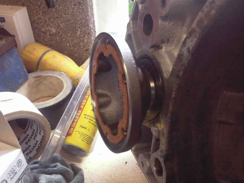

When I had it back there was a problem with the flanges (love that word). The thing is with a 02A box the flanges should be push in and held in by a circlip but the standard diff had threaded holes on it to bolt the flanges to it.
The Peloquin didn’t so the flanges could easily be pulled out, emailed Peloquin in the US of A and he rung me at 2am (our time) after I finished work at 10pm that night and was back in work at 6am so as you could guess I was in my own little world talking to him.
He told me that the only difference between the diff for the 02A (16v box) and 02J (20vT box) was that the 02A was push in and the 02J was bolt in but some how my 02A was bolt in. He managed to give me the part number for the push in flange that I needed so I ordered that one and waited a few days!
While I was waiting for the new flanges I painted the box silver and the bolts and “VW” badge black.

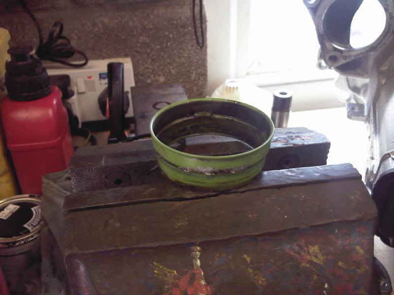

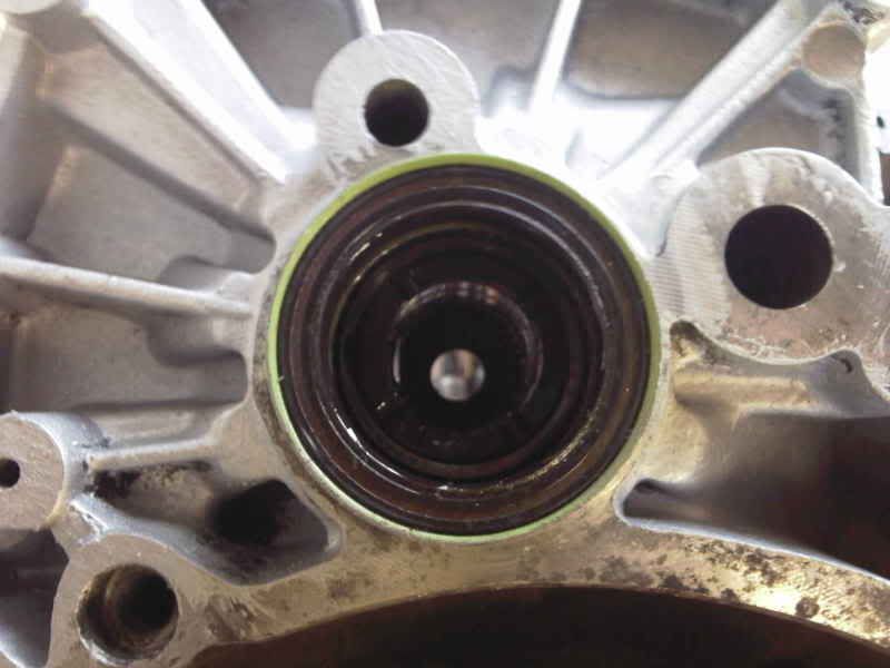

Once the flanges came I went to fit them and they wouldn’t fit correctly, there was a thinner lip on the flange that wouldn’t let it fit into the dust seal in the green housing. Spoke to a mate that was going to fit the diff originally but went on holidays when I wanted it did he told me that I had to remove he green housing.
You can see the green lip on the outside
Pulled it off
And fitted a new dust seal from a Mk2 Golf, which I also ordered when I had the flanges just in case.

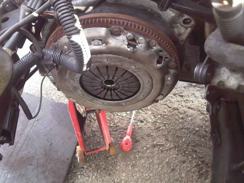

Fitted a new clutch once the box was off, use to have a Golf VR6 clutch when I had my engine work done but when I took the box off last year for the short final drive the thrust bearing went and I had a spare 16v clutch so refitted them.
But with the 16v clutch when I tried to park outside the missus house and a hill the clutch would smell badly, so decided to fit another VR6 clutch again.

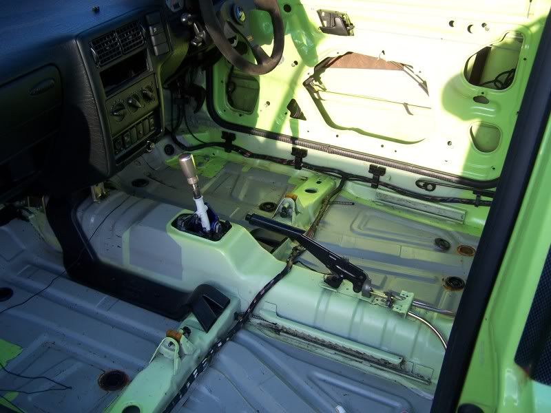

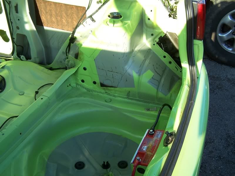

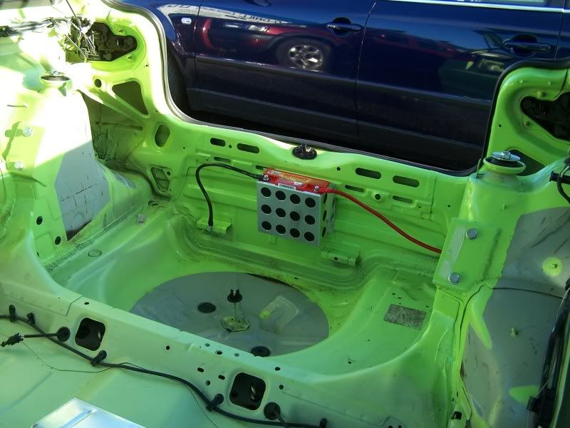

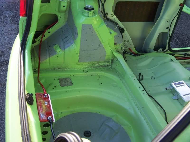

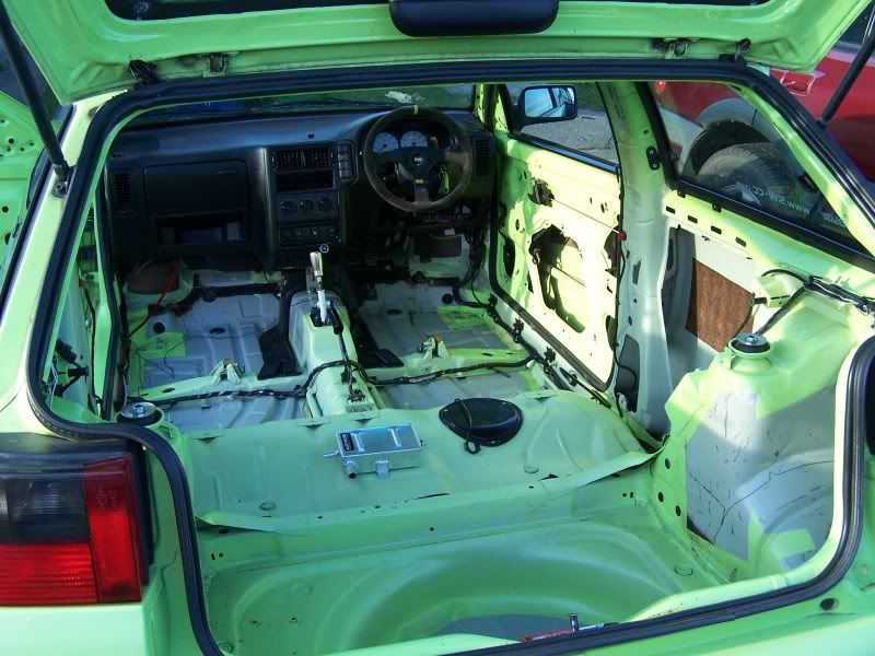

Put the snot on another weight loss programme! Removed all the sound deadening, not a job I would like to do again, also fitted a Odyssey PC680 battery, the battery holder will be done in Matt Black done.

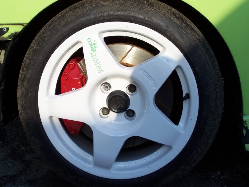

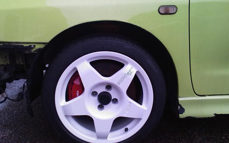

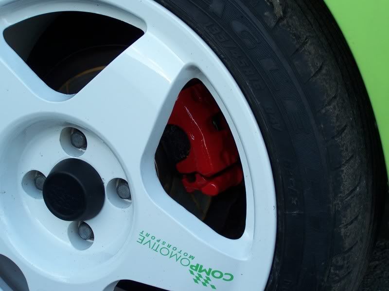

Went to change my brake pads and disc’s and found that one of the dust seals on the brembo’s wasn’t looking too good so had them refurbed and painted by Godspeed Brakes and then painted the rear callipers.
Fitted Ferodo DS2500 pads with grooved 305mm discs and Pagid Fast Road pads and grooved rear discs.

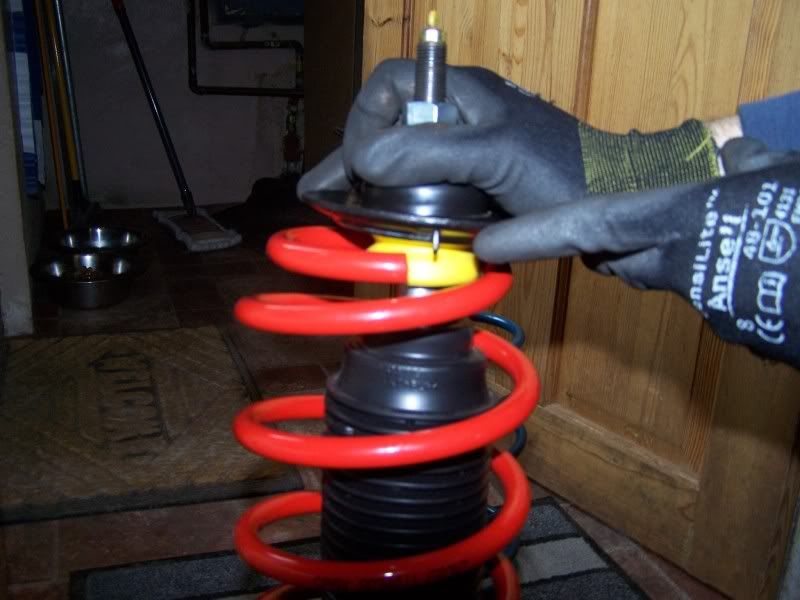

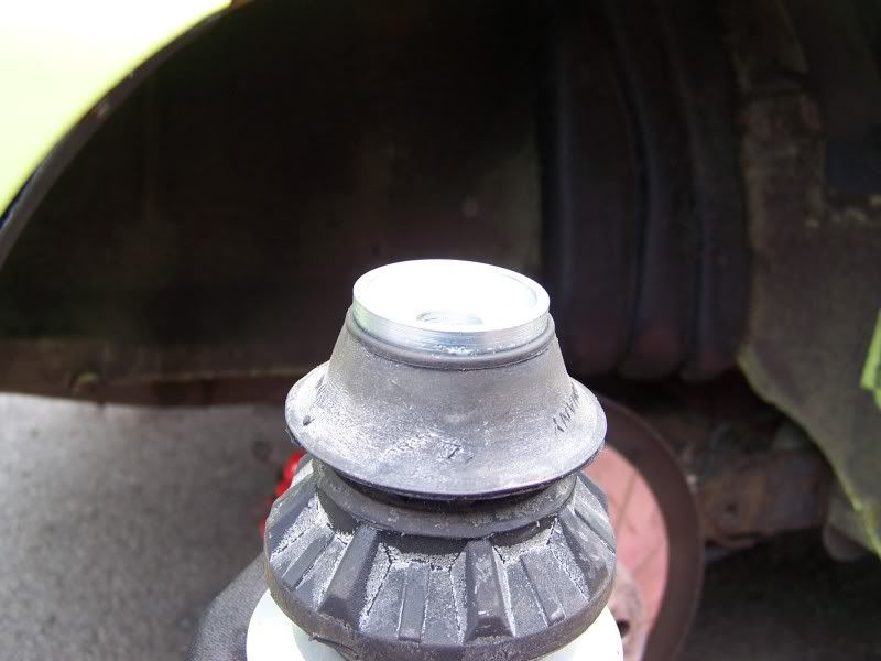

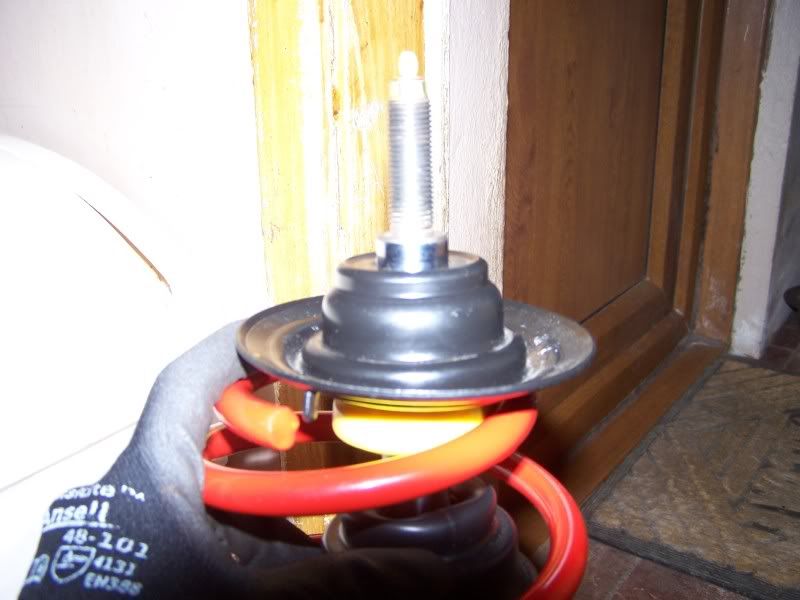

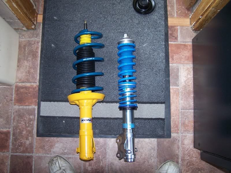

Trying to sort out the suspension for the car I decided to go for a 60mm drop using spax springs. Removed the front shock and then the Koni spring, assembled it all but together and found that the Spax spring wouldn’t compress, it was just moving around as it wanted to.

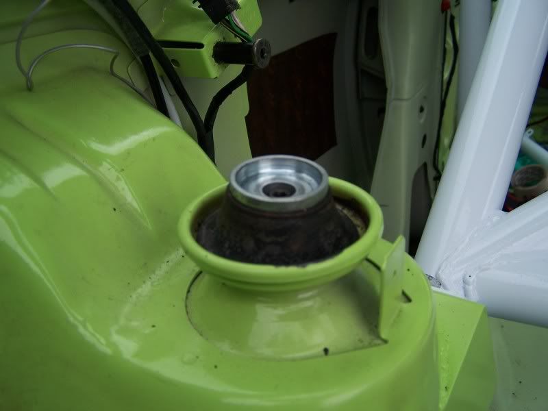

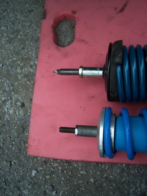

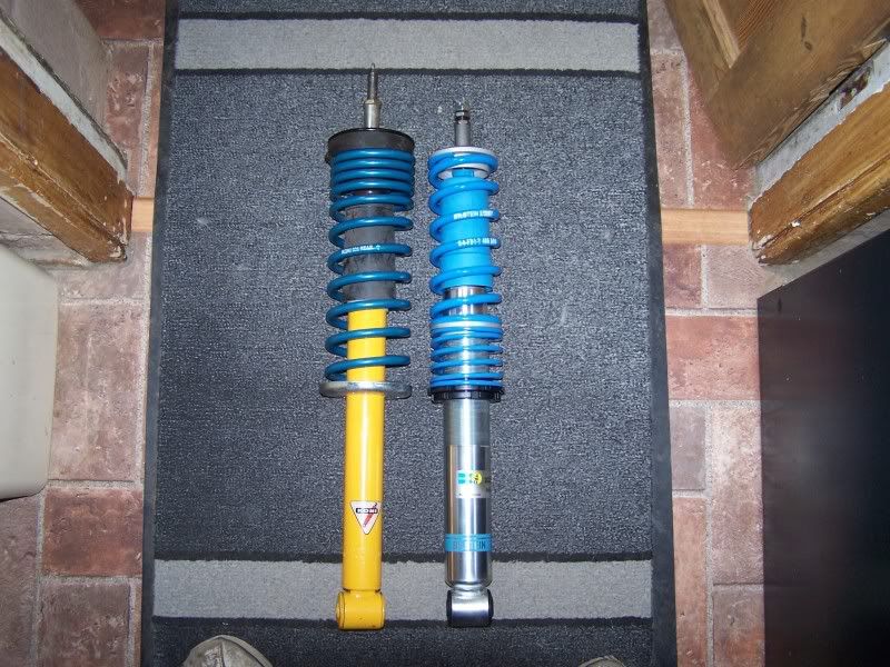

I had enough of the standard ride height of the snot and the Spax spring was too short for the Koni shock so I ordered a set of Bilstein B14 Coilovers. Took only a week to come from Germany, I got them Tuesday and by Wednesday morning I was fitting them.

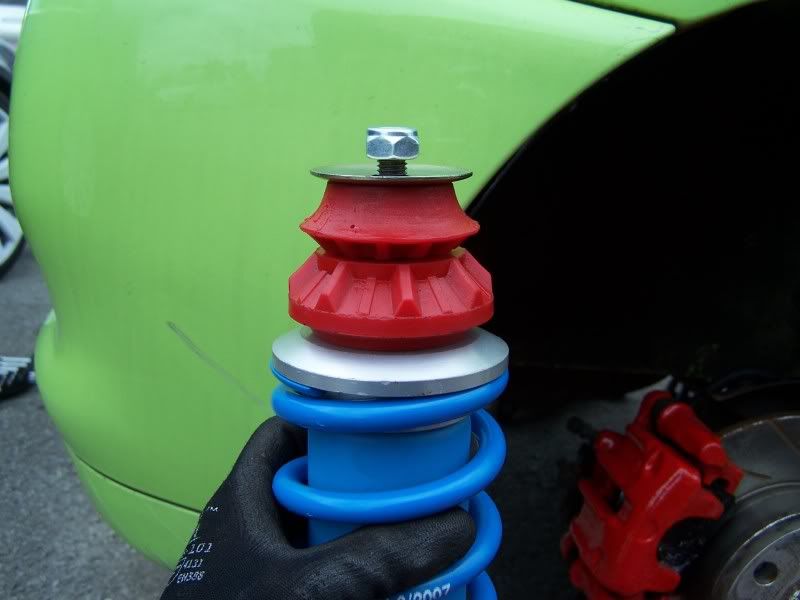

The front went on with no problem but when it came to the rear the thread pin that you place the bushes onto and then the nut to hold it in place was too short.
Here’s a pic showing the difference between the Koni to the Bilstein threaded pin
I had a set of uprated Mk2 Golf rear bushes that were shorter than the standard ones and built up these would allow the pin to become long enough.
With Standard bushes

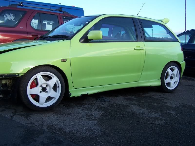

Rung DPM Performance and he emailed Bilstein to check they the right parts which they were. So I took their word and tried to fit them again, lowered the car down so the full weight was on them and still no luck. Thinking that the car is lighter than standard I decided to jump in the boot and bounce up and down while trying to turn the nut and it went, Happy Days!
The Bilstein next to the Koni’s
Front
Rear

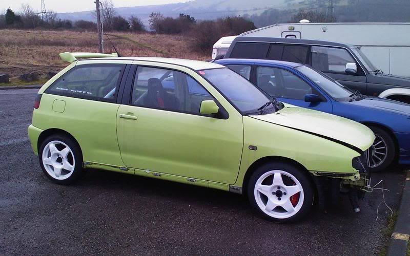

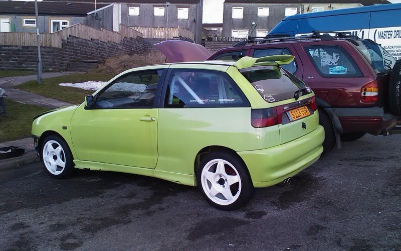

How the car is sitting now

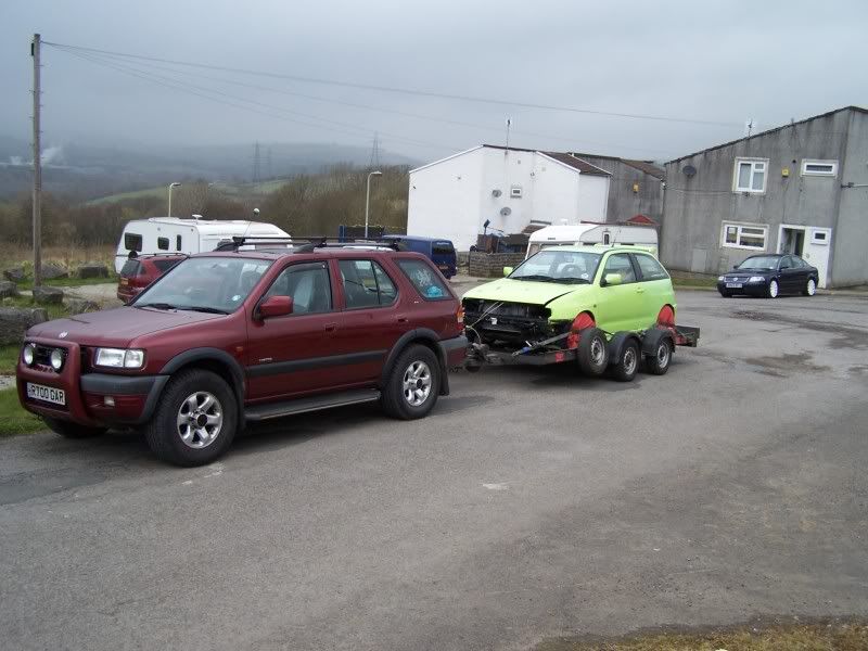

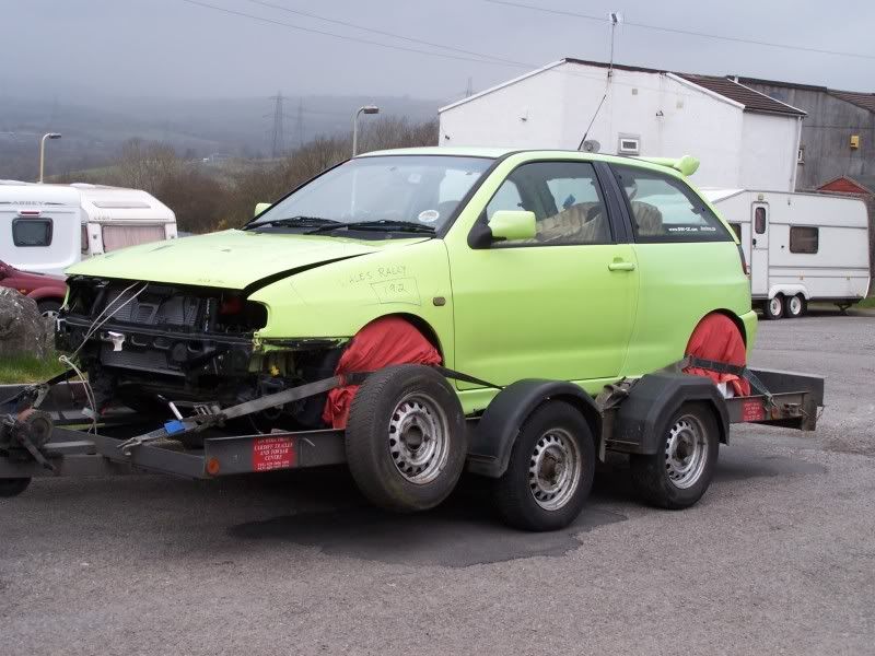

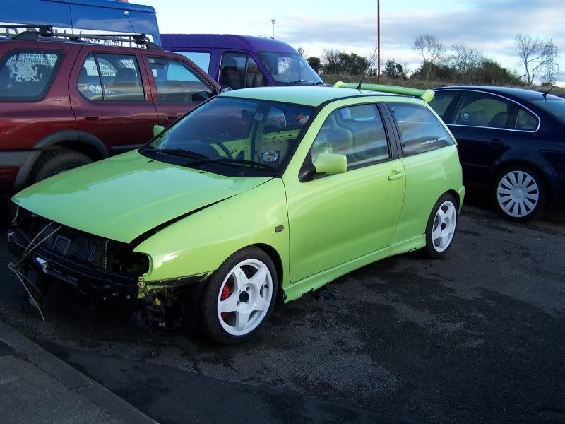

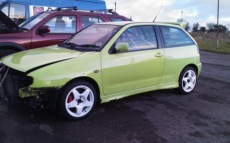

The snot was taken to the bodyshop yesterday (Monday). I took it to Old School Engineering in Bleancwm, this is the place that RS Rob had his fez done and pookie’s old Paxo when he sold it.

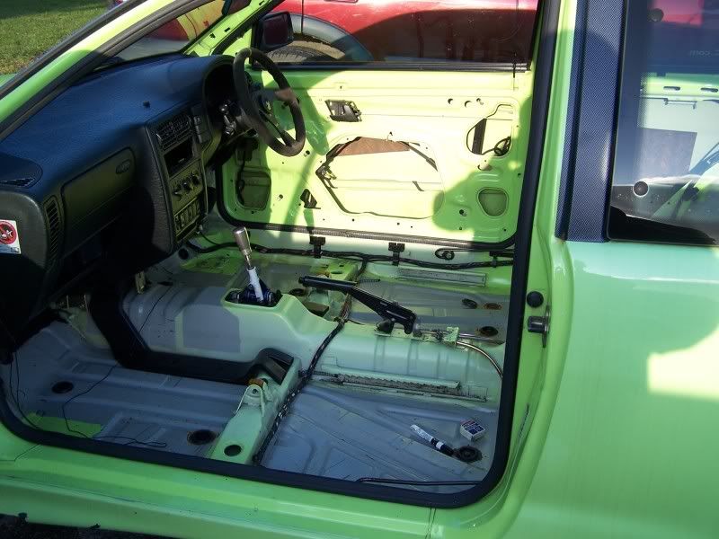

Before it went up, I was empty the inside of the car and found a pen so got bored and decided to write all over it then left the missus kid and my nephews draw over the panels that were getting replaced.
Then went to Cardiff to hire a trailer for the day and took the car to OSE
