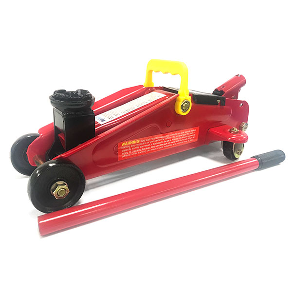

I need to jack up the front of my car and support on jack stands to change the brake pads only problem is there jacking points as shown in the manual are not long enough to fit both jack and jack stand on is there any other points for the jack or the stand thanks.

I would be using this jack

I got one of those Luke. I don’t put pads on it either, just slide it under the sill jacking points and make sure that the little cut outs are lined up so that the jacking point lip goes between them. Not gone as far as to then add axle stands though, cos fro me it’s only up off the ground for as long as it takes to change a wheel.
