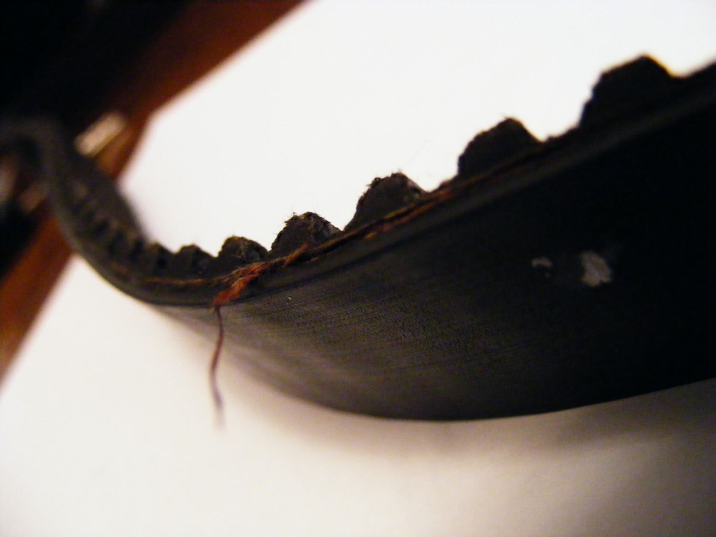

just to add my 2p worth,
a 6 year old cambelt with 38k on the clock, showing deterioration already, taken off my lc 3 months back,
not worth risking it matey, Fitted the metal impeller waterpump too, i honestly cant see the rotor failing either, plastic tends to deteriorate with constant temp changes, metal not so much,
