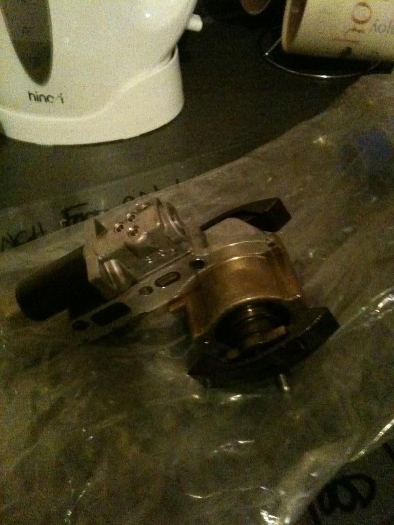

reason I ask is I'm wondering what else was moved across that could be causing a problem, like the vvt you said, maybe camshaft sensor? I'd expect a fault code though
vvt tensioner isn't gonna be cheap is it, anyone got a spare? lol
Had a quick look a moment ago otherwise id forget..
One vvt tensioner & bushers of a AMK Cylinder head (LCR)
