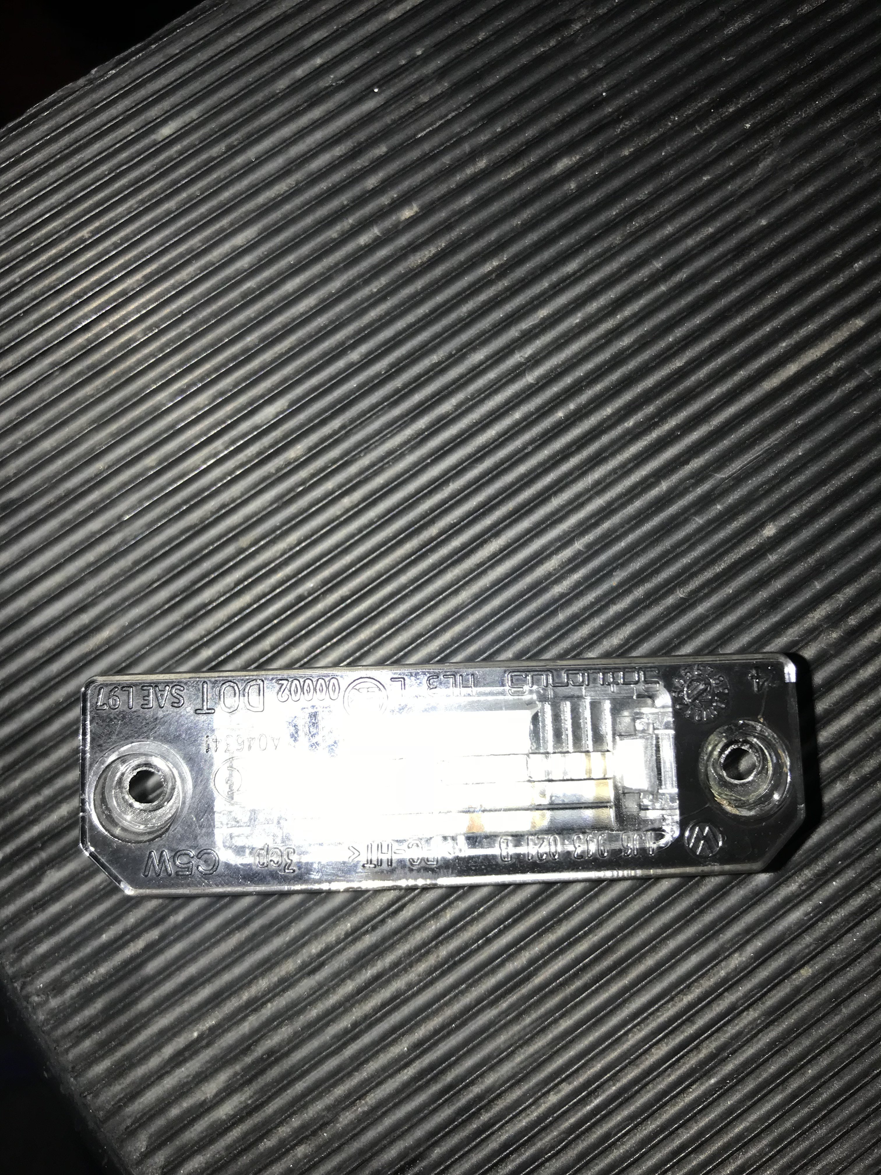

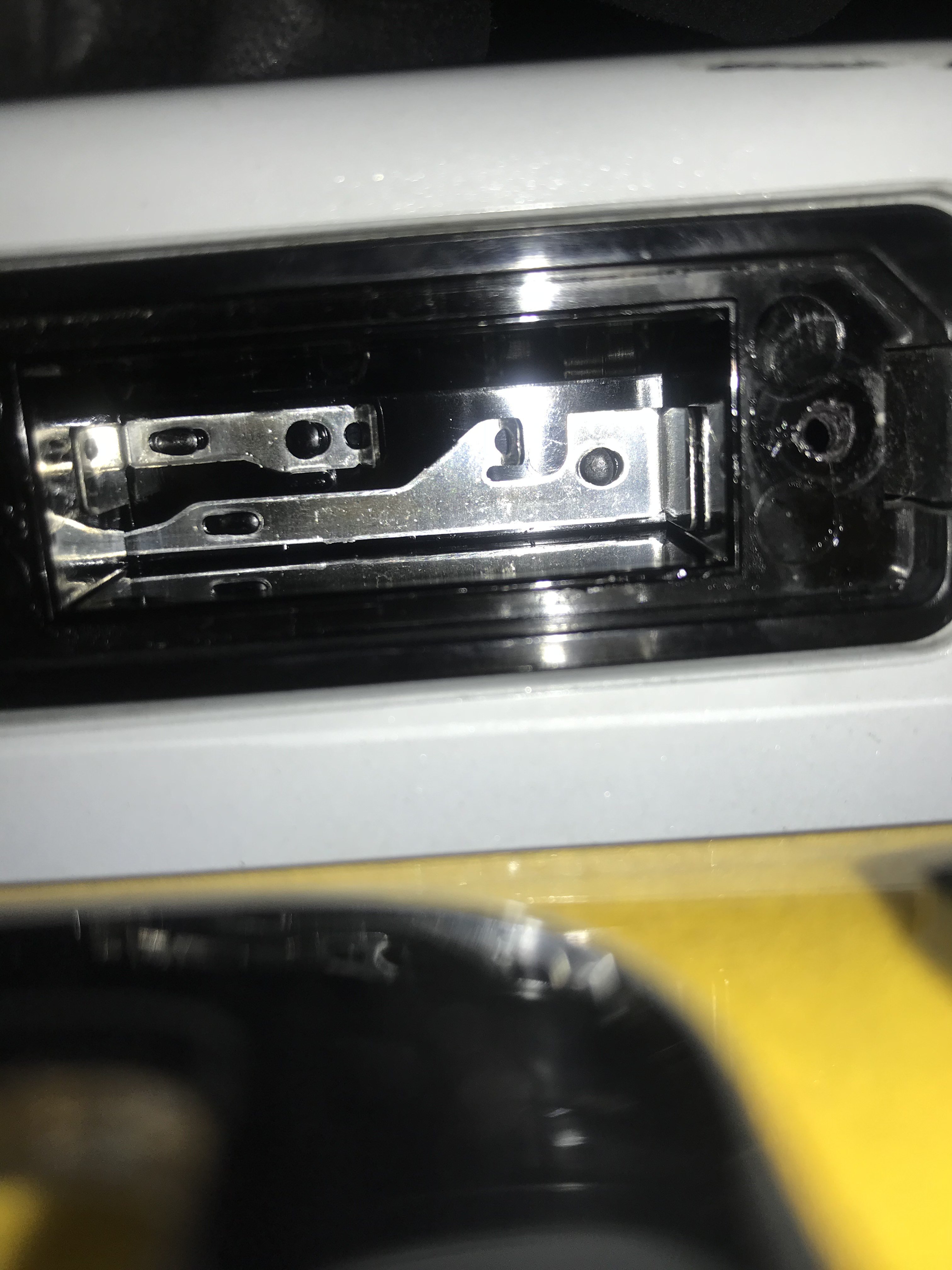

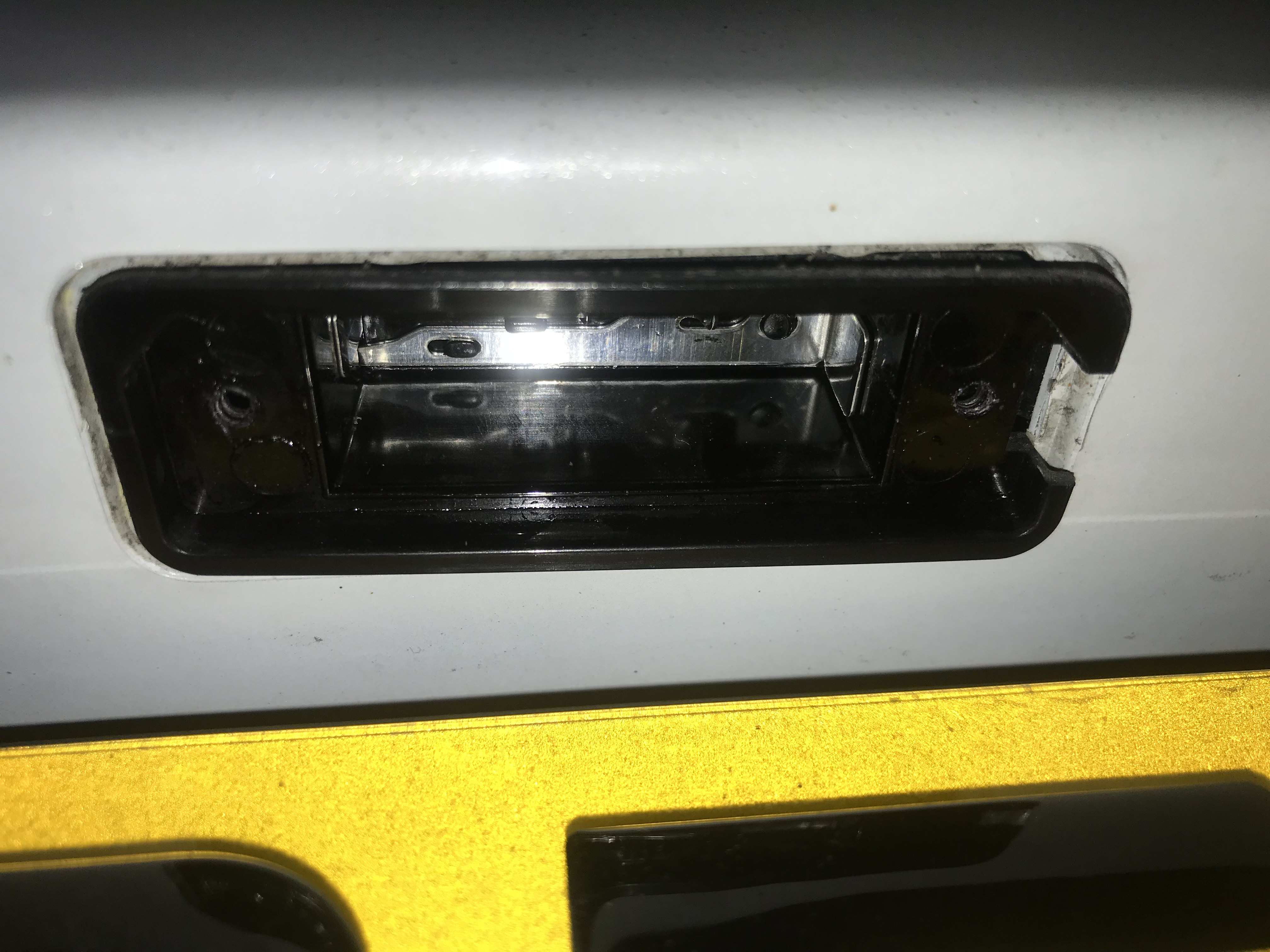

Hi sorry for the delay been working! I'm not 100% sure on the wattage of the bulbs and not even sure which ones I need hope the photos help!
Here are some pictures...

What wattage were your original Janos and what wattage are the LED ones? You should fine the details on the lamp or it’s metal screw in holder. That may indicate the issue.
Can you see on the pictures the wattage? I don't know where to find that information
