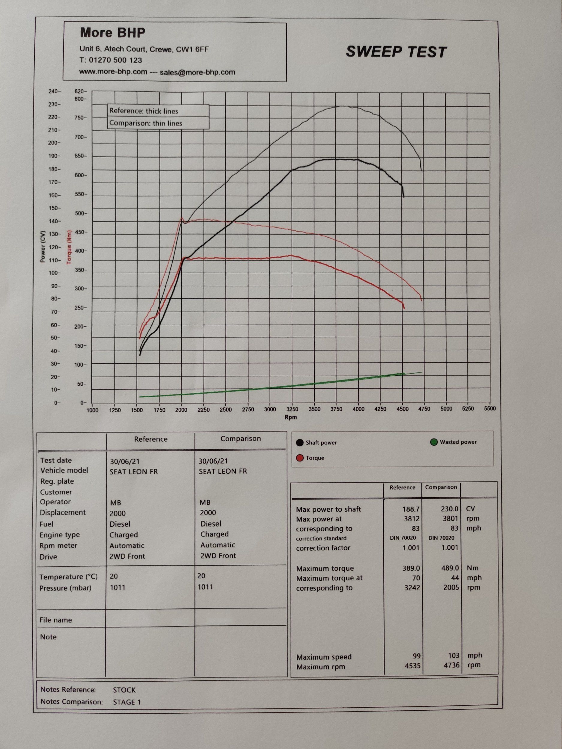

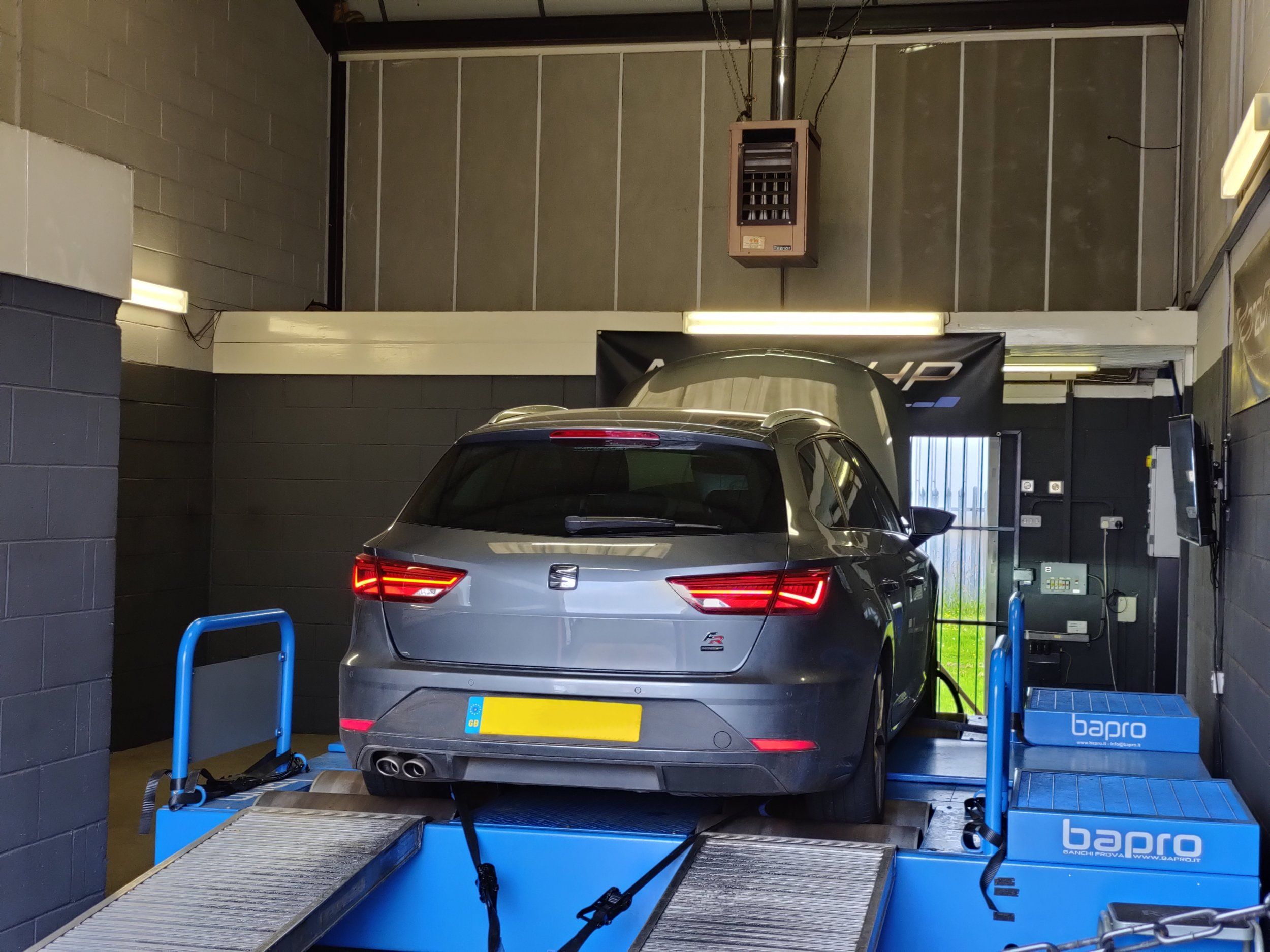

So following on from my saga of trying to get my Leon 184 TDI rolling roaded unsuccessfully at a different tuner, I booked the car in with the lads at More-BHP in Crewe for a visit today
Pre-sales support was excellent, and Jason answered all my questions (even the stupid ones), including assuring me that getting it going on their 4wd Dyno wouldn't be an issue. Price was agreed for a rolling road session, remap and DSG map at the same time to support the map + protect the gearbox ?
Fast forward to today, and Mike (the tuner) and Jason were both top blokes - very knowledgeable, friendly and happy to talk shop and walk me through what they were doing.
Straight up on the rollers, and this time absolutely zero issues - Mike had it straight into proper Dyno mode - where it promptly chucked out 188.7bhp/389nm at stock.
Mike then did his thing, altering the DSG parameters etc and then set about mapping.
All finished up she's now making 230bhp/489nm, so a +41bhp and +100nm increase
Super impressed with them, and the car is absolutely brilliant. Drive home back down the M6 and first impressions are just effortless torque, it just picks up in any gear and pulls... Hard! Acceleration in all gears is noticeably better, even from a standstill - just need to look at a dogbone mount now as wheelhop is still an issue, but I knew that already even before the map.
Overall very pleased with them, if you're in the Stafford/Stoke/Cheshire area I'd absolutely recommend them!
That's a solid result(y)
What is interesting is that the max. torque now sits much lower down the rev range which probably would make a huge difference to the way the car drives, even without the extra 100Nm you've now got.
Yup it's completely changed the way it drives, you now get a solid slug of torque almost immediately, and it doesn't seem to run out of puff as quickly as you climb the rev range. Feels like a completely different car!
The OE torque curve is a big flat table top starting at 2000rpm - the slight bump at 3242 would be unnoticeable so I would ignore that quoted 'high' rpm for max original torque.
Agreed. Definitely feels like the power comes in sooner, but I'd chalk that up to how much torque there is basically straight away, and the fact there's now a lot more of it.
