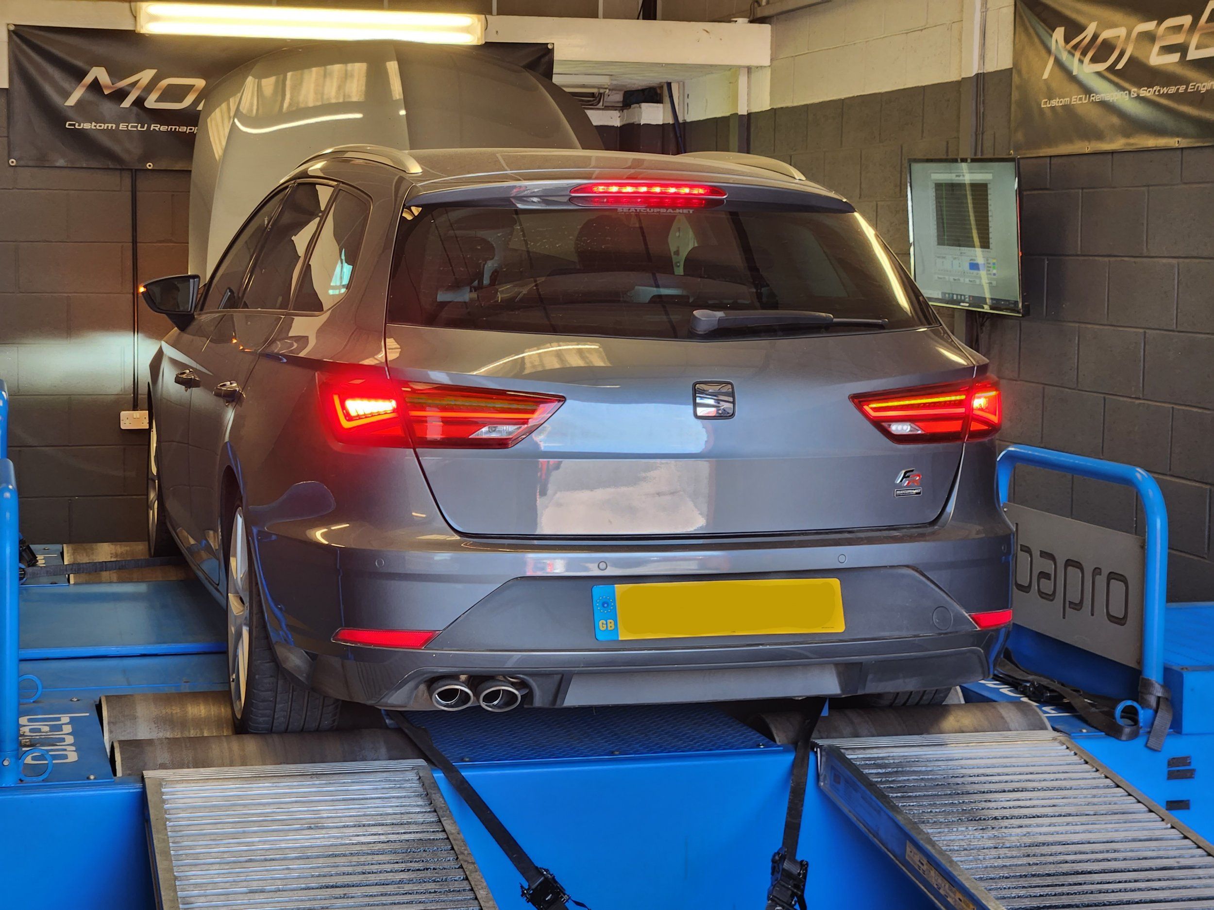

So following on from my saga of trying to get my Leon 184 TDI rolling roaded unsuccessfully at a different tuner, I booked the car in with the lads at More-BHP in Crewe for a visit today
Pre-sales support was excellent, and Jason answered all my questions (even the stupid ones), including assuring me that getting it going on their 4wd Dyno wouldn't be an issue. Price was agreed for a rolling road session, remap and DSG map at the same time to support the map + protect the gearbox 😎
Fast forward to today, and Mike (the tuner) and Jason were both top blokes - very knowledgeable, friendly and happy to talk shop and walk me through what they were doing.

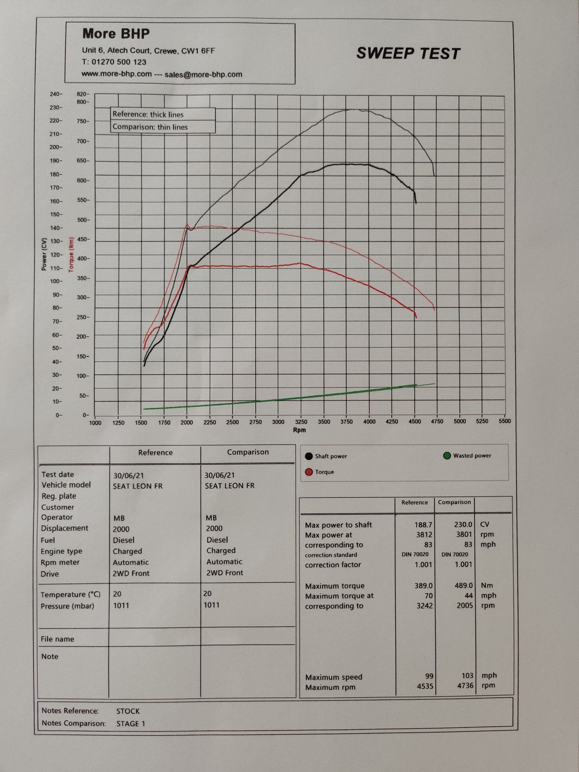

Straight up on the rollers, and this time absolutely zero issues - Mike had it straight into proper Dyno mode - where it promptly chucked out 188.7bhp/389nm at stock.
Mike then did his thing, altering the DSG parameters etc and then set about mapping.
All finished up she's now making 230bhp/489nm, so a +41bhp and +100nm increase
Super impressed with them, and the car is absolutely brilliant. Drive home back down the M6 and first impressions are just effortless torque, it just picks up in any gear and pulls... Hard! Acceleration in all gears is noticeably better, even from a standstill - just need to look at a dogbone mount now as wheelhop is still an issue, but I knew that already even before the map.

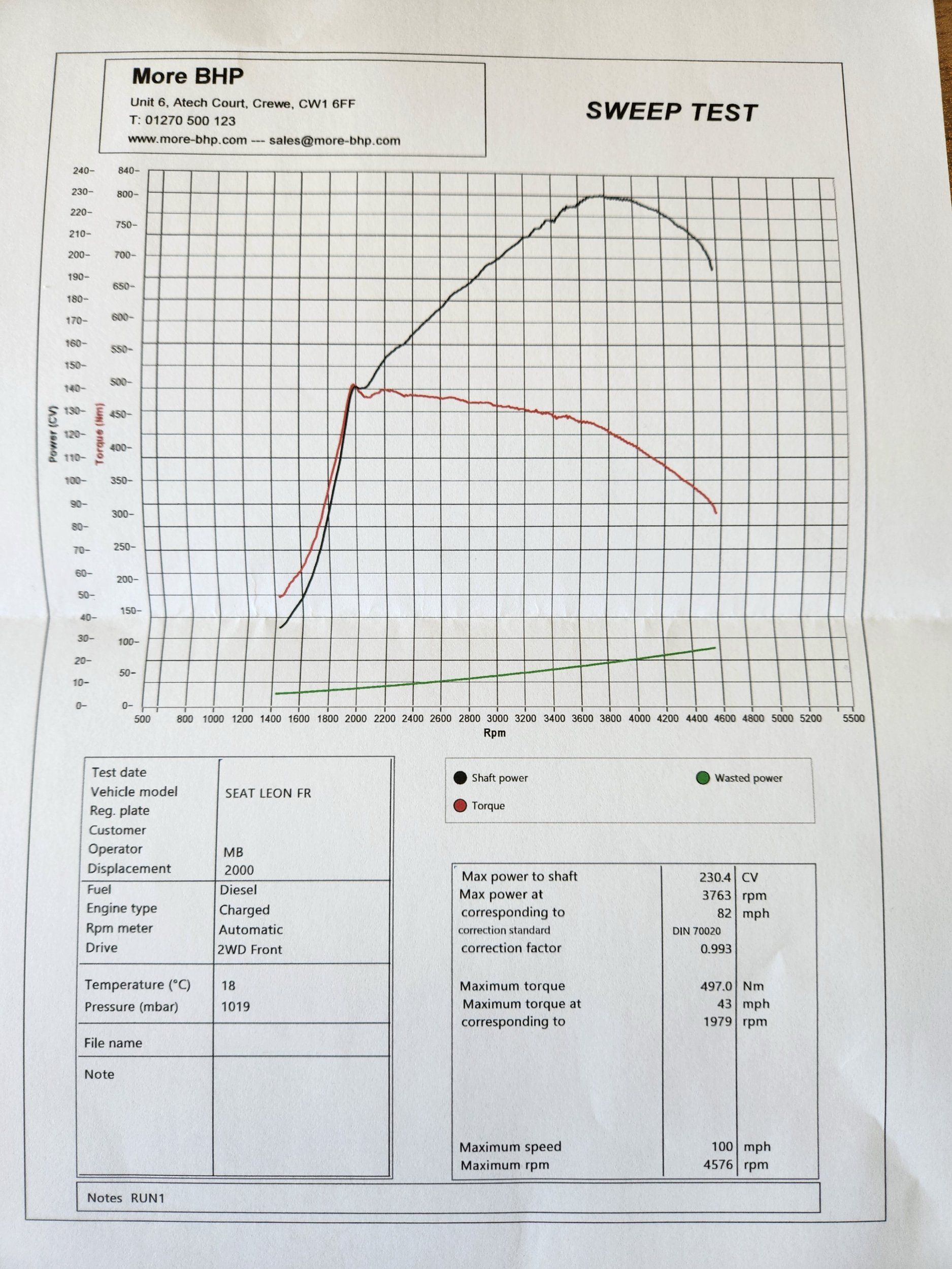

They restored original parameters to the TCU, but as the ECU update had actually changed the rom completely (rather than just resetting settings to OEM ) they recommended that rather than trying to flash the old rom and original map back over the top, it would be better to do a fresh map - choice was mine. I agreed, and for the princely sum of £50 for a couple of runs on the dyno, they did a completely fresh map
Results came out slightly better than the first map:
230.4bhp / 497nm @ 1900rpm
Results are once again fantastic - I cannot overstate just how much better than stock the car is to drive! It’s a completely different beast
