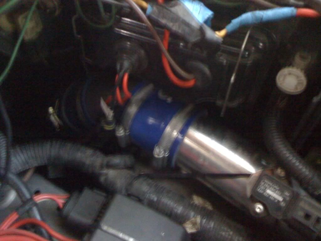

63mm (2.5") you will need 2 reducers, 76mm - 63mm for the IC to the pipework.. get silicon joints not cheapskate rubber ones..I have just learnt the hard way and will be up early replacing a joint before trekking to silverstone :(

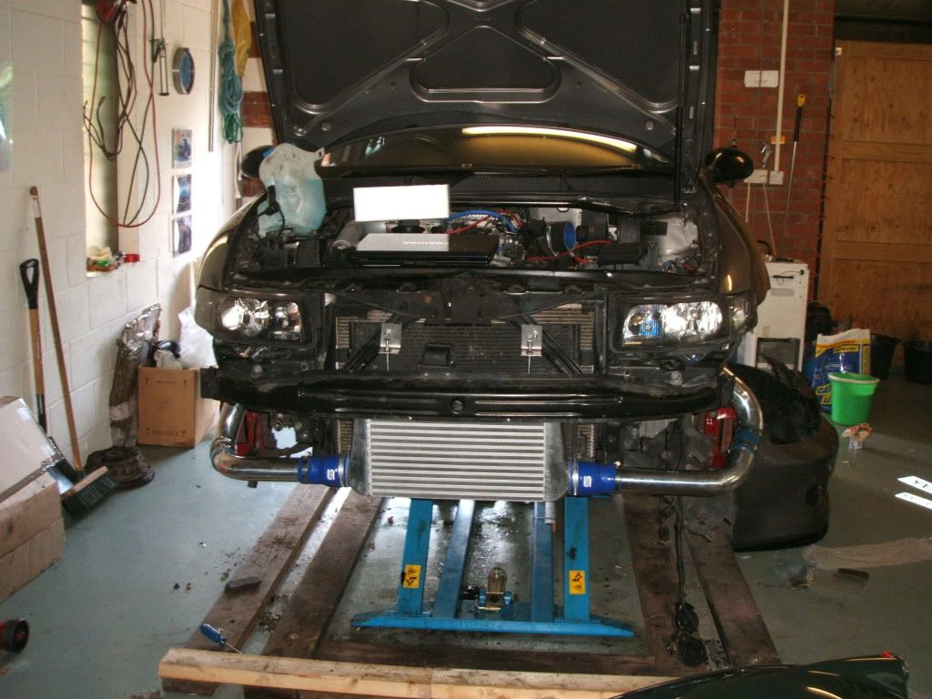

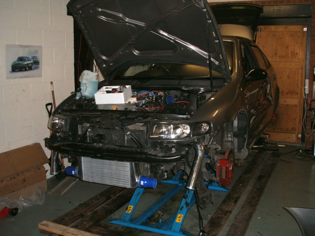

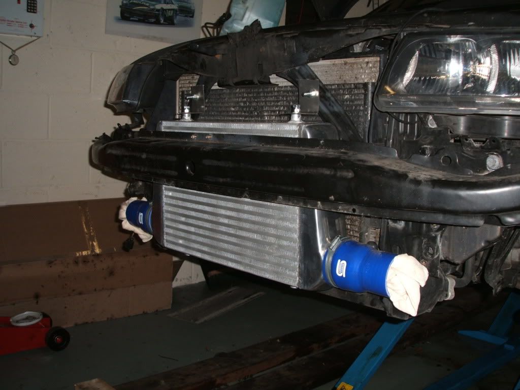

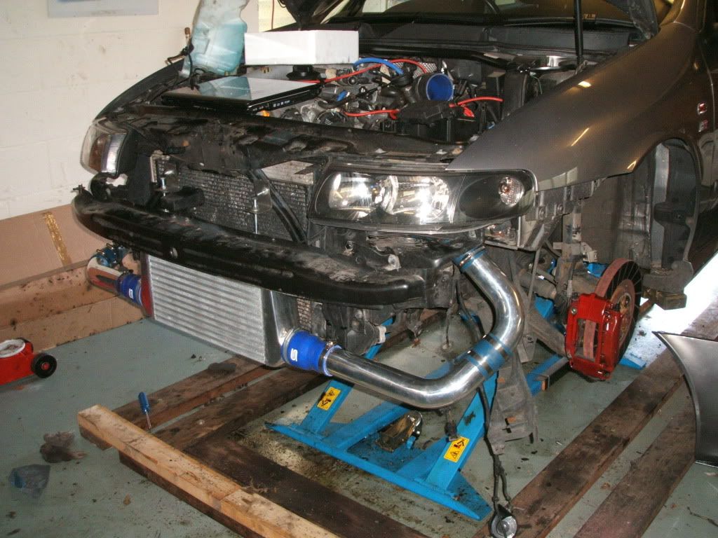

Finally got around to putting pics up of my FMIC installation:

Alright Danny, looking good there bud.

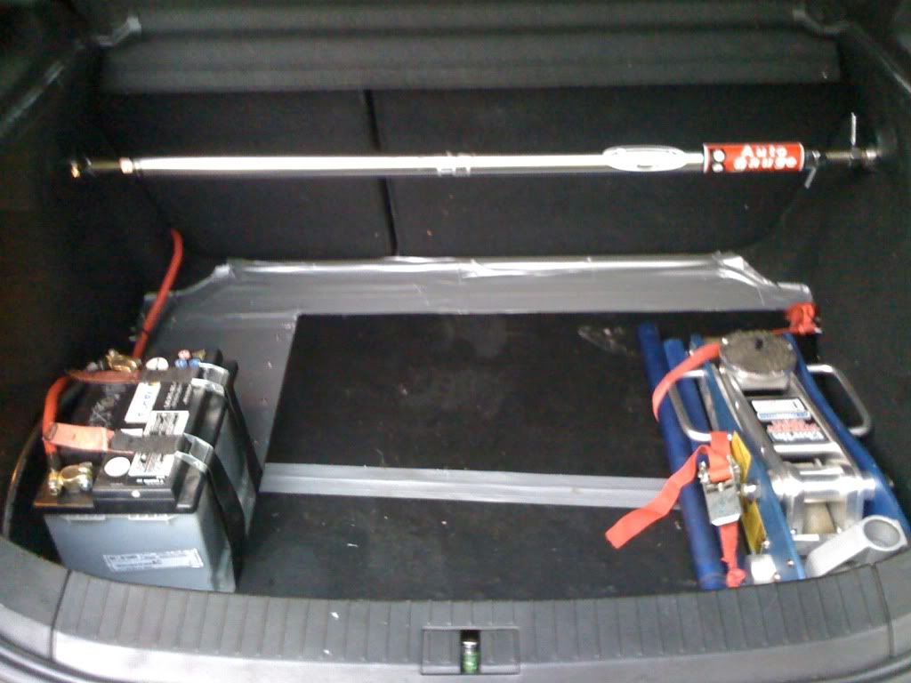

Trolley jack travels everywhere with me - I have no faith in the Seat's scissor jack after the car fell off it (luckily the wheel was still on at the time).
The boot floor is actually 12mm MDF supported on 2by1 battons.. extra weight, but means I can put all my tools/jerry cans in for karting without the floor falling through!!

Fair enough, the widow maker is a bit worrying to use.
I on the other hand have no spare wheel, jack or nut spanner.
Light is the way forward;)
