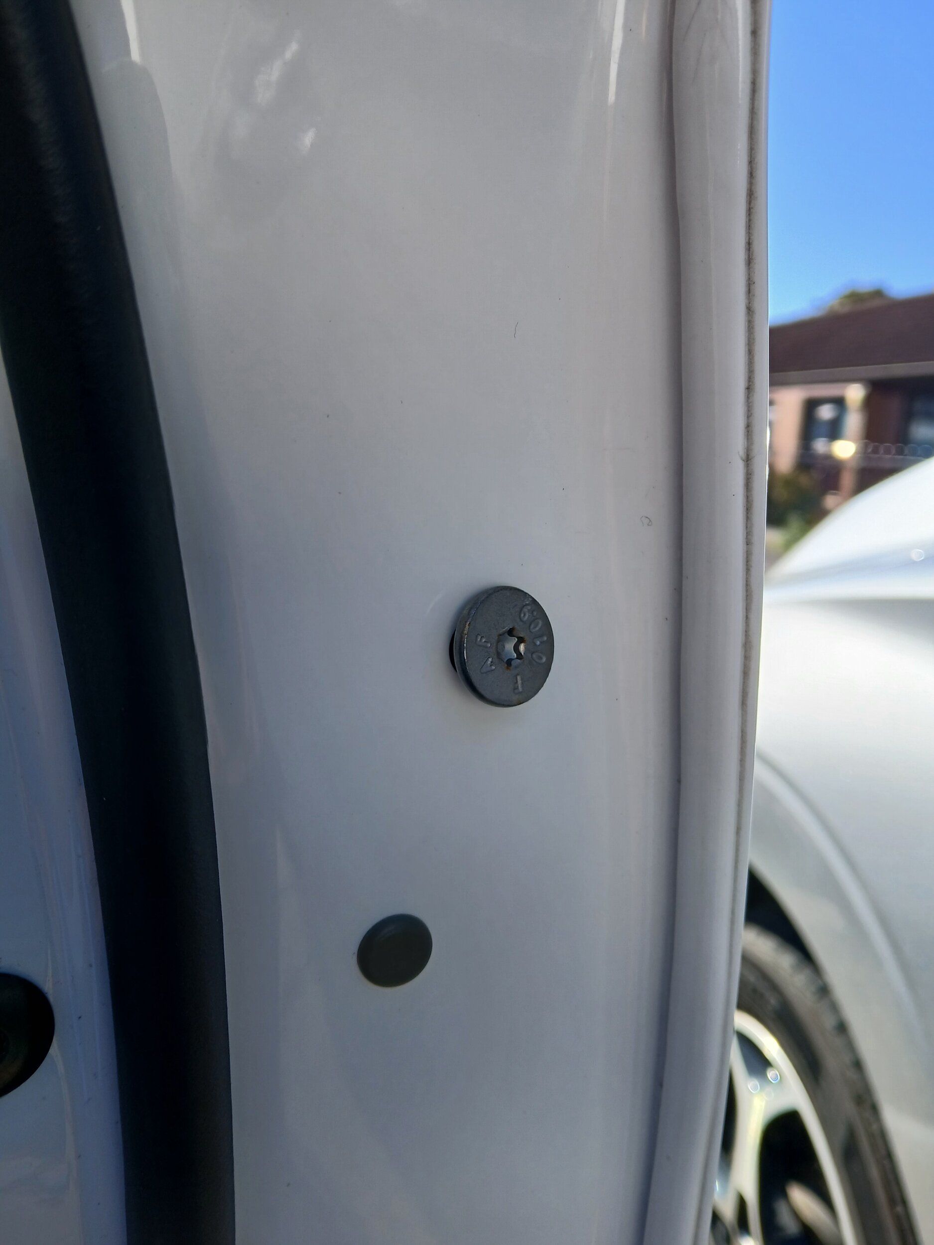

I take it it's the drivers door?
That bolt pulls out the lock cylinder if you need to replace the door lock as you only have a lock on the drivers door.
