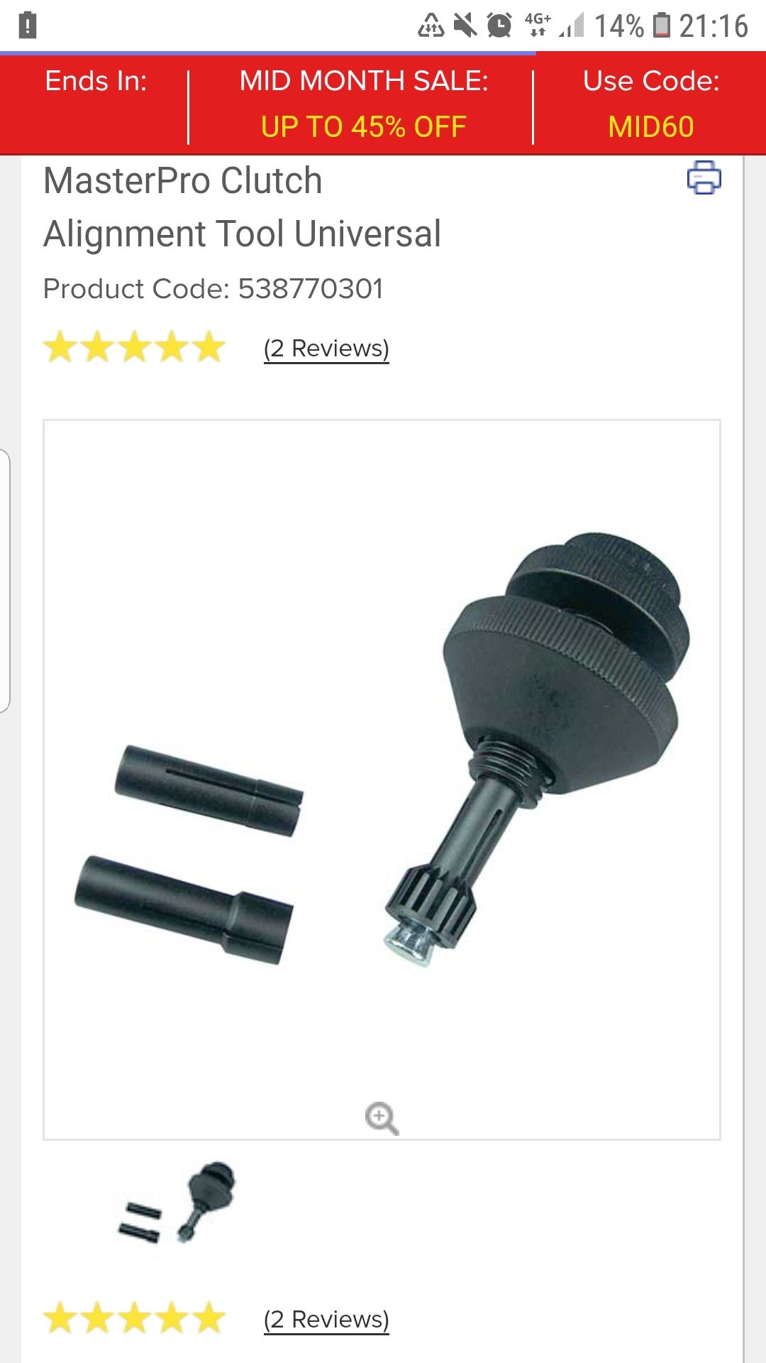

Thanks for the replies, I forgot to ask can anyone recommend a clutch alignment tool that works with these, preferably something i might be able to get hold of tomorrow!
(if I'm lucky)
Halfords or your local car spares shoo will sell one.
Very easy to use and sold every where.
Reactions: elviscat
Or do it by eye. Lightly tighten 3 (at say12,4,and 8 oclock positions)of the bolts so the cover slightly grabs the friction plate. Then move the centre plate to the central point with a long 3/8 extension or long screwdriver.
Good to go.

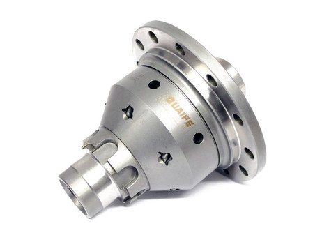

Looks like Differential is in bits, took off one of the driveshaft flanges to get the box out, and by the time the box was out there was nothing for the allen key bolt to go back into through the flange, looking into the diff there seems to be some bits rolling around on their own.!! a mate is saying my as well get a recon box.
Any recommends?
DMF and clutch are ok btw, although i have new ones to replace. I was thinking of getting quotes of Gloucester Road Gearboxes for a rebuild, any thoughts?
