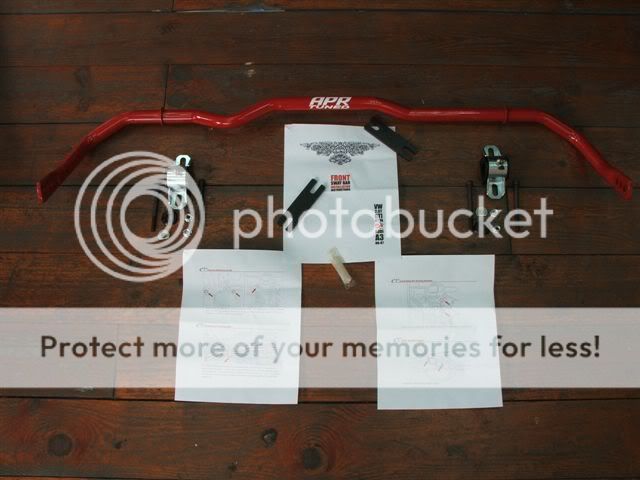

In order to complete this suspension setup I have chosen to go with APR's front and rear anti roll bars , 27mm diameter and with 3 hardness levels :

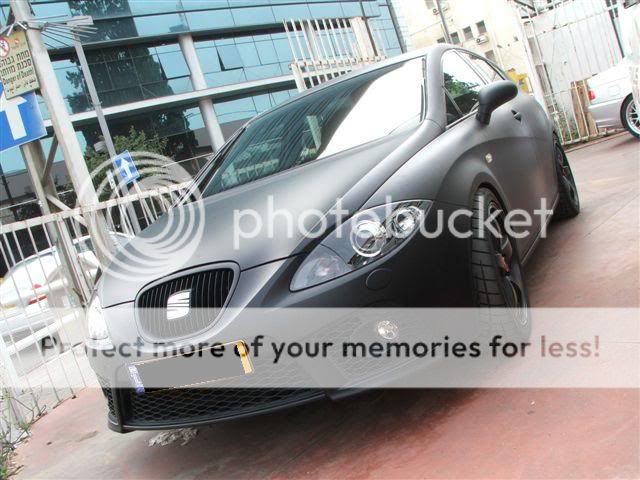

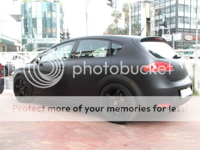

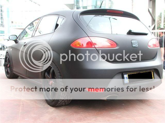

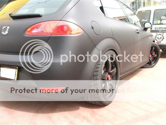

And now for some pics :
shaping up nicely, like the ride height, bit concerning that it rubs at the moment though!
