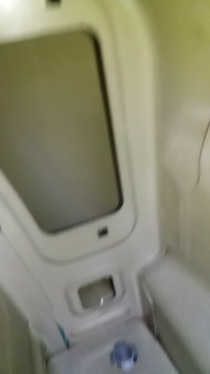

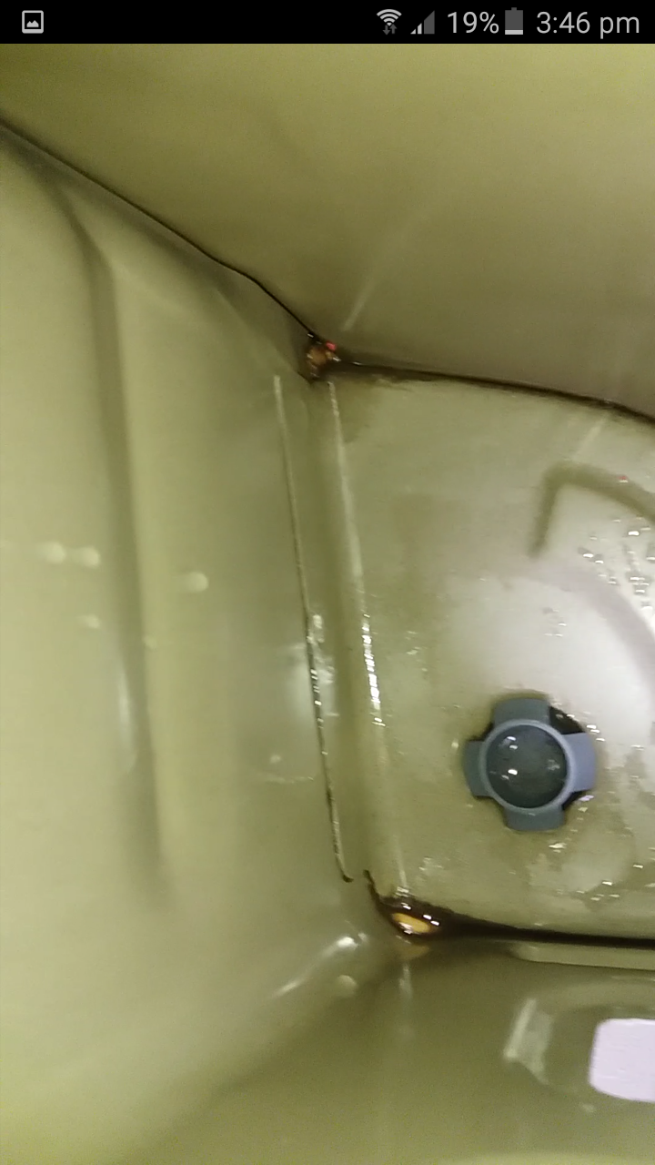

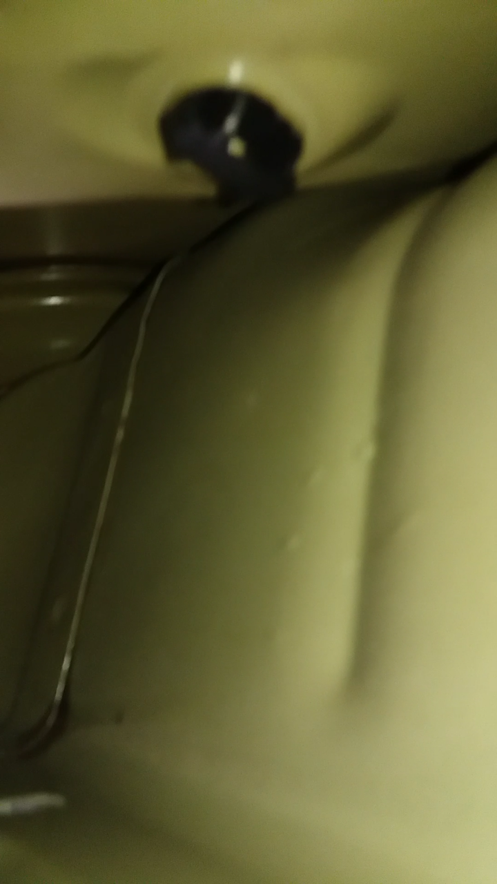

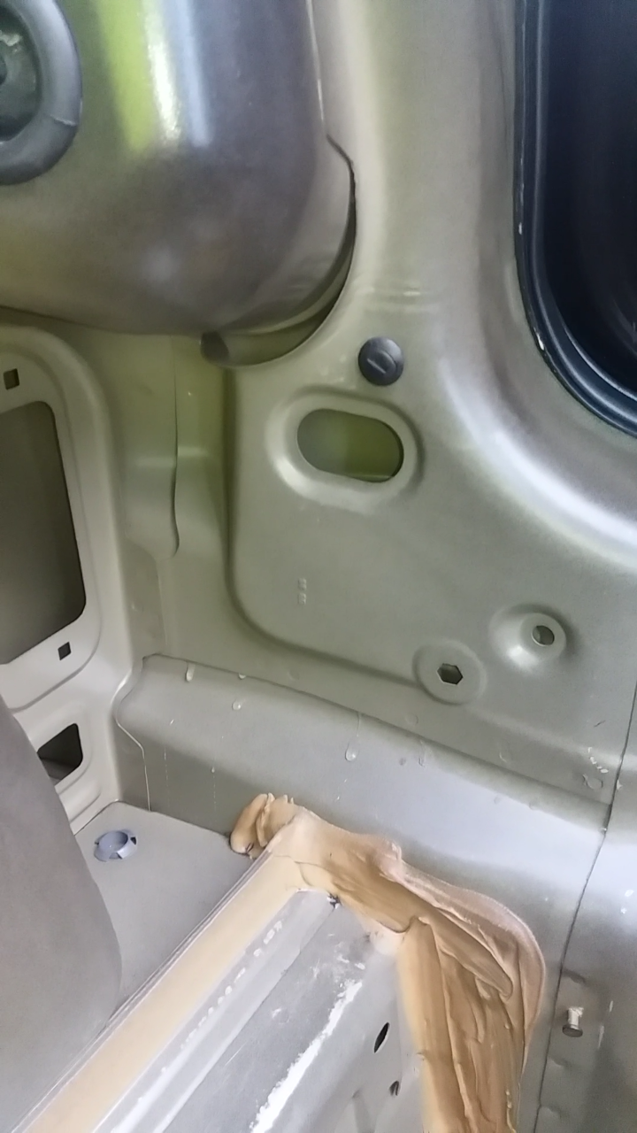

I've a leak in my boot due to the rain Mines not the washer pipe its the rain that making my car leak. I've a 2010 seat ibiza that leaks at the drivers sidewall I've ran a hose over the car an it seems to leak in worse when hosing over the top of the hinge at the drivers side area but still can't see any issues how it's gettn in
think your ibiza is a mk5 so might be better off in that section. i got mine fixed at the garage, i think the hose was just loose
I got the hose on my car replaced tho as the hose on it was a plastic type an was leaking when i used it But got it replaced with a rubber hose cured it gargare done mine for £160 few weeks ago but it's rain that's making my car boot leak but day by day where hoping to find more info on it an seal more areas to fix the leak but its finding the right spot to seal tho
how are the rubber seals looking? are they intact?
Is that the boot rubber seal As there's a Brand new one on it 3 days ago got it from SEAT plus a new light but still leaked so need to seal as much places around the top hinge area as I can an hope for the best
