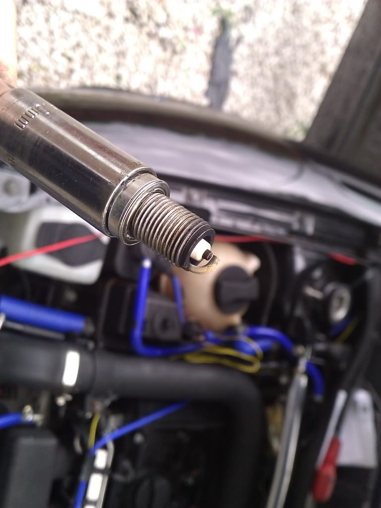

Also this is what my 100 mile old Plugs look like:

Hoping it ain't the rings but if it is so be it...
But speaking to Alex I'm going to log 020 to read my knock as i keep getting the knock sensor 2 code...
forgot to mention that with the engine running when cold and i unplug coilpack 4 nothing happens...yet if unplugg any of the others it will hunt for revs and cut out...

Hopefully it's not the rings. But when you tak out the coil and plug what else could it be that is causing loss of pressure...? Well worth hunting around for a spare coilpack, maybe try swapping them over see what that does.
