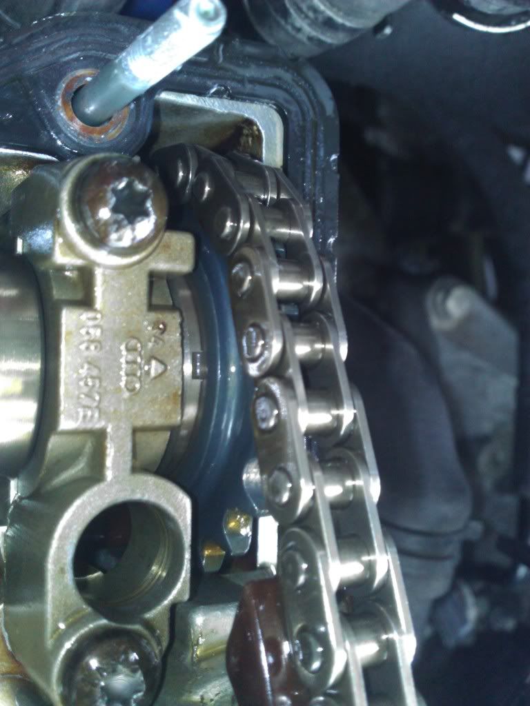

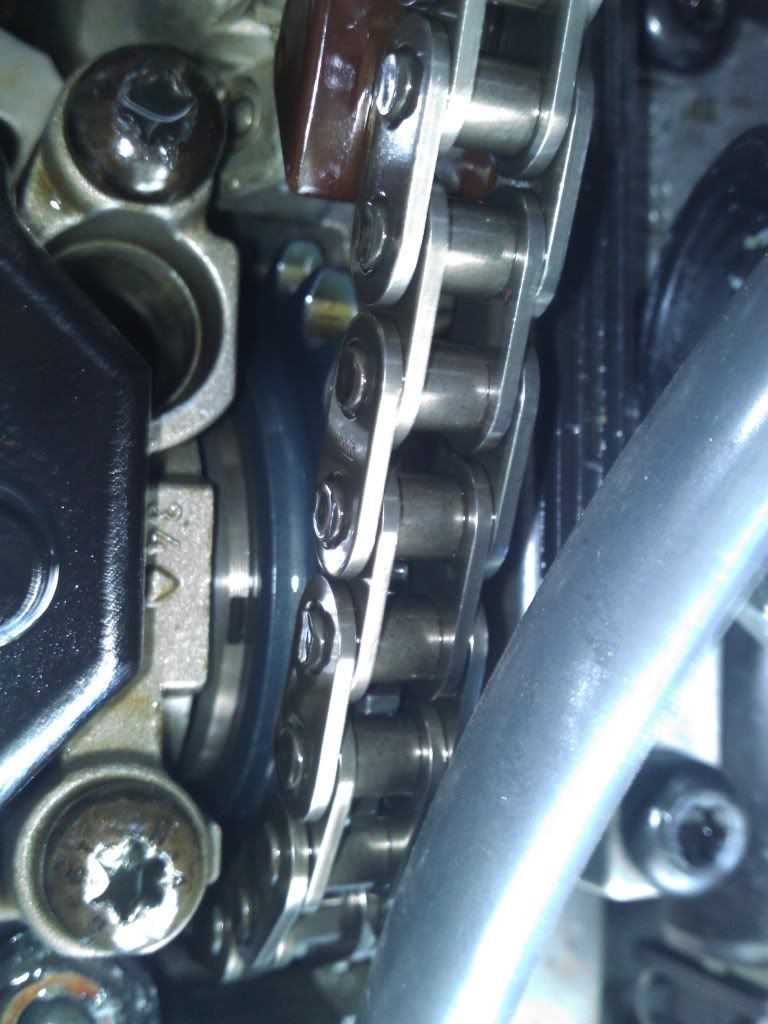

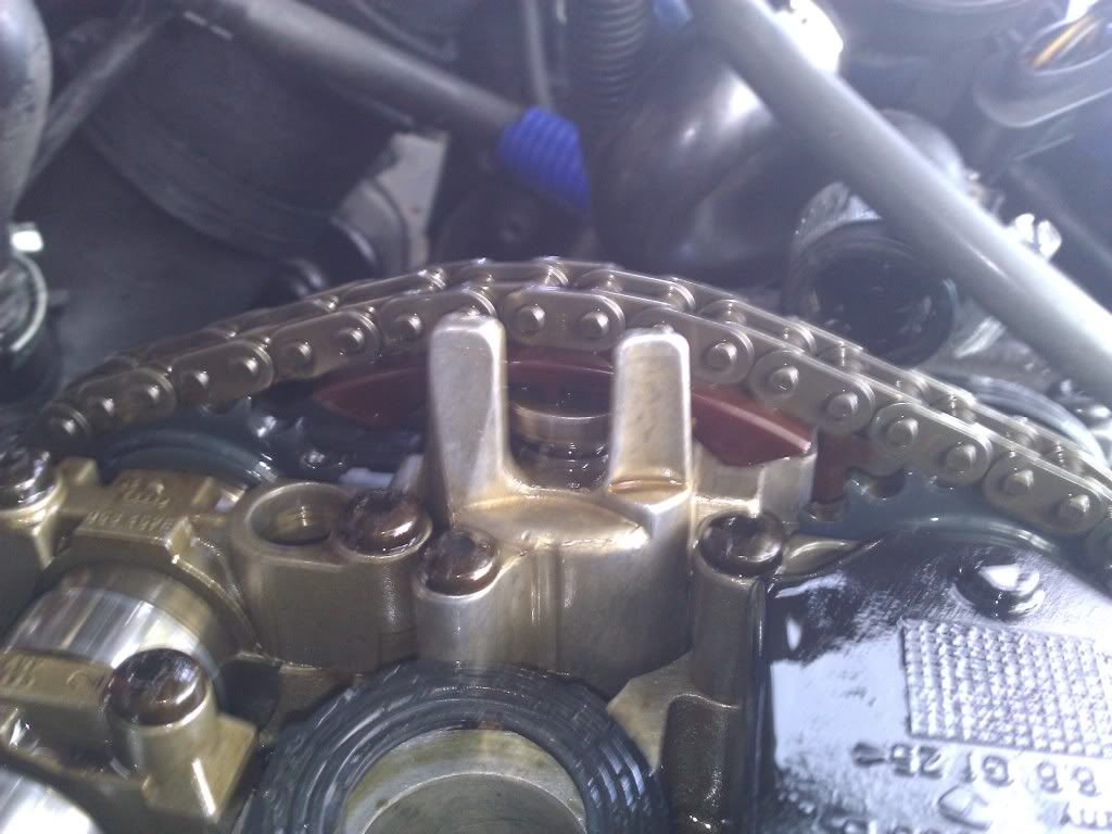

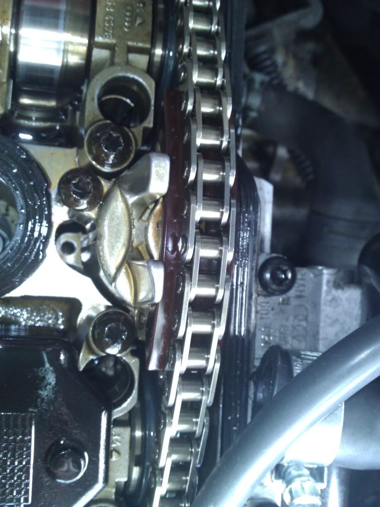

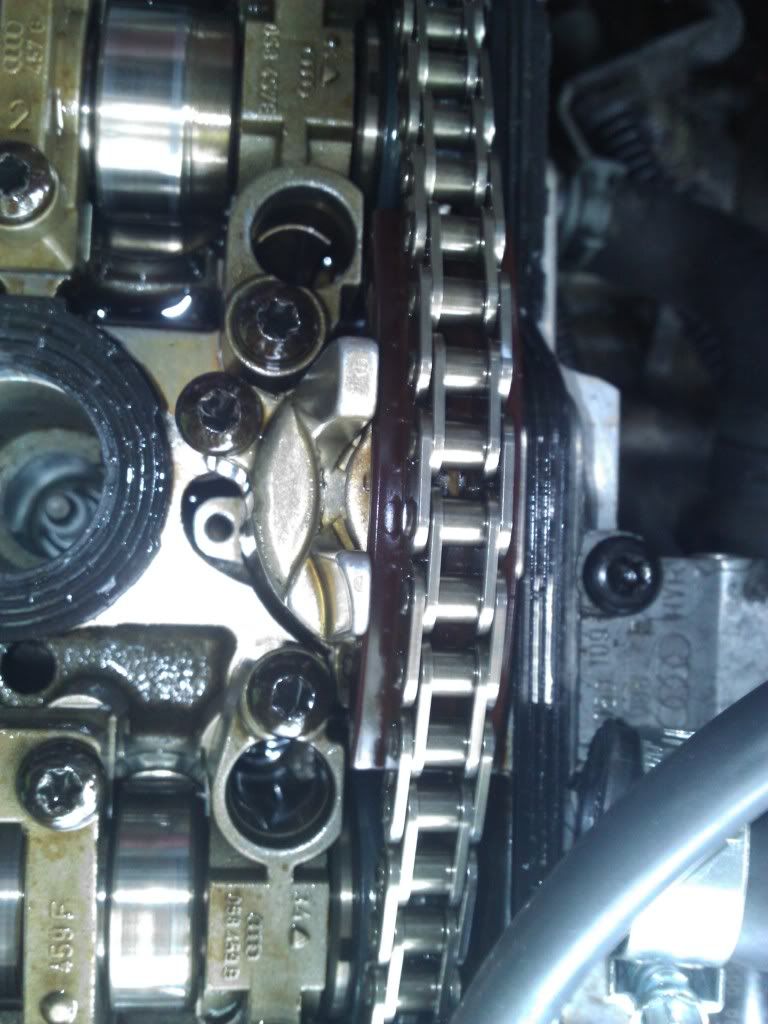

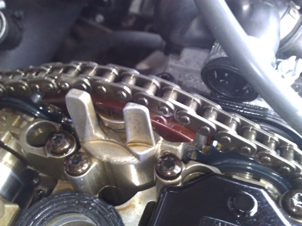

ive timed it up and it looks like 16rollers like you say..
Some Pictures:
