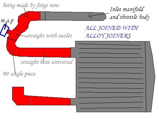

Ive got all the details on pipework as mine was the first car to use Foge pipework with the Seat Sport FMIC ;)
[/IMG]
there you go :)
what are the diameter sizes of the aliminium tubing, the silicone hoses and the reducers?
hoses are 51mm and reducers are 60-51 mm. Alloy pipework - You need x2 90 degree elbows of which one will have the MAP Sensor fitting on. You also need a 45 degree elbow. Pipework will be 51mm i think then.
unless any of us are willing to buy the forge kit, then the sensor location is going to have to be made in the system.
already, got a few ideas ;)
the hole which the sensor fits into, what diameter is that?
or should i say, how big a hole does that sensor need to locate into?
