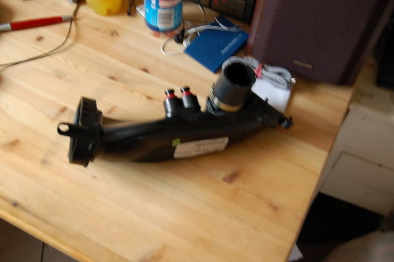

Eaton Inlet (from BMW) that will be adapted:

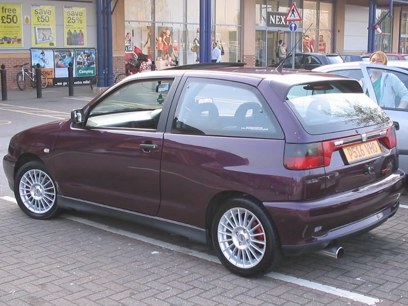

was a busy boy yesterday, fitted my new head unit, petrol cap, new front discs and pads (brembo / ferodo) and rear wheels
BUT
i've accidentally found how i want it to look, BEST STANCE EVER
Think my brakes needed doing :lol:
and the money shot:

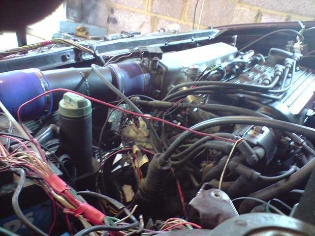

And some engine bay pics:

Very nice been reading this thread for a while,
could be done with a good clean though that tyres looks like it shall be scraping galore.lol.
Also looks a very complicated engine bay

Lol ok mate, fair play, the s'charger is alot bigger than i 1st thought, shud have the outlet plate made up either 2morrow or friday, inlet looks like a rite nightmare 2 do lol

the inlet is a bastid, there was a guy on ebay that used to sell M45 inlet adaptors (the oval shape to 3" round) and they werent that expensive, should have bought one then, cos the inlet is a problem
