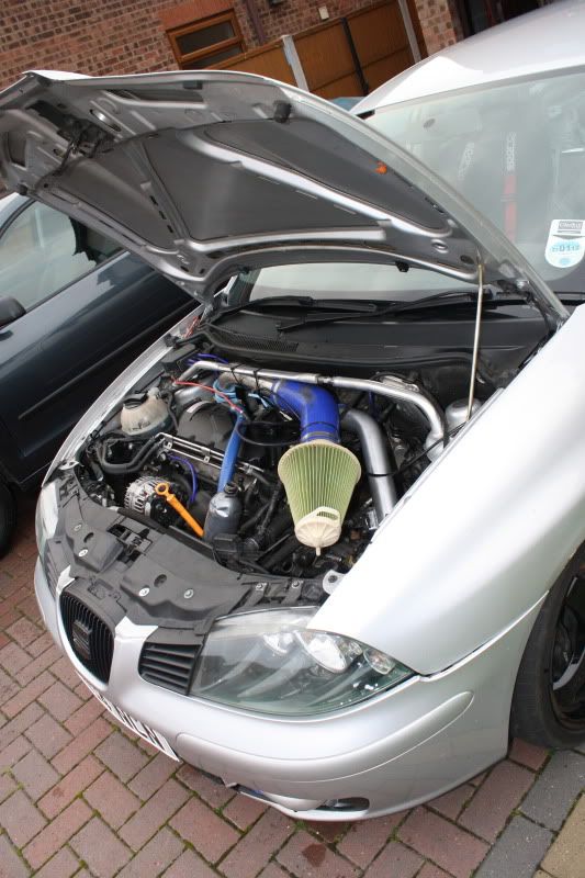

Couple of updates.
New boost gauge:
New intercooler pipework andf paper cone filter:

Wanted to do something a bit different, so thought sod it, side exit exhaust!
My exhaust now consists of the Darkside Developments 3" downpipe, into a 2.5" side exit. The downpipe narrows anyway, and 2.5" cat-back is more than adequate. Opted for a small mid box in there too, just to take the edge off the exhaust note.
