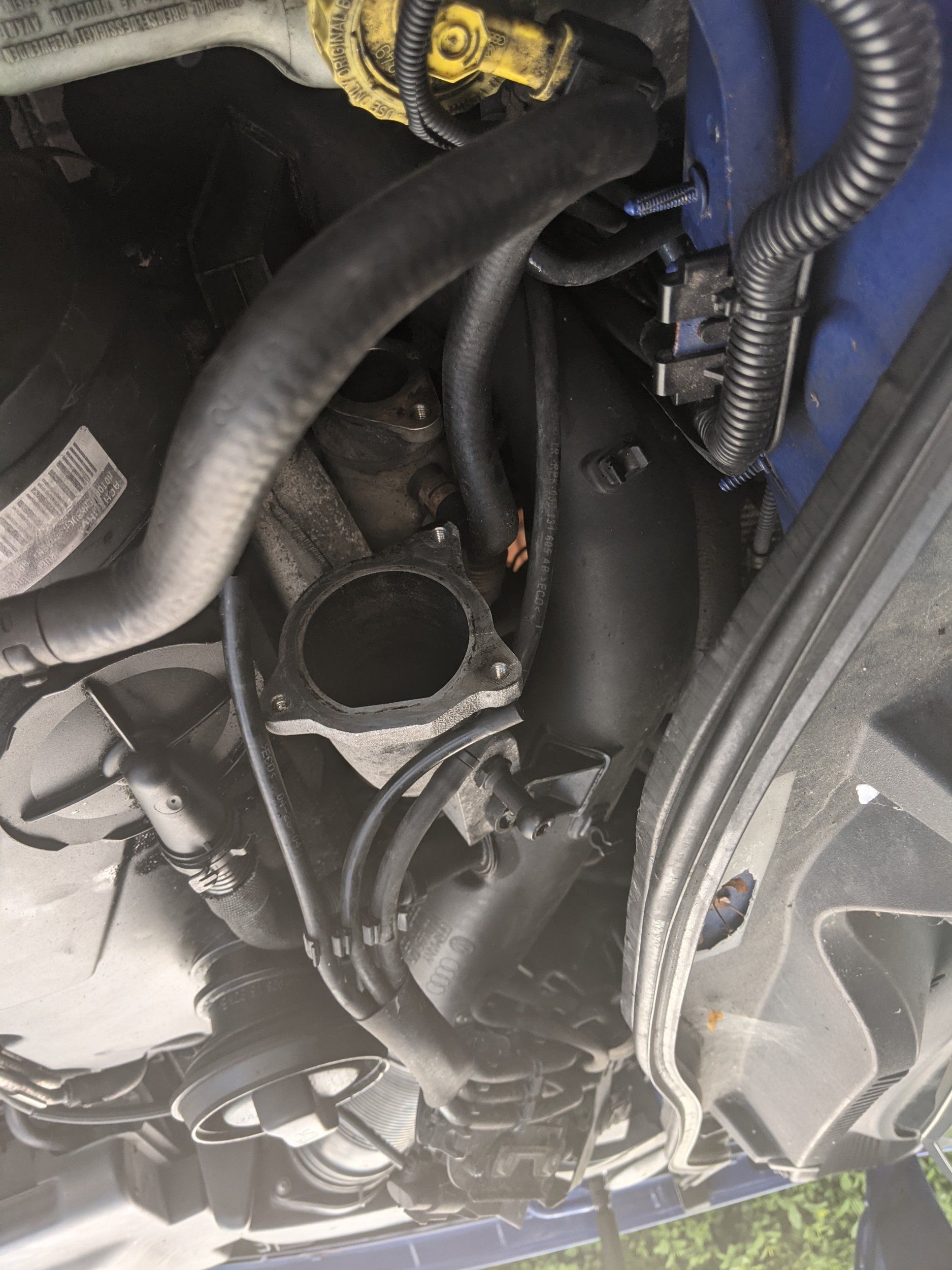

Hi all, bit of a noob here, 05/06 MK1 FR TDI, recently cleaned out my disgusting EGR valve in the hope it would fix the lack of power I was getting along with smokey exhaust and disgusting smell when revving, to no avail, now thinking I may have to remove the manifold and clean all that or failing that an expensive job replacing the cat, I have been advised to remove the exhaust and if the engine gets power back I know the issue is the cat, if not then I should just need to clean out the exhaust manifold, anyone have any advice or run into similar issues or ideas on what else could be causing the complete lack of power (the turbo seems to be working although the whistle is nowhere near as noticeable,) thanks in advance for any help, Chris

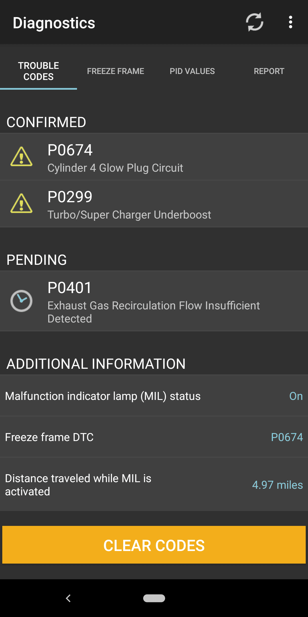

I just tried to run VAGDPF but although it connected to my OBDLINK LX it gave me a communication error. Here are the error codes I have if that is of any help

Right, looked at the error codes and the lack of power you mention is confirmed by the P0299 code as low boost. Could be the N75 valve, could be the wastegate actuator itself, or could be a boost leak somewhere else.
Start with the N75 valve first as it’s the most likely and easiest, then it’s time to look over other stuff.
Oh and the cat isn’t expensive, got mine for £130 and that wasn’t the cheapest by a long shot
Reactions: CupraChris1981

No didn't post a picture of the valve I posted another picture of the gunk and the pipe leading to it might be taking it off again today. Plan is to get under the car and find any large holes, cracks or loose connections, the fact the car doesn't rev over 2k rpm with foot down and takes a while to get there means some kind of significant damage has been done when the engine mount failed,I just have to locate that I think and I will check the valves and clean things out as and when I take them off, any additional advice would be greatly appreciated! Thanks
after seeing that pipe i had a look and remember now, mine was never that blocked, looks like your car has seen short journeys and the turbo never been used as they need a blast now and again, might be worth trying a terraclean after you done most of the clean out, even before the front intercooler might be worth cleaning out as that can hold oil as that pipe connecting to the egr comes from there, that's if it is connected as mine was loose when i first got the car checked so there was hardly any flow

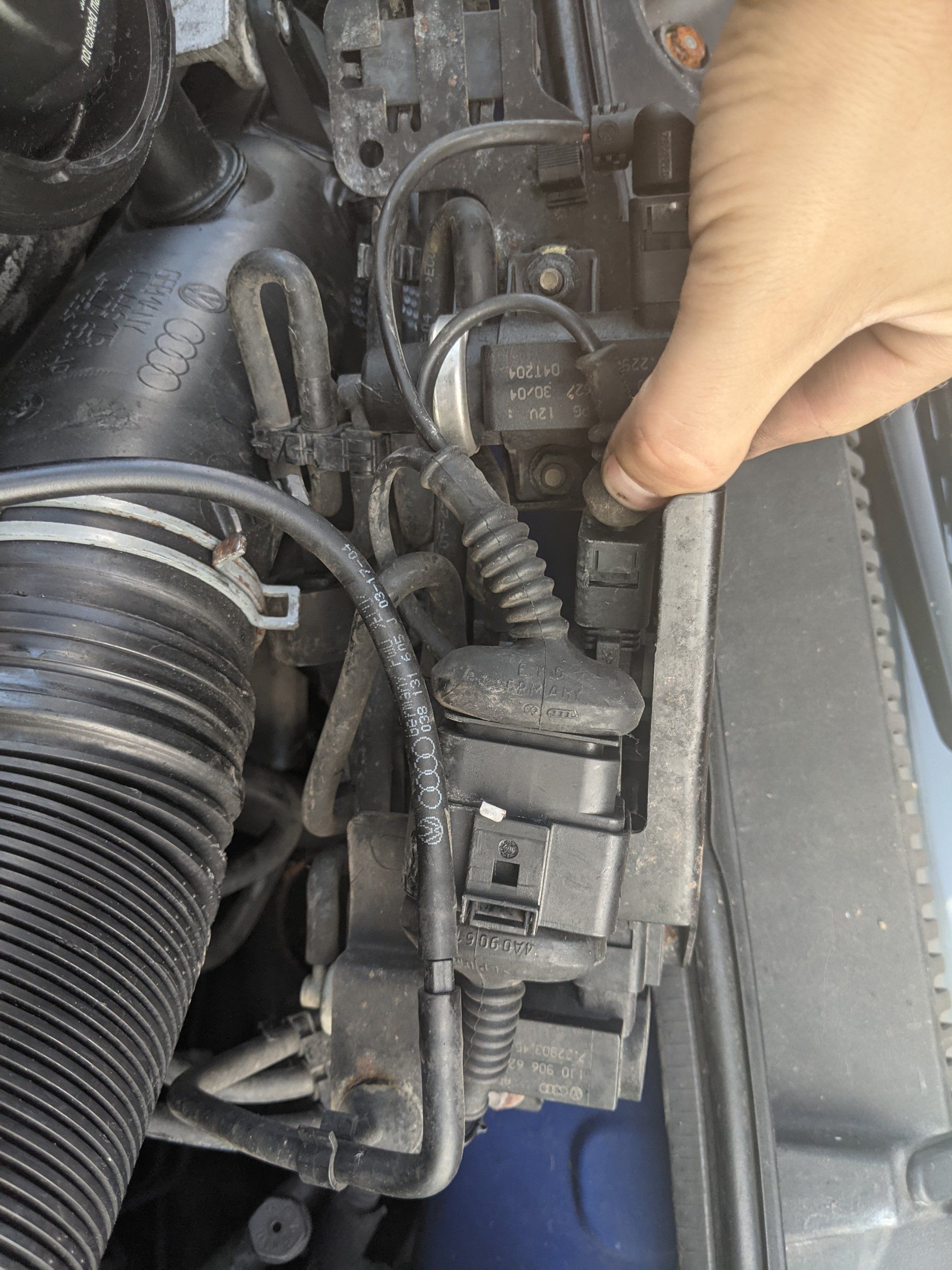

I know it is all blocked up and needs cleaning but the massive power loss that occurred after the engine mount failed points to something that happened suddenly that is causing the power loss, some kind of damage, crack etc. before cleaning everything out I want to locate what is causing the major power leakage
Either the boost pipes from the turbo to the engine are disconnected, or the n75 control lines to the turbo are disconnected. Follow them all from one end to the other. If the car was poorly maintained enough that the engine literally fell out, then there is probably all manner of issues lurking.
Unfortunately been ill for a few weeks and had covid to boot so not been able to work on the car, just taken the EGR valve out again so I could fit it properly, tried revving it and it went above 2k rpm for the first time (albeit with a lot of smoke) in a long time not sure if that means anything to anyone? I checked what I believe is the n75 (photo?)could not see any dodgy connections
