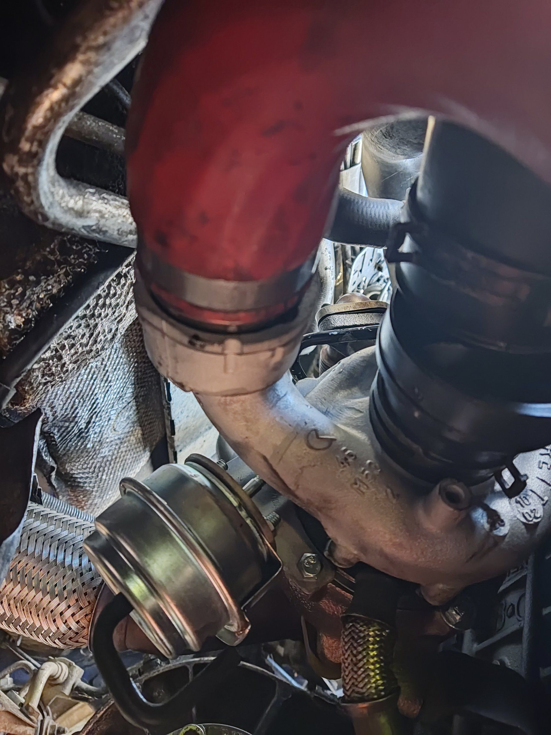

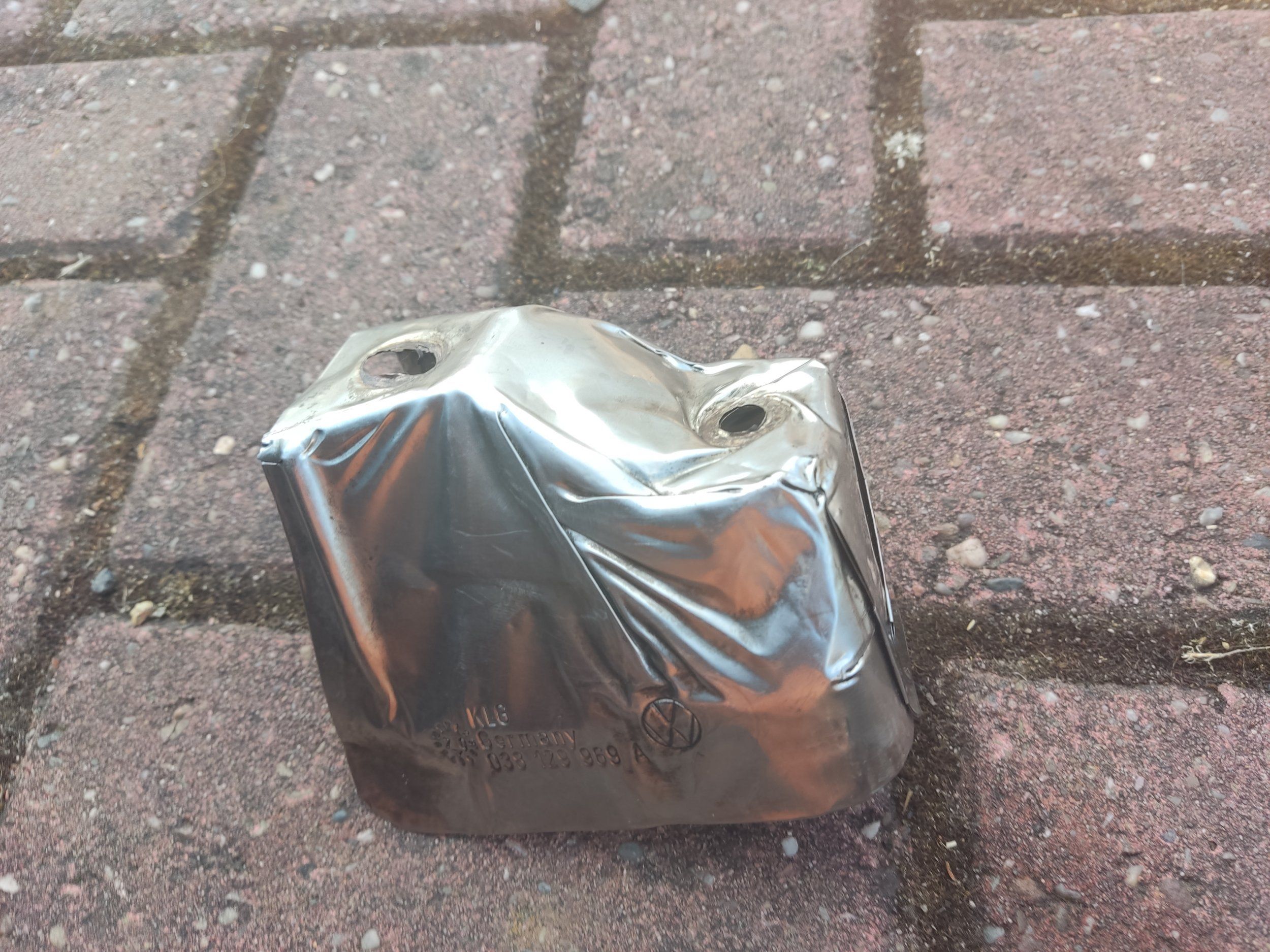

Thanks for the advice, I'm not at that point yet, before I get to that I cannot remember where the heat shield goes! Also this red pipe connecting to the turbo does not seem to go in fully or securely, I still have the clips but no point in using them until it is fully in and secure..

Heat sheild goes on the drivers side of the manifold.
Do you have the horseshoe clip in place? If yes then lift it up, push pipe in (don't have to be gentle), push clip down to lock pipe into place.
I wish I could remember where on the manifold it went, I just remember it falling out somewhere over there, it has two holes so I'm guessing couple of bolts went through it but just can't figure out which ones...

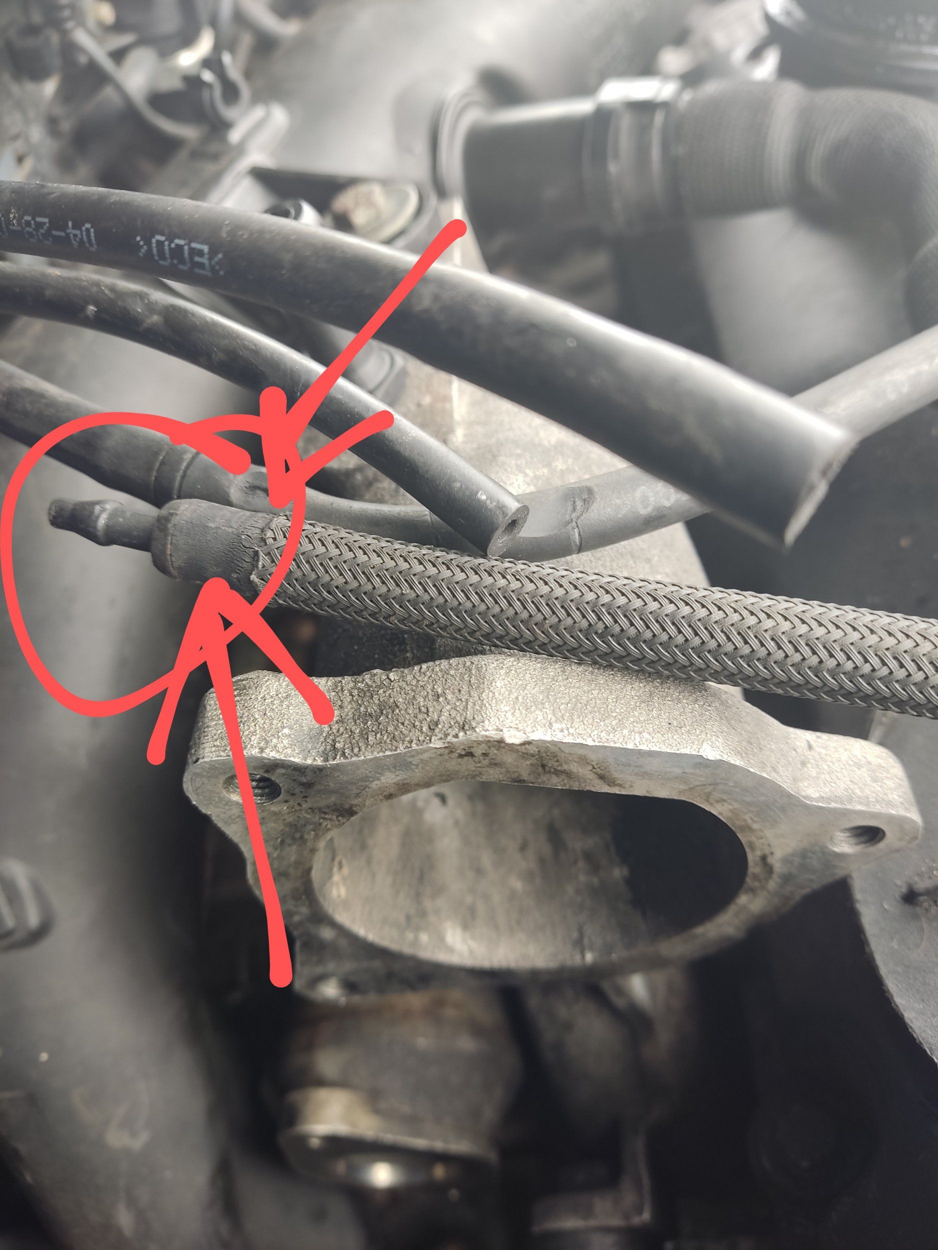

This rubber pipe is split at the end, is it supposed to plug in to this cable (and is that cable damage significant), could I cut off the split section and just stick it in if it does go there?
The pipe is most likely your VNT actuator. It comes in a few pieces as it's one of the longest bits of vacuum hose, going from the actuator, up along your intake pipe and then into the rats nest of vacuum lines on the right of the engine bay.
You can shorten it, but you can buy silicone hose from somewhere like RamAir on eBay for not a lot of money. Off the top of my head I can't remember what size I've got on mine, but I've used a mix of 3mm and 4mm hose when I replaced all of my vacuum lines. I don't think you'd have any issues running 3mm everywhere, but I do know that 4mm is too big for the butterfly/anti-shudder valve on the EGR.

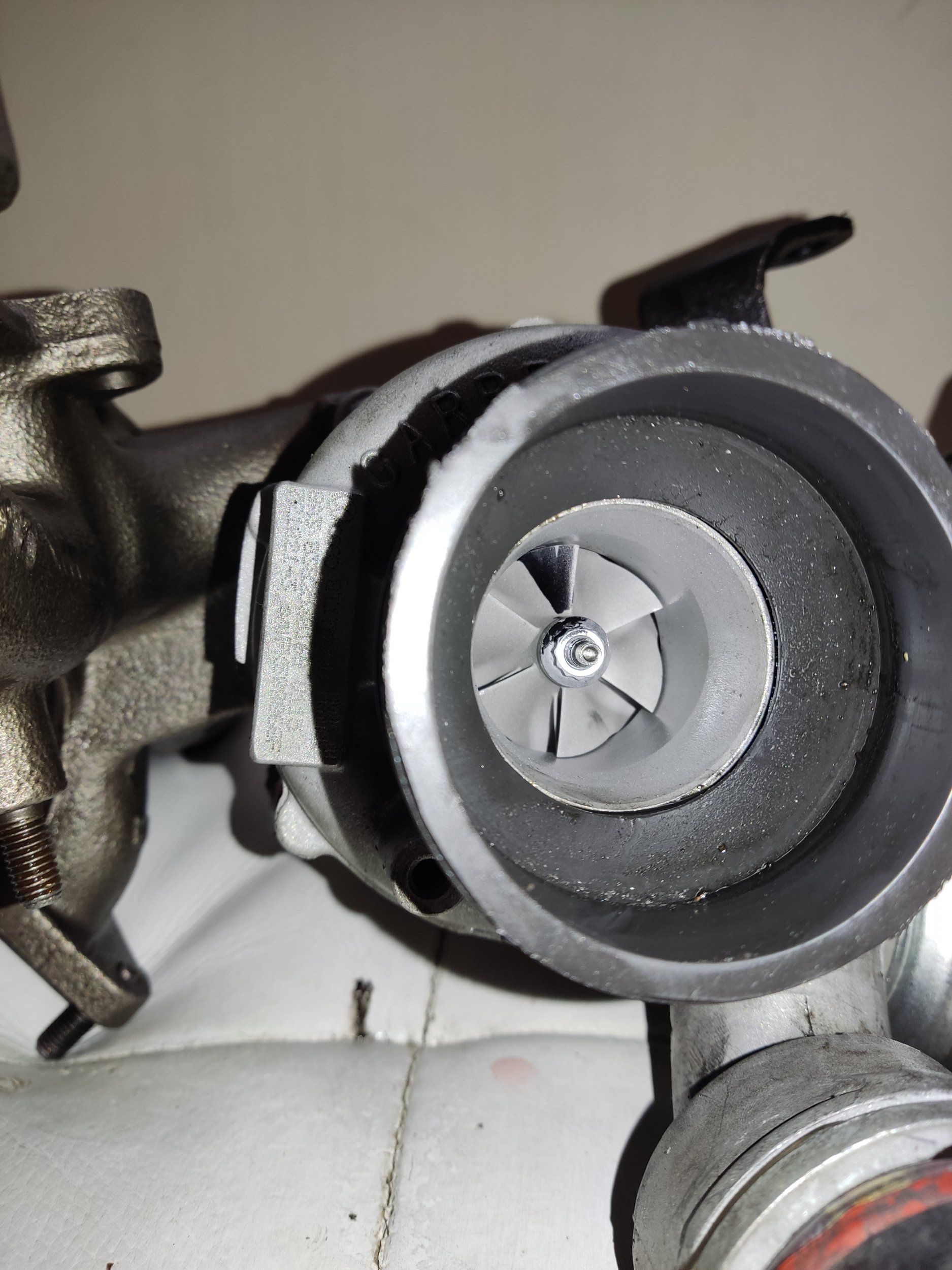

Can't get my hand in there now it's all done up, just turned it over for the first time, bit of smoke and shuddering on starting but seemed to idle pretty normally, gave a bit of gas to try and hear the turbo and it was a bit of a squeaking sound dont want to do more damage if there is a problem took couple video showing underneath and the sound but won't let me upload here, sounded like a frictiony squeak, when I undid the oil return the oil was coming out so there is definitely oil getting there... Any thoughts? Is this normal for a newly installed turbo?
Started again today when at 1.5krpm starts to squeal a bit and gets worse as it revs, i am pretty sure the sound is coming from the turbo, it improved a but after a few tries but the sound seems to be persisting (i have probably run it for about 3 mins total) any thoughts on what is causing the noise or how to fix it?

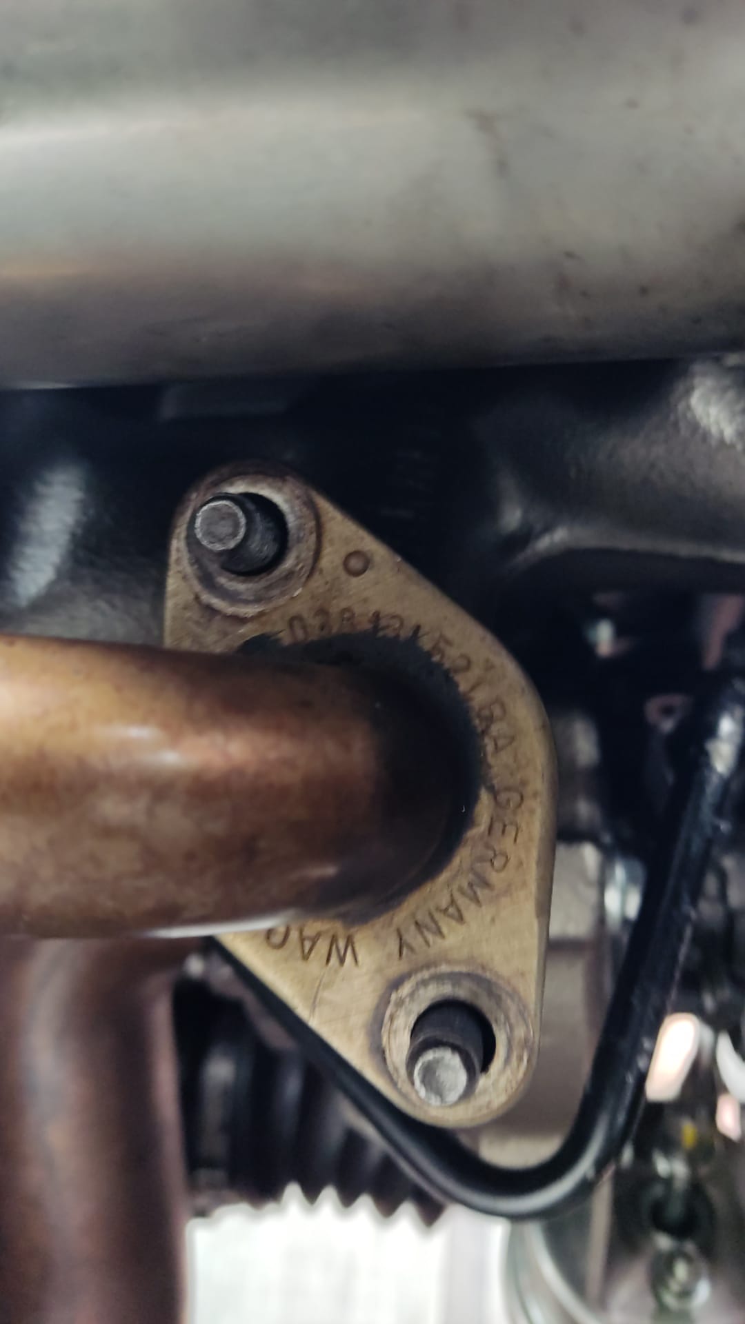

Found out where the noise was coming from, the actuator on the turbo i bought seems to have something loose on top where the noise is coming from under load, also noticed some oil leaking out where a couple of the bolts were not all the way in by the looks of it, main issue is the top of the actuator as cannot drive it like that, have messaged the seller of the refurbed turbo to see what they have to say before I take the whole thing apart again, absolute ball ache, unless someone knows of a way of fixing the actuator in situ?
I have a new theory, perhaps it is not the actuator but right above the actuator there were missing bolts, when I removed the manifolds again there were 2 bolts missing (shown in pic) the gasket there was damaged when I took it off and it definitely was not damaged when I installed it which makes me think that could have been the source of the squealing when revving as opposed to the turbo actuator which only feels a little wobbly but i think that might be normal?
I also touched the turbo to spin it and where I touched it it appears to have turned black, is this a problem?
Appreciate any help, this has been going on near a year now and i just want a working car!

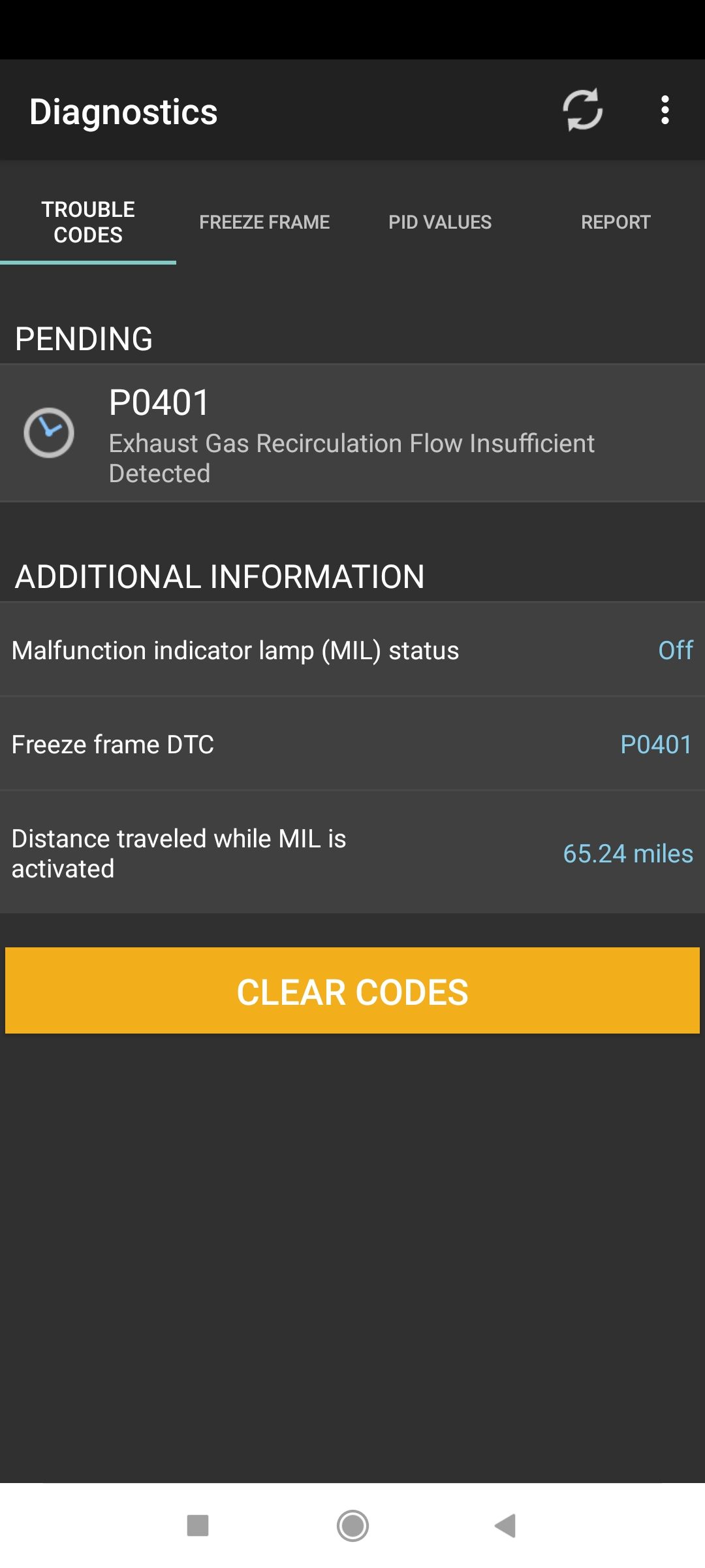

Replaced damaged gasket and bolts and all seems to be working fine, just have the egr error seems to have persisted for a long time but is normal with the 150 pd engines from what I read.
Have you had a go at cleaning your EGR valve? It's an easy job compared to what you've already done - just a bit messy. Well, a lot messy. I've never had any codes about my valve, even though mine was quite blocked, so for it to actually be throwing a code, it's either really blocked or it's something else. I've read that the code can also be caused by a vacuum leak, so it's worth keeping an eye out for that.
Looking at the 'no nuts' picture, it looks like that's the lower EGR cooler pipe? You definitely need a strong connection there as even a small leak can cause some big performance issues. I never gave gaskets and tight fittings too much thought, until I had one allen bolt slightly loose on my EGR valve and I had absolutely no boost pressure and exhaust fumes and smoke in the engine bay.
I wouldn't worry too much about the turbo impeller turning black - with all the exhaust gases that'll eventually be going through there, the turbo will long for the day it only had a little bit of finger grease on it... ;)

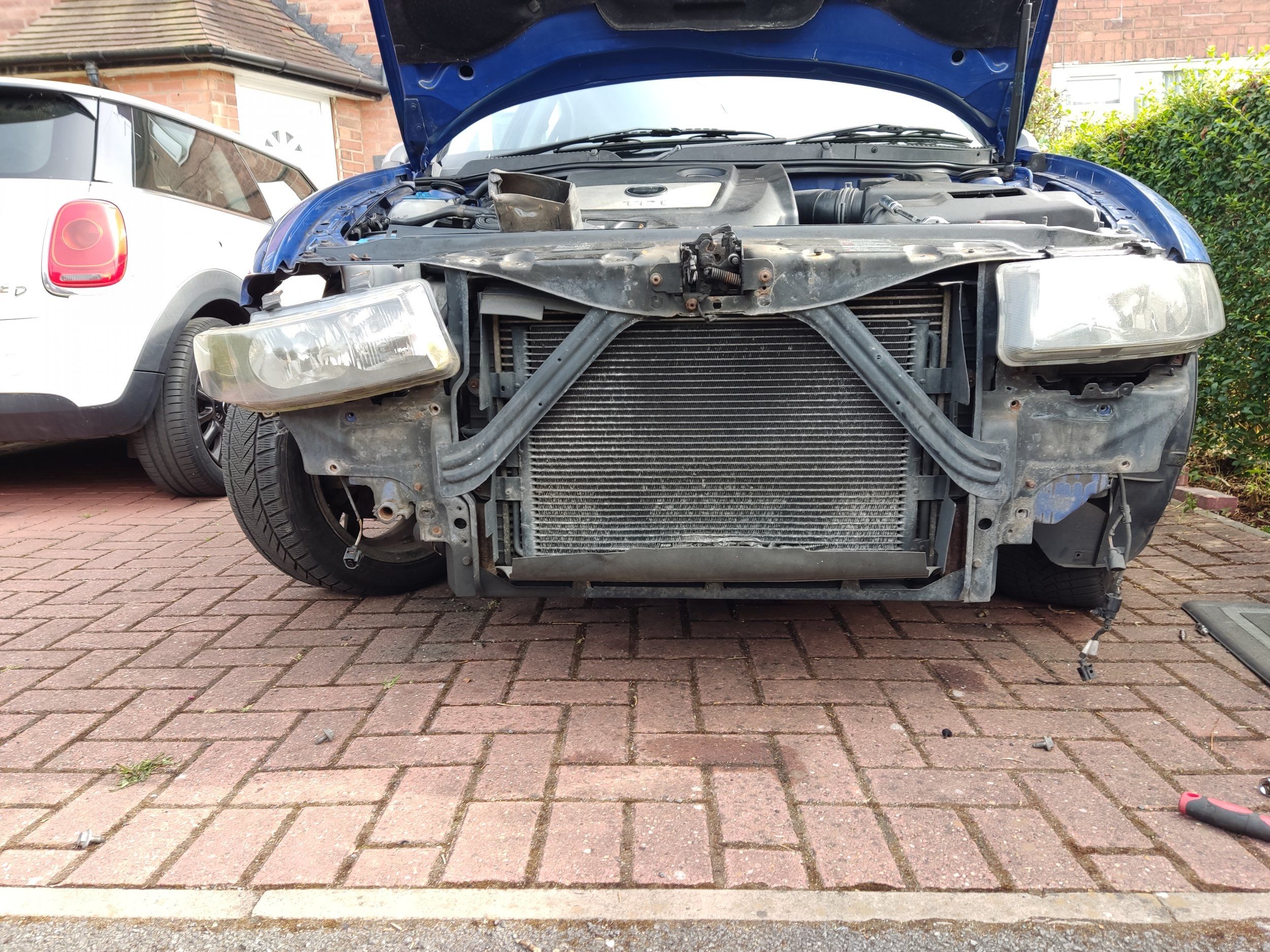

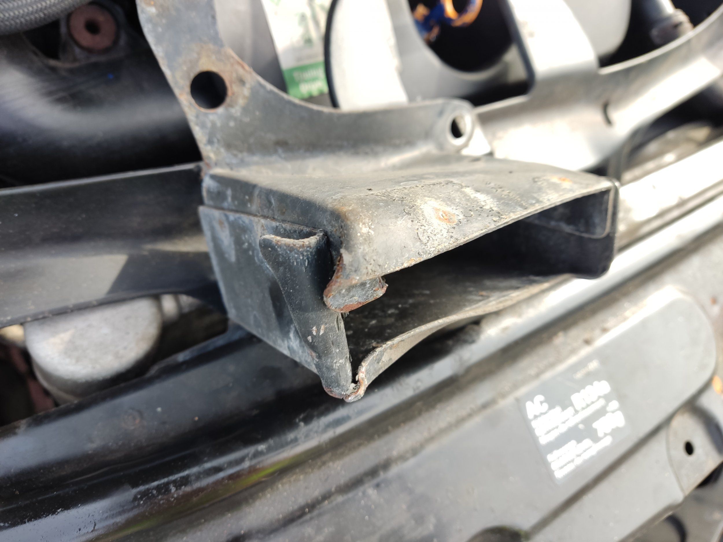

Cleaned egr a couple of times now so pretty sure it's not that, some kind of leak seems quite likely given the state of a lot of the pipework, i have the front off now as there seemed to be significant offside damage which I why I could not attach the offside lamp properly, also can see a kinked pipe underneath I presume as a result of offside contact from the front, and what looks like some radiator damage? Wondering cheapest way to get road legal, although mot said only power steering hose leak(which I cannot find) and insecure headlamp, as the problems at the front (also have to fix binding on the rear wheels but waiting for another wind back tool to tackle that)
