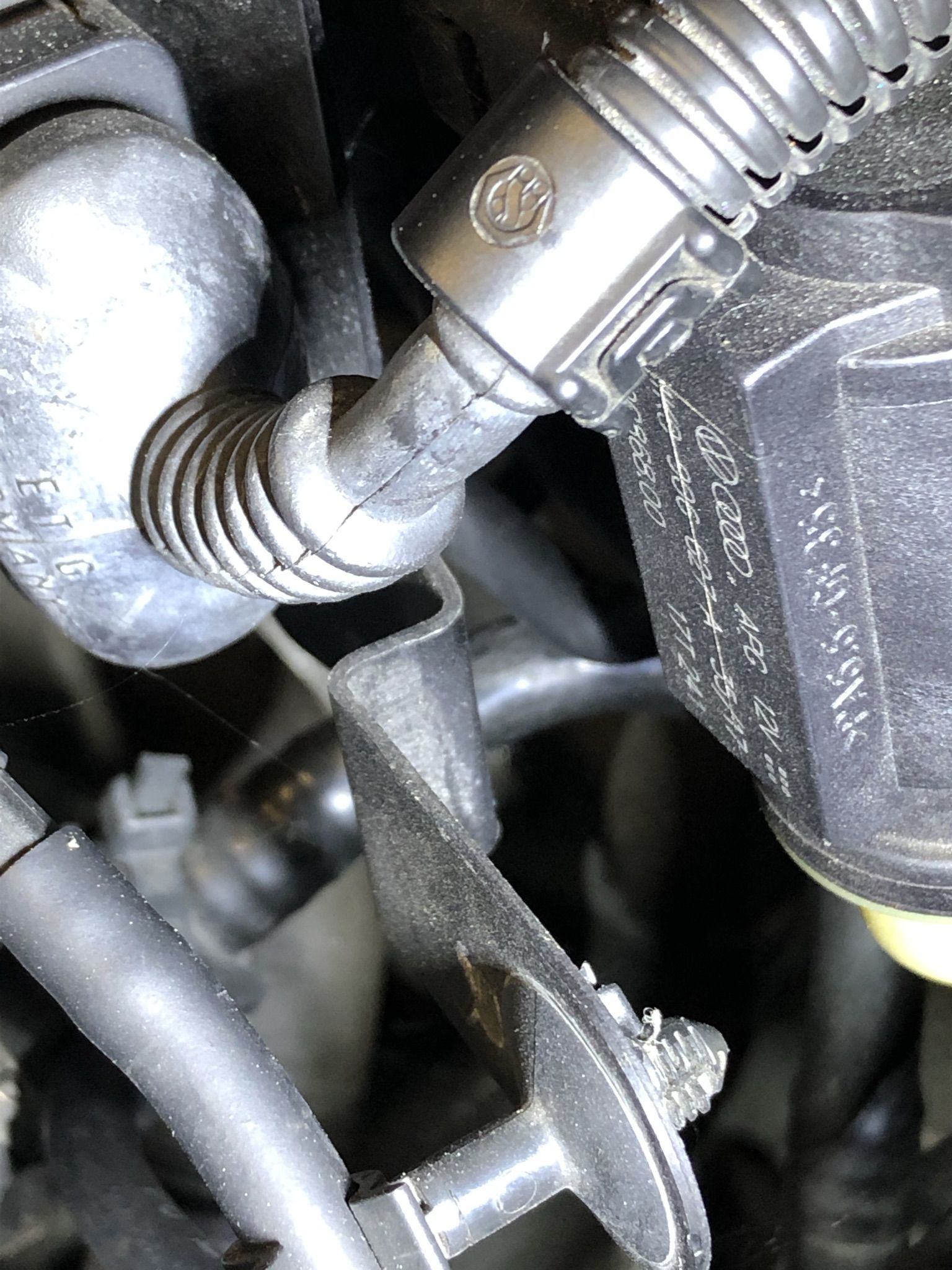

check the pipes to see if any are rubbing though, i noticed one on mine underneath the bracket were too pipes were rubbing together glad i seen that when i did would of been a pain to find.
Not sure what you mean by rubbing together, they don't move, can't see any damage on them
See the tie rap bottom left on zoomed in pic ? That’s pulling the pipe down enough not to rub on the above pipe the bottom one was wearing though , run your finger between them going towards the valves , yours might be ok as I might be missing a clip or something can’t see any holder for it, but tie rap been there for a few years now and fine, was a fluke I found that issue.
Oh yea the first valve you see in pic is the N75

I could not find any problems there, could the reason the car struggles to rev be the cat, or does the fact I disconnected the EGR valve and still could not rev the car rule that one out? Anyone have any experience removing the cat, is there a guide anywhere? Thanks in advance for any advice

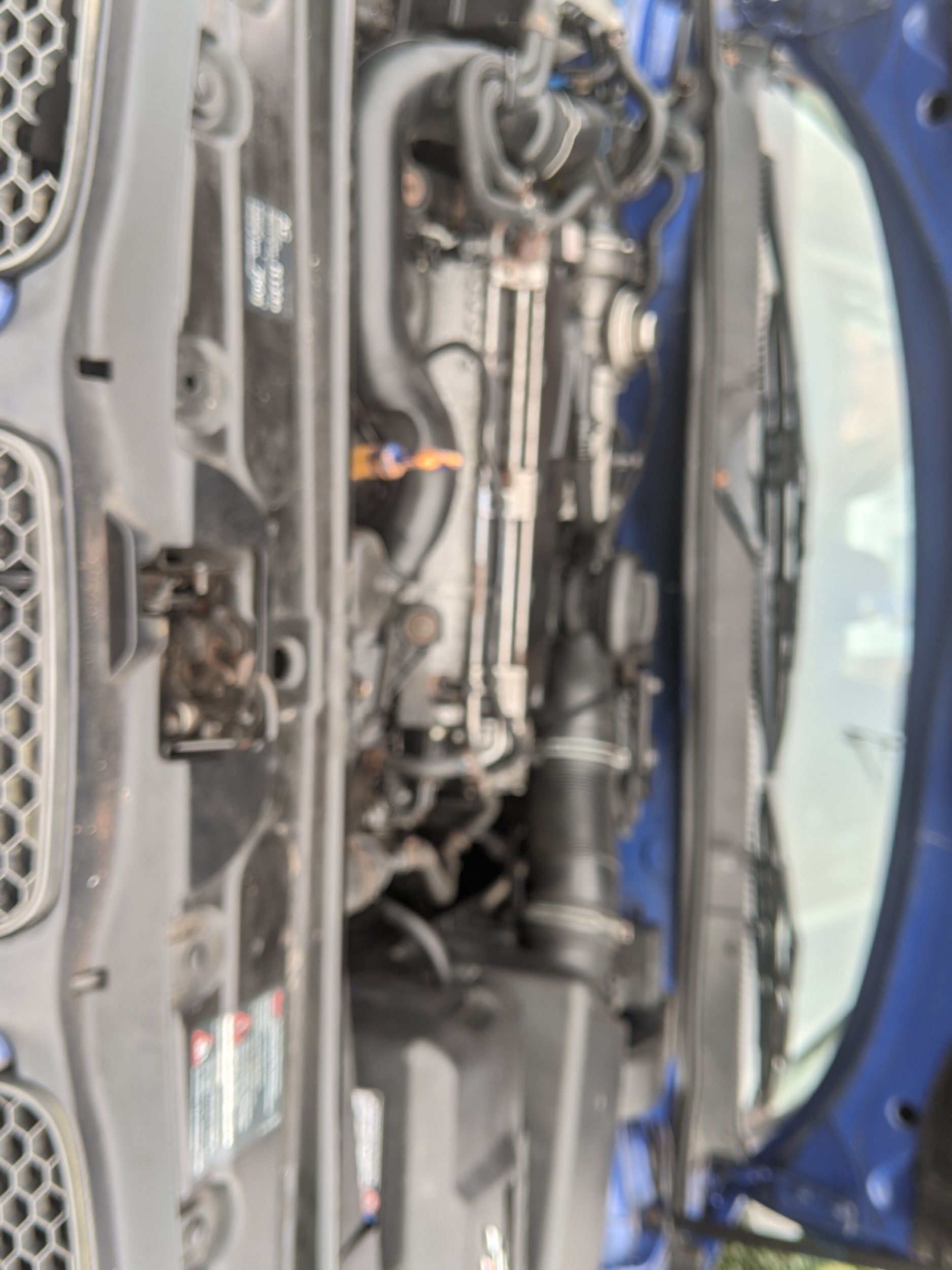

The whole engine appears to be tilted down to the passenger side (the opposite side of the failed engine mount, is that normal?)when I went underneath while the engine was running I seemed to be able to hear a slight knocking sound as well on the passenger side, still haven't been able to find the source of.the power drain, thanks for any suggestions..

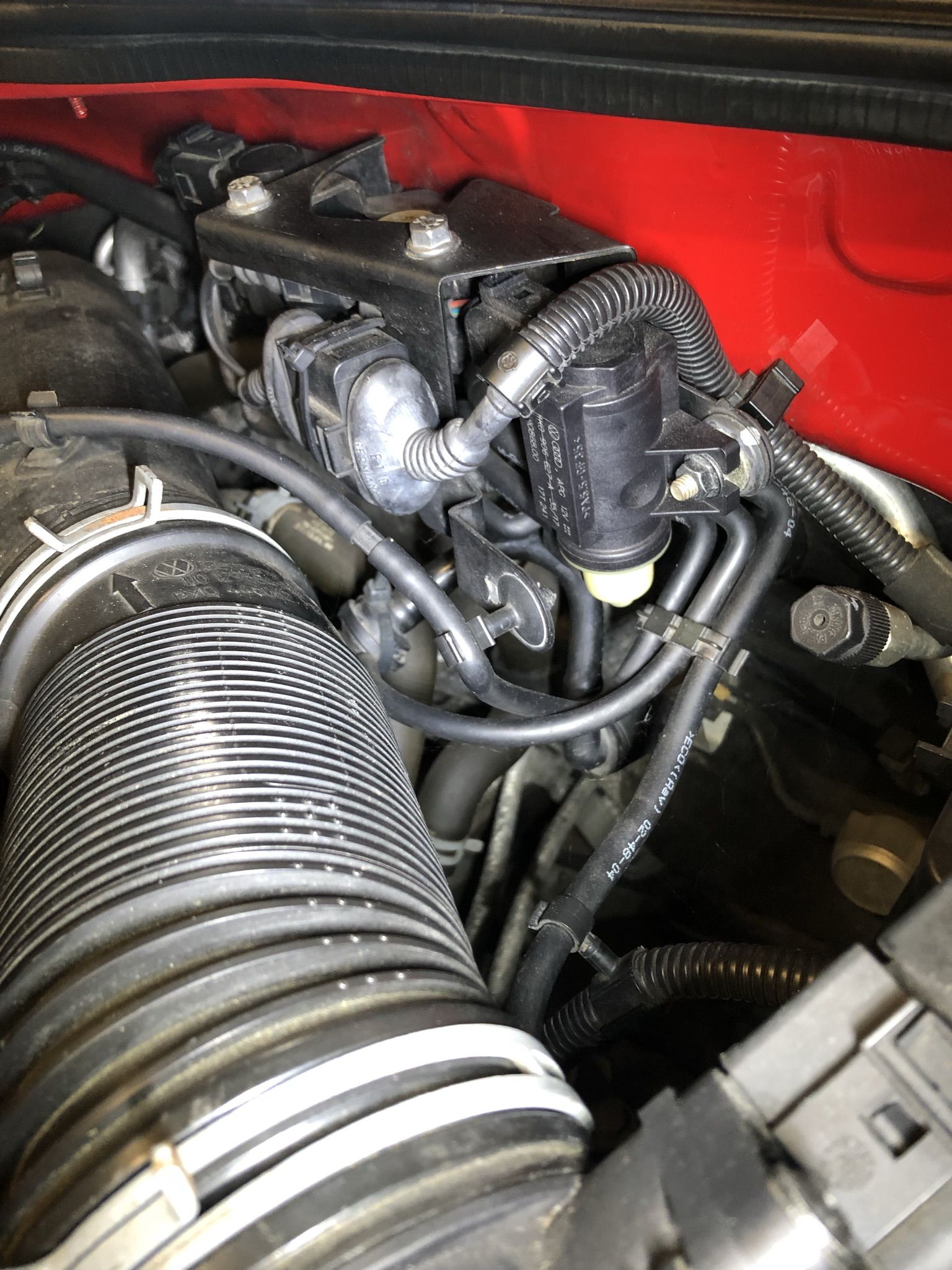

Does it attach here? And would this being disconnected cause massive power loss and the turbo to stop working?

Can anyone tell me what this is and where it goes?
Have you simplified your vacuum system? Because that, to me, looks like the connector that normally comes off the long vacuum line that runs from the vacuum ball at the front of the engine. If I'm right, that part should connect to another vacuum line just where the concertina pipe for the air intake pipe connects up.
I've circled the part I think it might be.
Either that, or it could be the vacuum line for the turbo actuator. There aren't many lines that are long enough to need an extender piece like that, but given the angle of it in your photo, it seems more like the vacuum ball one.
Sorry - looks like we were both posting at the same time. Yes - that's probably the turbo actuator line.
With it disconnected, the turbo vanes won't be opening, which is why you're down on power.
If you've been driving with it like that (or trying to) maybe check the lines to make sure nothing's been sucked in. It's unlikely but just in case.

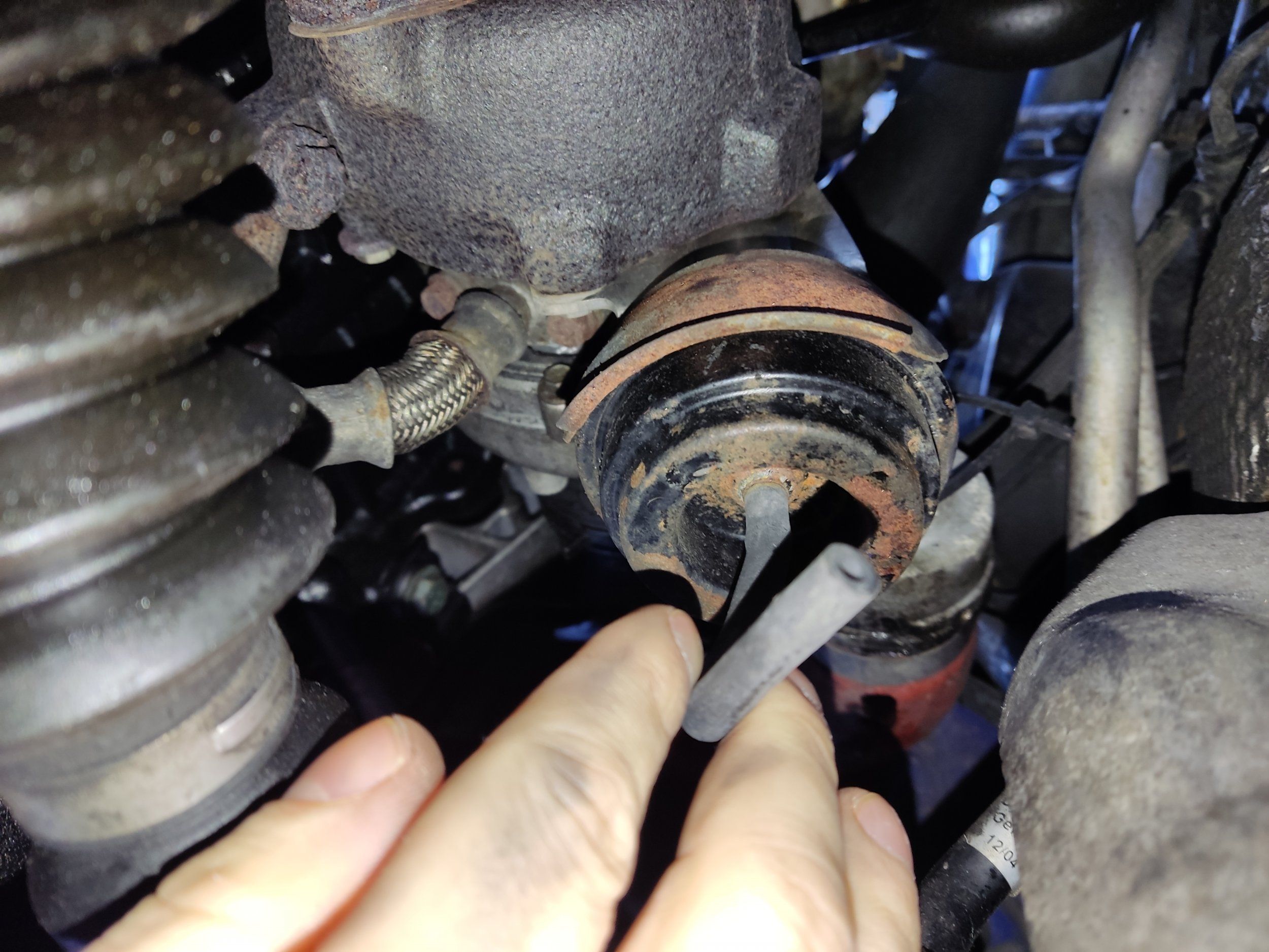

So after months of having a pretty useless car, this simple cable seems to have been the main culprit, not taken the car out for a spin but if anyone else has this problem this connection is not particularly strong and easily disconnected...
Don't get me started...! I'd say 99% of my problems aren't anything major, but involve loose boost pipes, worn hoses and repairing crap work done by garages.
I started replacing all of my vacuum lines because a garage hadn't clipped the turbo actuator hose back into the clip on the TIP, and so the heat of the EGR valve wore a hole in it. I find that if they come off easily, 3mm silicone hoses work pretty well.

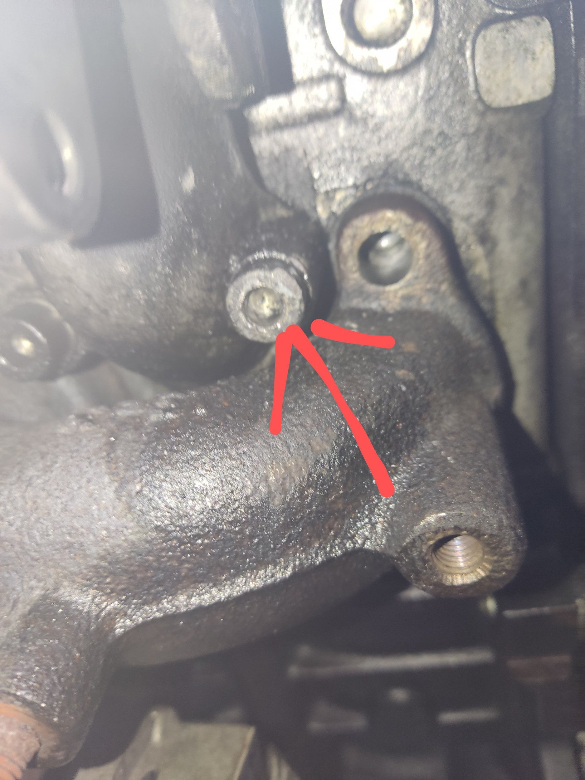

So decided to have another go at it and try and get the turbo/manifold off, kind of wishing I never started as all the bolts seem to be rusted/seized although I have taken managed to take a fair bit off including the egr, large exhaust pipes etc one allen screw is absolutely wrecked after overtorquing it and it's now and is now more circular than hexagonal as far in as it will go, not sure how to deal with that now?
There seem to be a couple of other bolts that seem almost impossible to get and are no doubt pretty rusted too, not sure if even needed fo removal any help much appreciated!

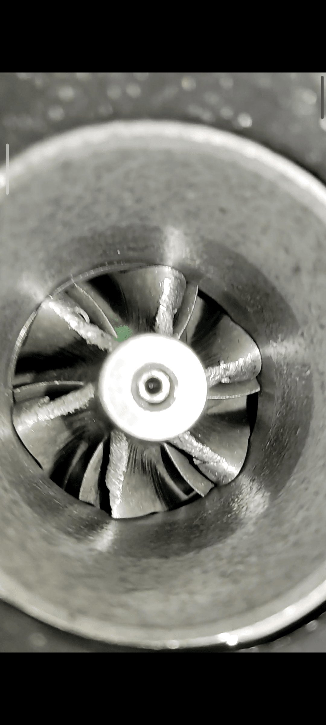

N.b. added a photo I managed to get of inside the turbo, looks damaged to me, thoughts?
The turbo is very damaged, may want to see if you can spin it by hand (wear gloves!) to see if that's why it's not boosting
I cannot fit my finger into try and spin the but at the front seemed loose and seemed to spin though, pretty sure the whole housing has been somehow.crushed by the looks of it and seems to be significant damage on the blades so I would imagine it needs replacing and is hopefully the only cause of the lack of boost.
