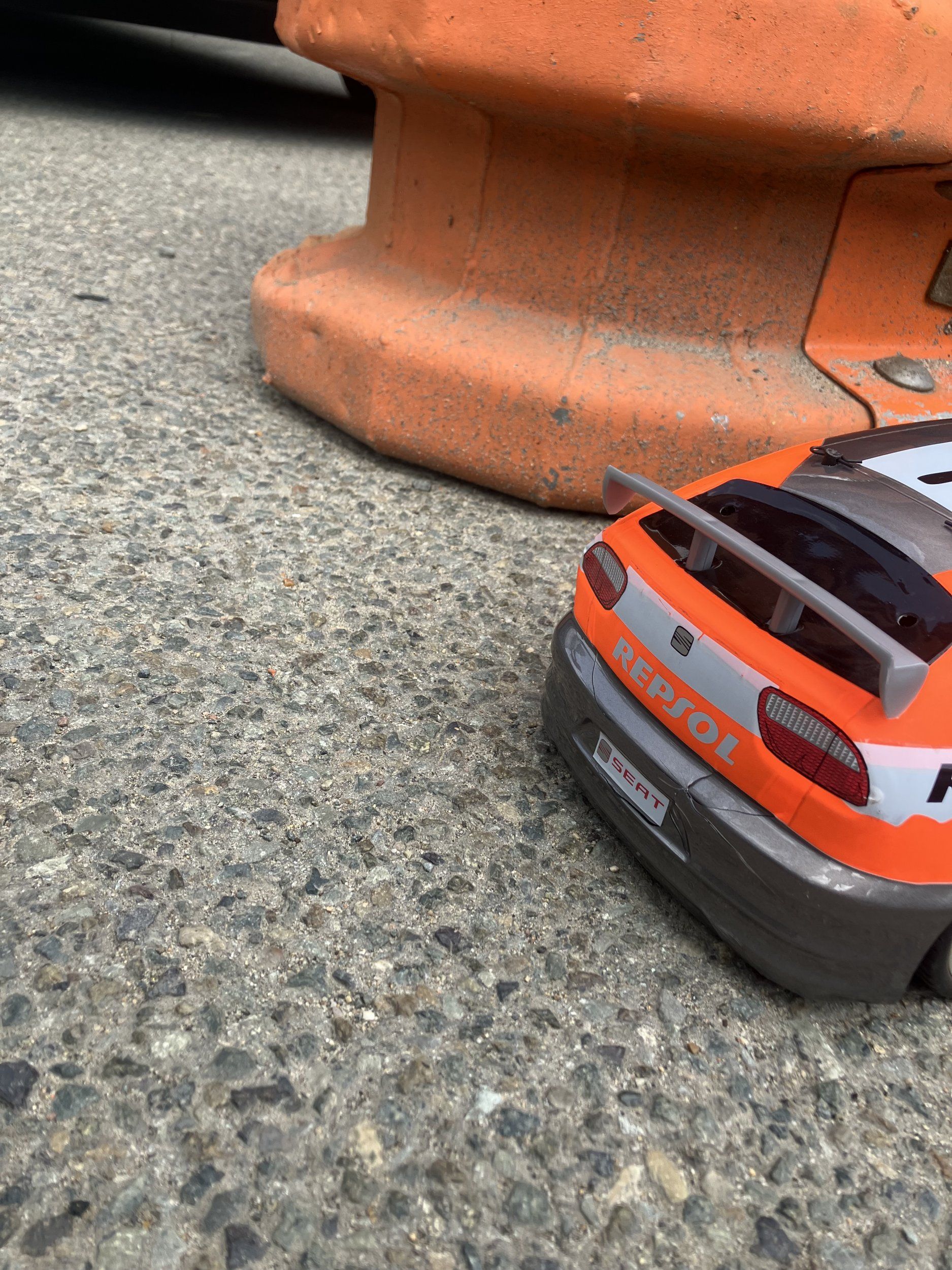

Damage and the barrier that was in the wrong place.
:banghead:
:banghead:
:banghead:
repair it with the same fibreglass two pack filler you use for car bodywork you can even get a two pack plastic filler
