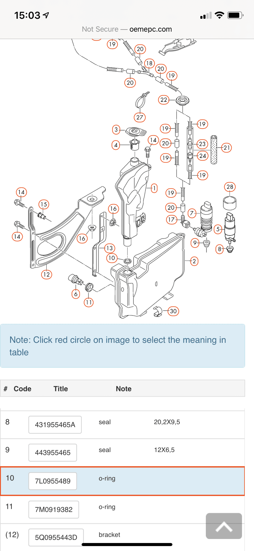

Now noticed the washer bottle is leaking I think it’s the seal, ordered from alliexpress with some other bits to get free postage
Part on 443955465. Got two £1.09

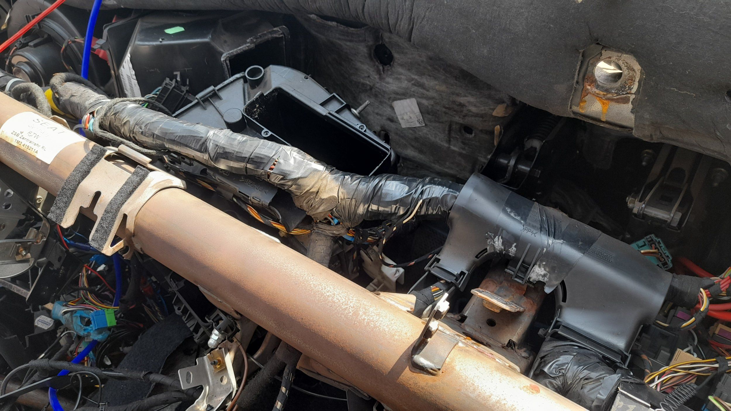

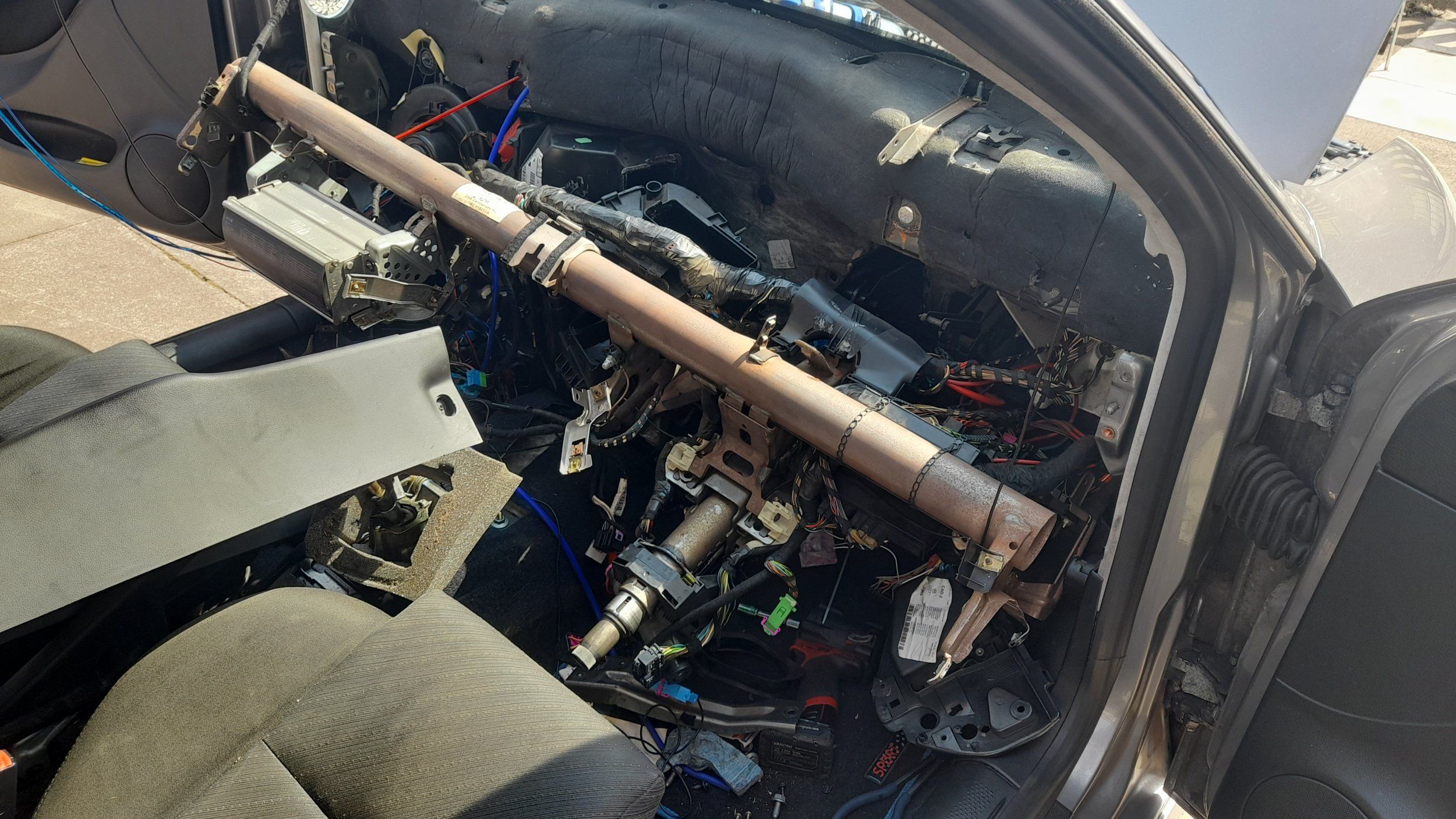

managed to get the old one out without degassing the ac, been a total nightmare, looks like a bomb has gone off inside lol
new part comes tomorrow, the refit job should be fun......

ExiledWeegie
Jun 15, 2024
132
93
Fife, Scotland
Wtf we’re was the matrix
in the black rectangle hole, its at the furthest back point of the whole dash gubbings, stupidest place to put it, the mk2 is so much easier to get to, in fact every other car its so much easier to get to but vw/seat had to go full retard and stick it so far out the way.
Jesus! And I think: how on earth are you getting to assemble all that? If it was me, in the end the headlights button would turn on the wipers :LOL:

operation washer looks like pump is internal rusting it is the original though, ordered a new Febi Bilstein 26259 £10.18, seen vw want £90 and that's on offer from £120 lol

ExiledWeegie
Jun 15, 2024
132
93
Fife, Scotland
thats dash removed and the problem was the main loom, theres a plastic cover that goes over it thats like a u shape, it fits around the crash bar at the steering column, it had moved and was jamming the brake pedal, my advice is if you ever need to do this job cable tie as many wire bundles and the main loom up to the bar before you start so that it goes back in roughly the same position or its a nightmare.
i ended up with 6 bolt/screws left and 2 small brackets, i know exactly where they go though and might consider putting them back in at some point, the places they are arent anything structural and the dash is solid without them.
what a job though, dont fancy doing that again. (let alone twice!)
