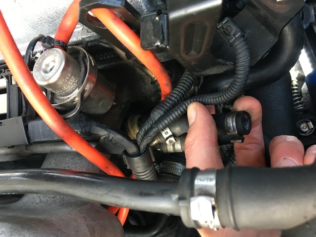

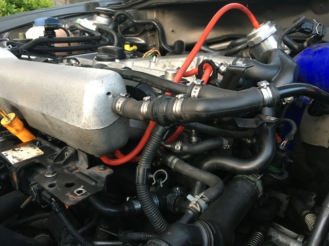

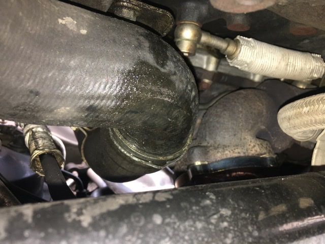

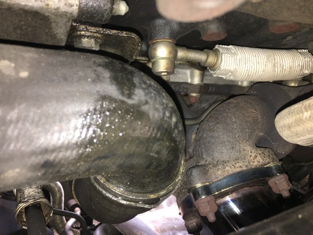

Be ready to replace the turbo. Oil will be leaking from the seals. I've had a few 1.8t and 1.9tdi and any oil in them pipes or around the joins means turbo failure is going to be an issue soon.Rooting around the inter cooler pipes and noticed what seems to be a lot of oil on the pipe just beyond the pancake pipe. Is this abnormal?View attachment 13779 View attachment 13780
Second possibility could be and it's a long shot....turbo went....was replaced...but pipe work wasn't cleaned out. I've clean up pipework after a turbo went and it's not nice but fairly easy job so anyone replacing it would have taken the pipework off, unless told not to bother to save cash.
Wip of the hose...see if you have play, ..check for in and out mainly, slight movement? Shot seals and oil will be leaking from there into the pipework into the intercooler ect ect. Most cars that have a blown seal smoke a little, maybe off boost maybe on boost or spool up but it will smoke maybe only a little bit...more smoke, more damage to seal.

Funny really as it was white. (1.8t) many mechanical men says it's normal...I've met a few...oil isn't mean to come out of anywhere. No TDI left the factory like this and it doesn't go like this over time, Garrett never did this as a feature. seal is about to give way or has or has in the past. If an mot man see's it he may have a fit with the new mot laws. May not be leaking but shows signs of it so really should fail because it won't get any better and may fail and throw oil on the road.What colour smoke? I've never had even a puff off blue smoke that i'm aware of. I will recheck the pipes for play, from what i gathered it seems like everyone has a little oil in there. Previous owners were certainly not enthusiasts, so i doubt that pipe ever saw some rag before then.

Hahah go shopping in it.Sounds like something I need to keep an eye on - at least I know there will be people here who will know how to repair or replace if it does go. Is it something that can be repaired or will I have to buy a new turbo?
At the moment, the main thing I've noticed (and actually only in the past few weeks after I replaced the turbo actuator vacuum hose) is that I've had some smoke on acceleration when the engine is cold, but that there's been none of the other symptoms. I check the oil regularly and I've not seen any drop in levels since I did an oil change in July, so it doesn't look like I'm burning through oil, and there are no engine lights either.

You can replace the inside of the turbo, badger5 sells them for half the price of a new turbo but having it fitted, balanced, price will go up.
I'd take the pipe off and have a feel of the wheel. Any play...replace.
More play there is...sooner the replacement is needed.

£200/£300 ish . If it's not smoking, leave it, when it starts it will still drive. Treat her nice, she could go on for another 10k if driven ok.I'm in that fun position where I'm self-employed, had a fairly good run these past couple of months, so can survive for a little while, but am stuck asking whether a turbo rebuild is absolutely necessary right now, but also asking whether I can afford a replacement turbo if it totally gives out and I can't drive to any jobs...
How much am I looking at for the kit? Looking at Badger5, I'm guessing it's one of their CHRAs?

Yes, i also need to check my turbo for play as advised, little bit nervous though. If its ****** its a big expense that will hold up pretty much all the other expenses i have on hold lol.
Im still using a scissor jack to get it on lowest setting on axle stands, PITATook the car out today to pick up a few things and kept an eye on the rear view mirror when I was accelerating. When the engine was cold, high revs in a low gear did see a little white/grey smoke out the back, but once the engine was up to temperature, there was none at all.
No trouble with acceleration and I could hear that the turbo sounded normal, so fingers crossed we're not looking at a turbo rebuild.
