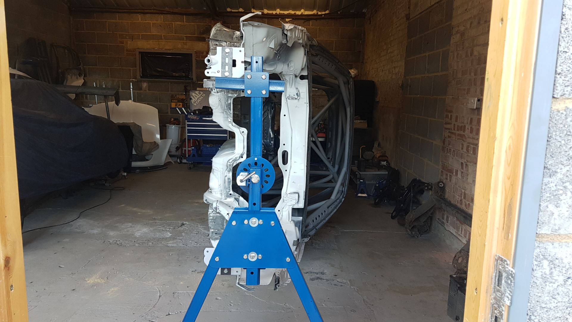

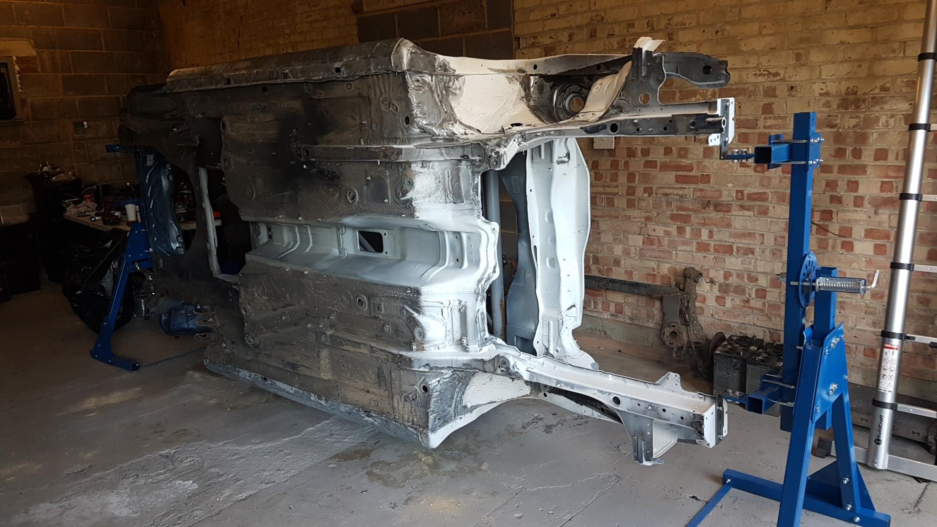

I rolled it ........
Well finally on the spit... now the fun starts with the wire wheels to remove all the sealer
