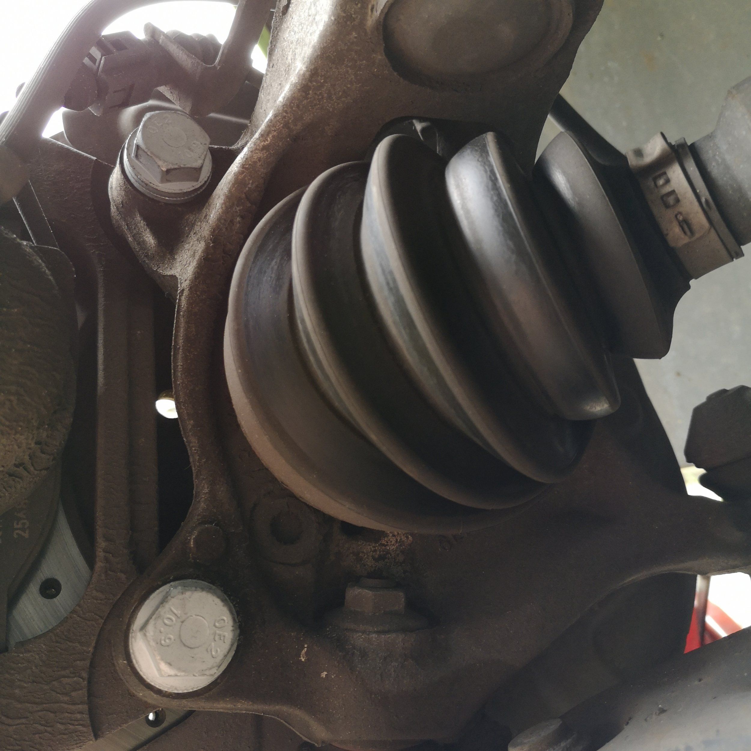

Finally replaced the original caliper carrier bolts today after upgrading the front brakes a couple of weeks ago. Don't reckon it's necessary but VW say it is so hey ho ?. If anyone has 312mm discs and wants to replace theirs, DON'T buy the seat ones, all the car websites I looked at sold the wrong length, you need VW part number N91084901 which are M15 x 55mm, not M15 x35mm:
