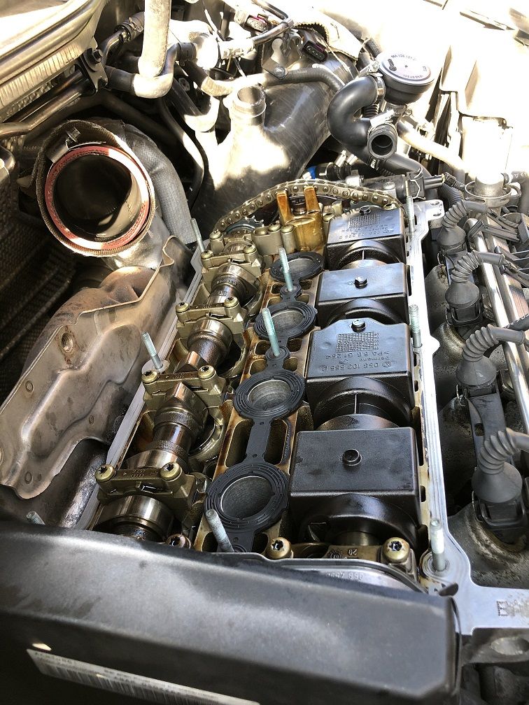

Replaced my valve cover gasket. I had visions of it being a fiddly job, but it all went pretty smoothly.

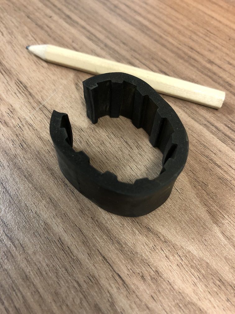

Biggest pain in the bum was getting the cambelt cover back on. Whilst doing that I found this item near the engine mount. What the hell is it?? Too short to be the cambelt!!:ROFLMAO: Is it some sort of hose tidy?
I’ve no idea what it is.
Check one of your kids toy caterpillar diggers Is not missing one of its treads. ?
Reactions: Woody_72 and g60stu

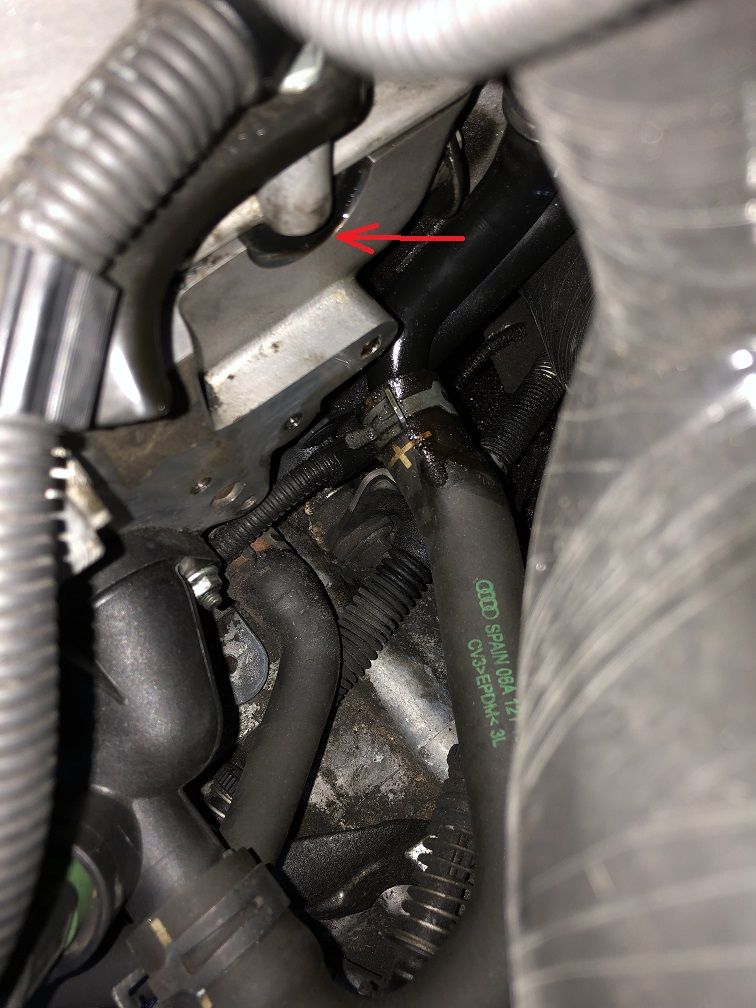

That piece of rubber usually wraps around the the AC line on the offside chassis leg to stop chaffing.
If I remember correctly there's also another one on one of the power steering lines as well.
I'm getting mine done tomorrow because it's weeping oil. Did you have any particular symptoms?
Yep, oil drips on my driveway. It was leaking out of this halfmoon section and rear corner on the right hand side of the valve cover. Oil all over the gearbox and undertray.
This photo was after I had cleaned it up and the day after had literally moved the car on the driveway for 30 seconds.
Annoying because I had this gasket done by a specialist last year. I'll be keeping a close eye on mine for a few months.
