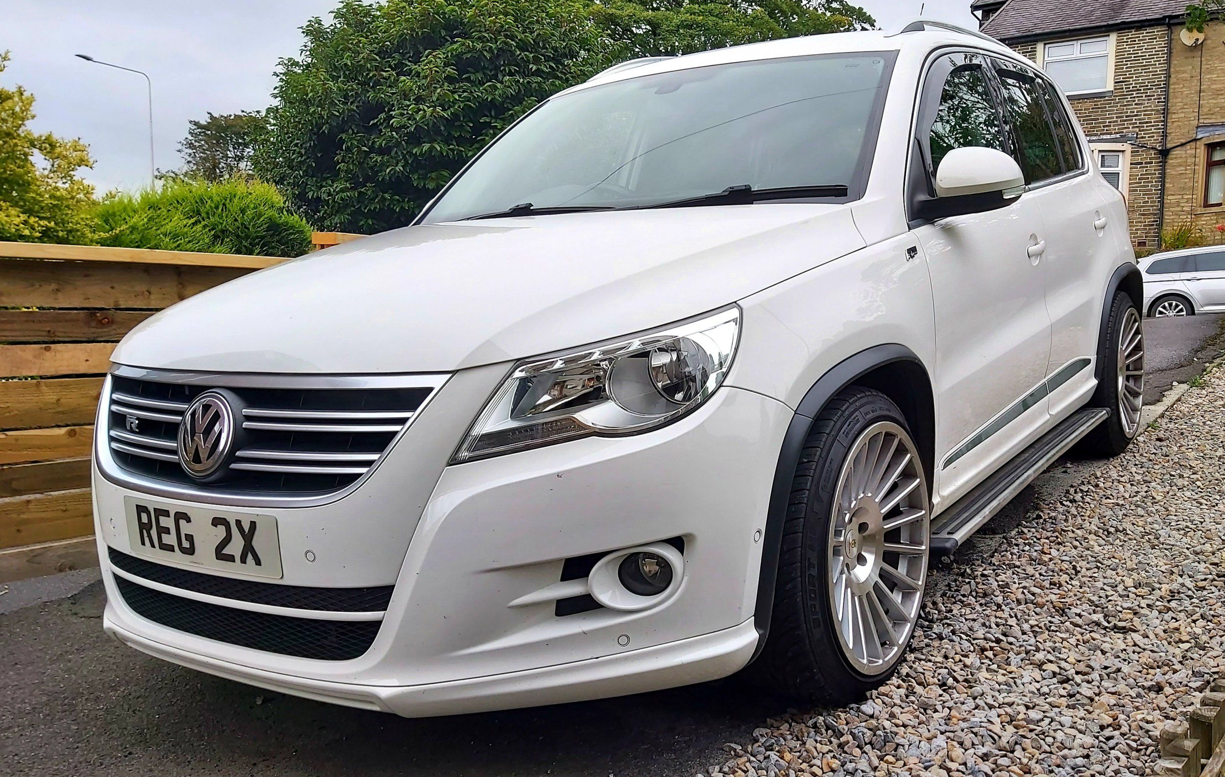

Black does look awesome when its freshly cleaned up.
Sent from my SM-G986B using Tapatalk
It really does. I waxed mine yesterday and it looked great. Unfortunately living in Somerset there is fresh sh8 everywhere and now it looks like an old banger again :(

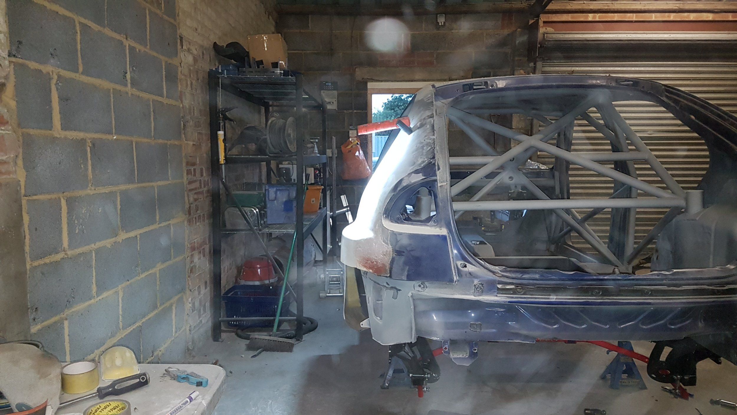

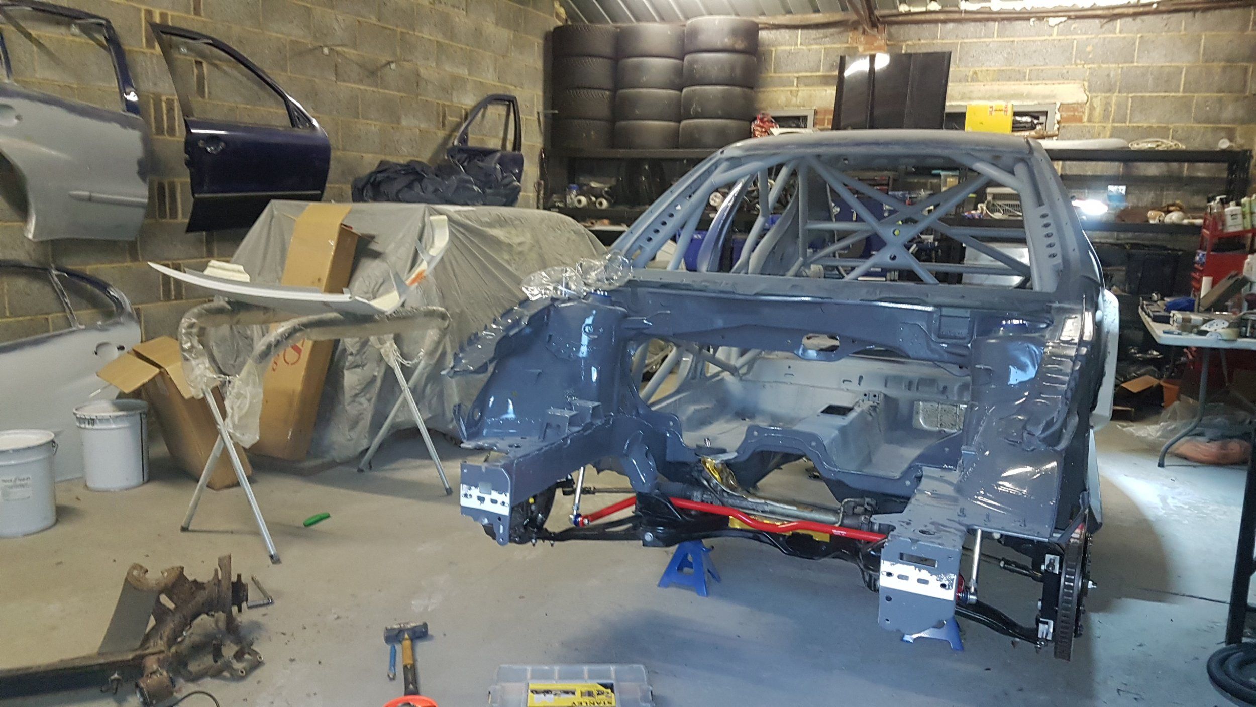

I would do rotten things for this set up. I need to strip my car down and go through all the niggles but I don’t have access to a garage
Same. The things I'd do if I had the space. Where I live I'm on a one way street, so on one side I'm playing in traffic, and on the other side I'm having to get out of the way every ten seconds because I'm on the pavement. I have to go to my parents' house if I want to do any proper work, only they live a hundred miles away, so it's not ideal...
I guess you don’t want to see my set up
