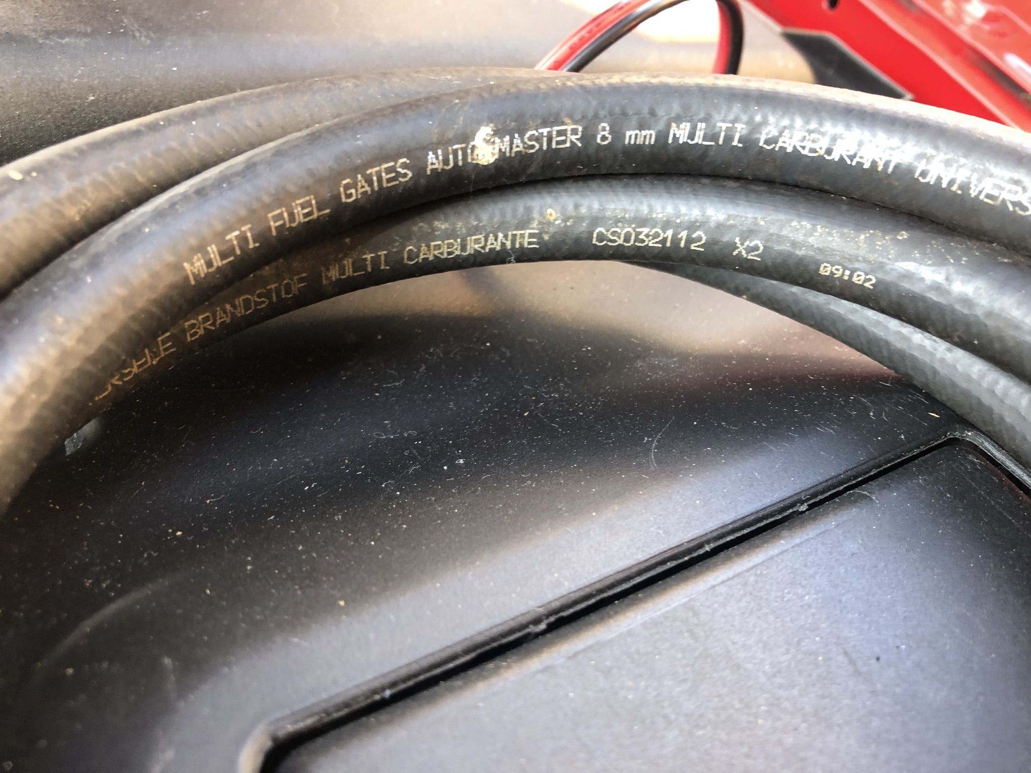

Replaced that top hose a while ago and it’s not a separate part you have to buy that pump thing it’s connected too, i bought separate gates fuel hose and cut to length

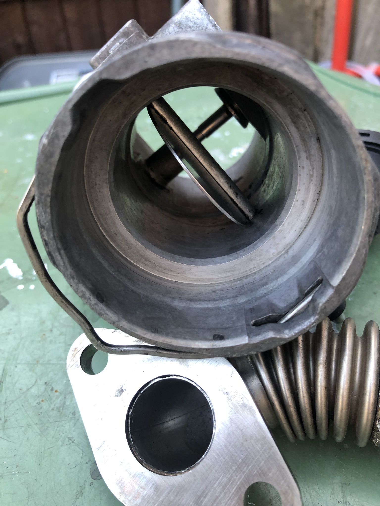

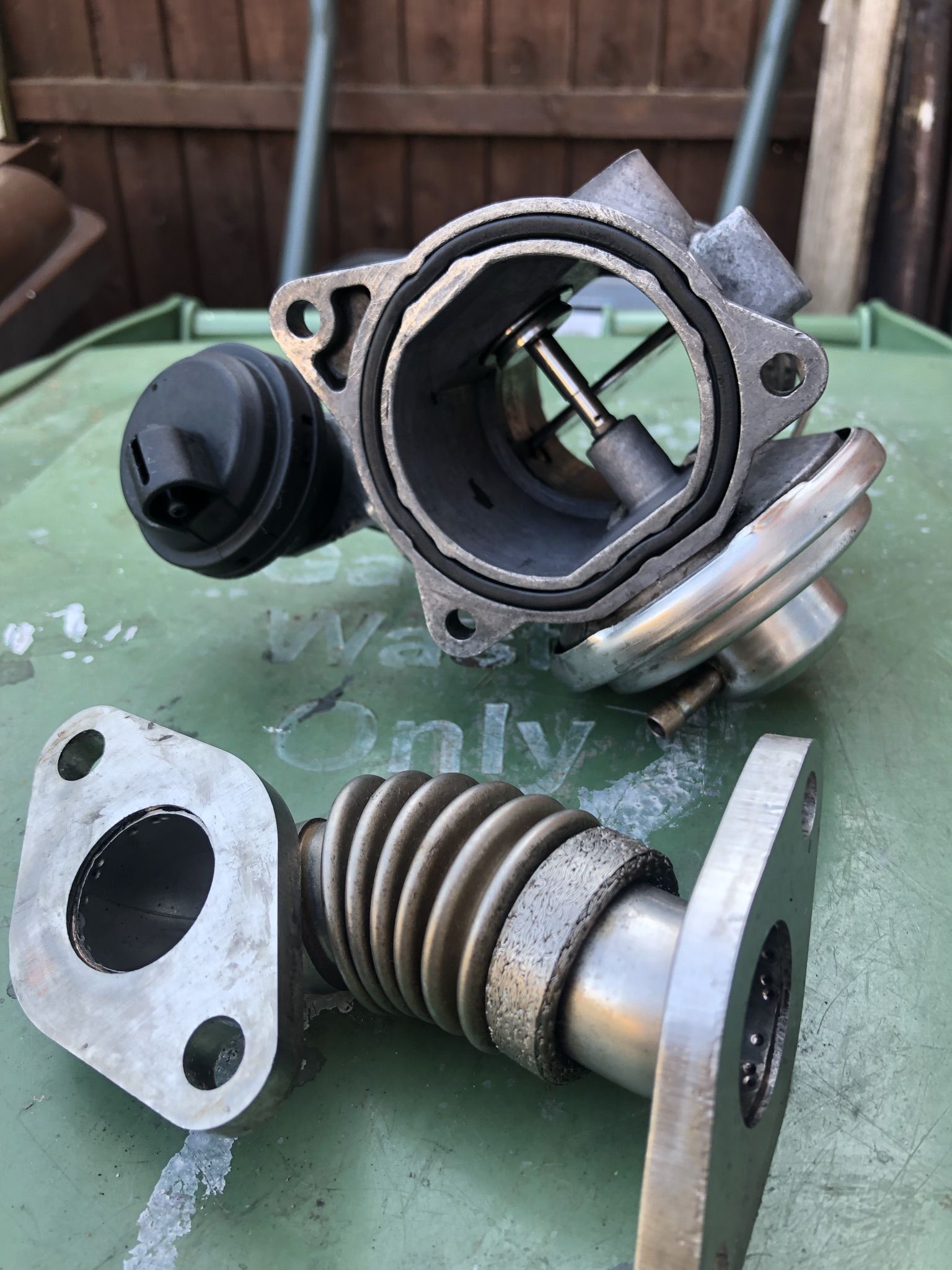

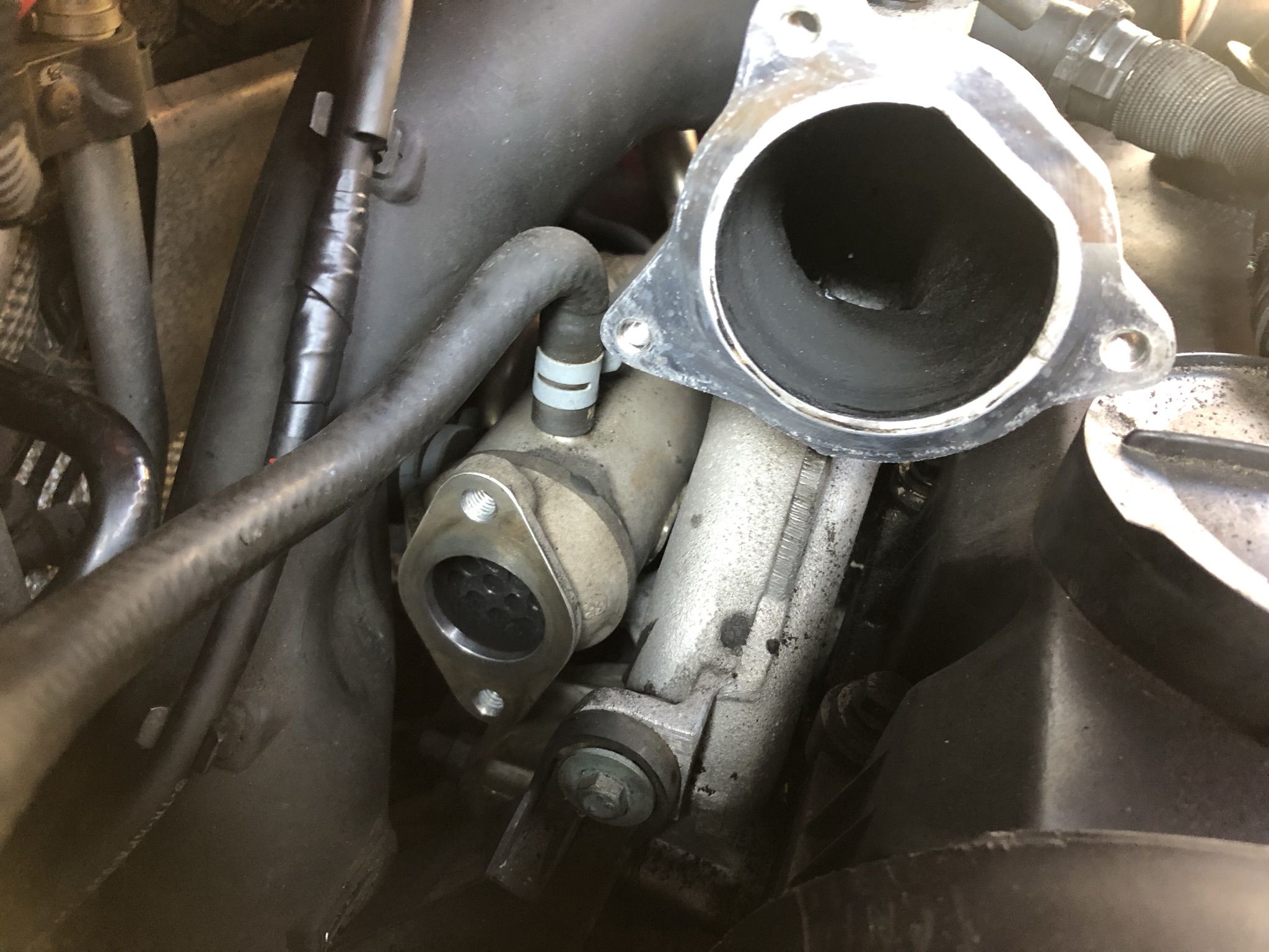

Amazing what cif oven cleaner does, mad never used it before, manifold don’t look all that bad as well been a while I took egr off as well, glad I removed egr as well as I seen a breather pipe wearing though or heat, used self amalgamating tape and insulation tape for good measure lol clipped the thing back on as well.

That turbo actuator vacuum line is a nightmare if you don't clip it back in place. When I did my cambelt, the guy who was helping me didn't put it back, and it ended up sitting against the EGR, which basically melted it through. The line itself isn't that hard to change, but it's easier to do from under the car, which of course means you need to jack it up and all the other nonsense that comes with that.

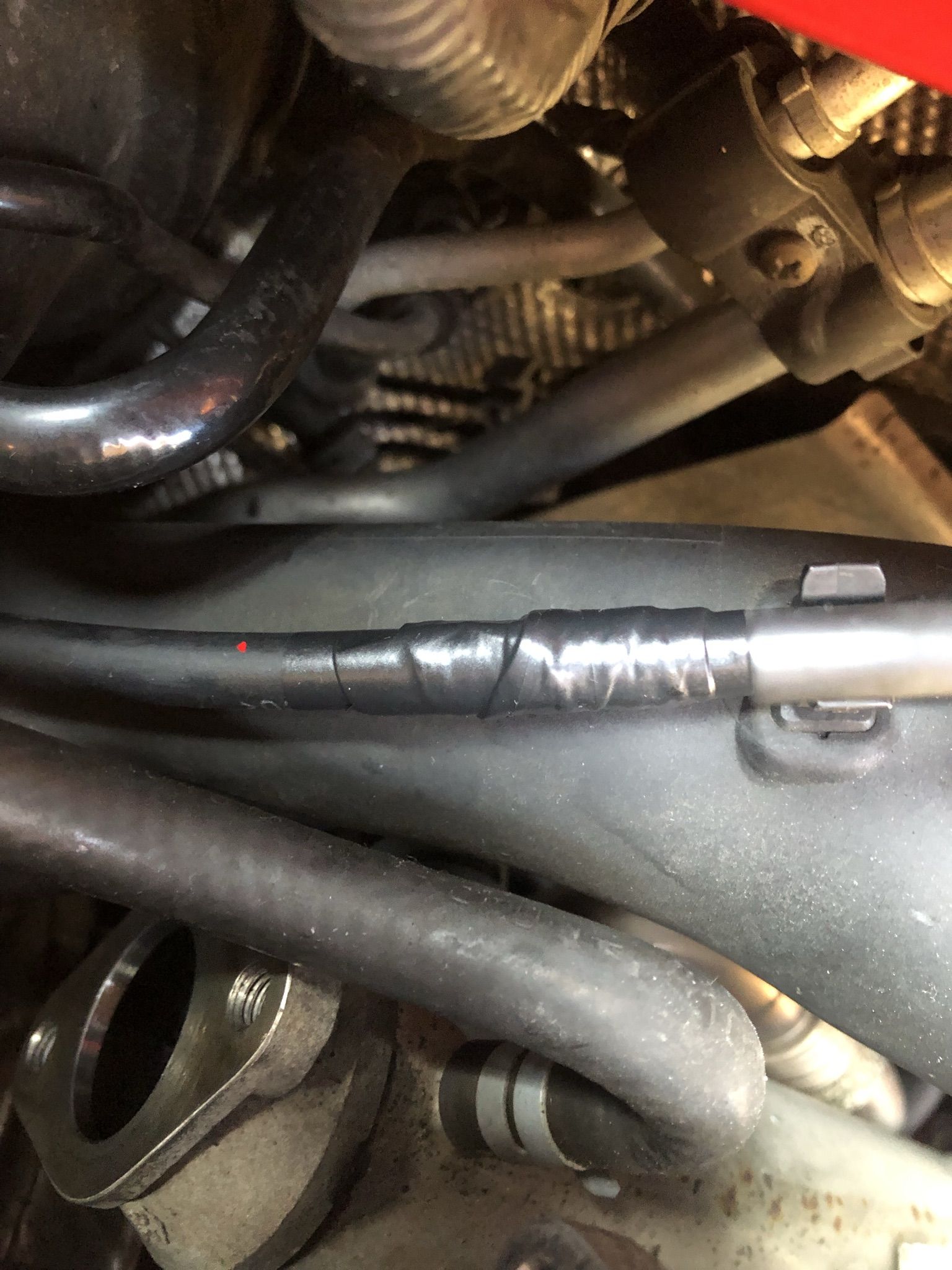

yea when i cut that pipe it had tobe bang on as it would kink, its been on since 2012 but it is the second pipe i did as the hose clips nipped the hose and leaked again that's why i used jubilee clips, the fuel hose is handy to have just in case though, might be worth looking into how to bend the pipe i did have an idea to use a heat gun to warm and set angles of pipe using welding rods to hold in place but never tried it.
the wear was nearly though but that tape i used should be ok also clipped underneath as well now, i traced it back but like you say you'd have to jack car up but was doing egr and oil change ect, no way the pipe fell off just wasn't clipped back in something simple like that would cause a right headache to fault find glad i seen it
