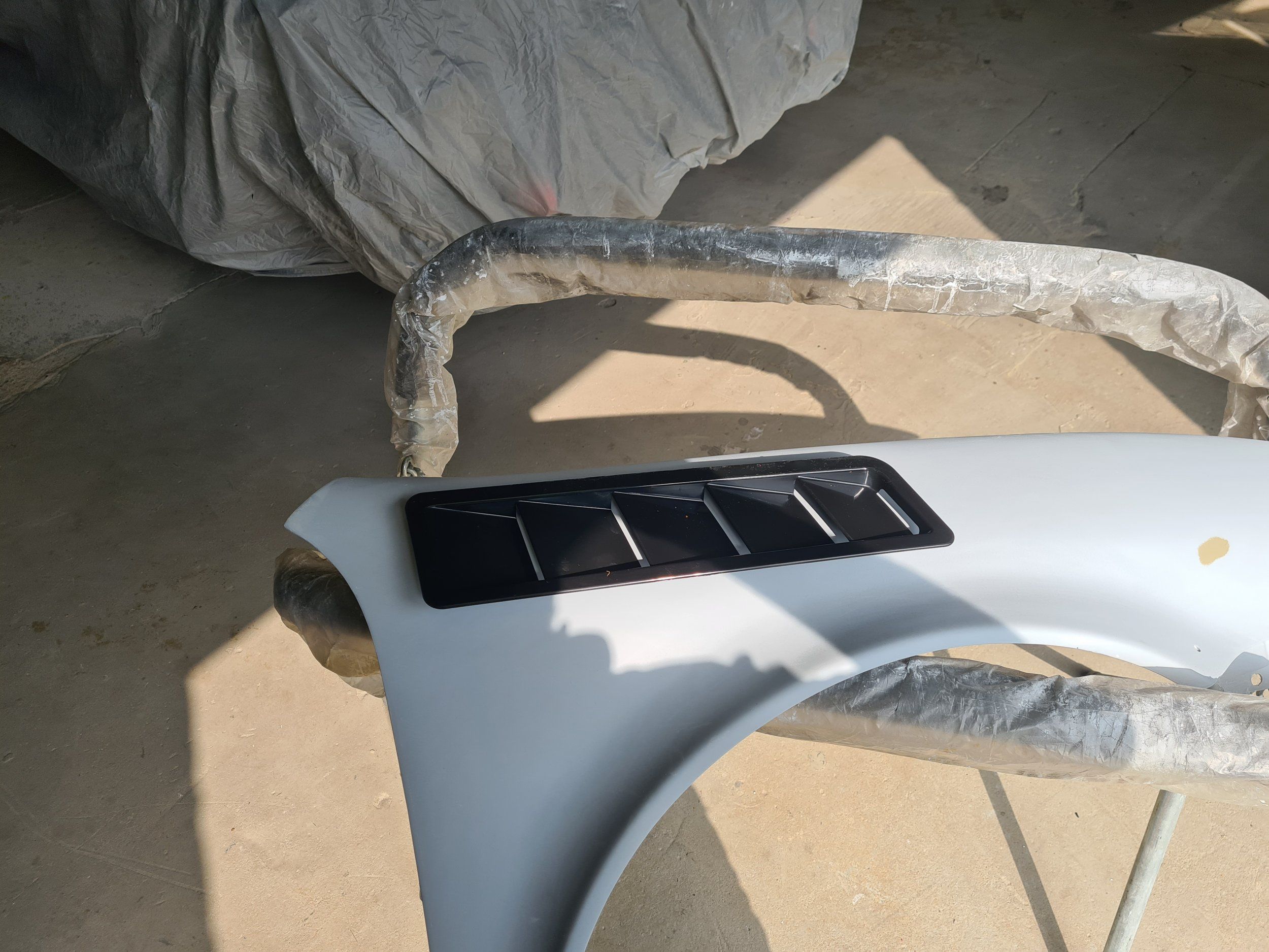

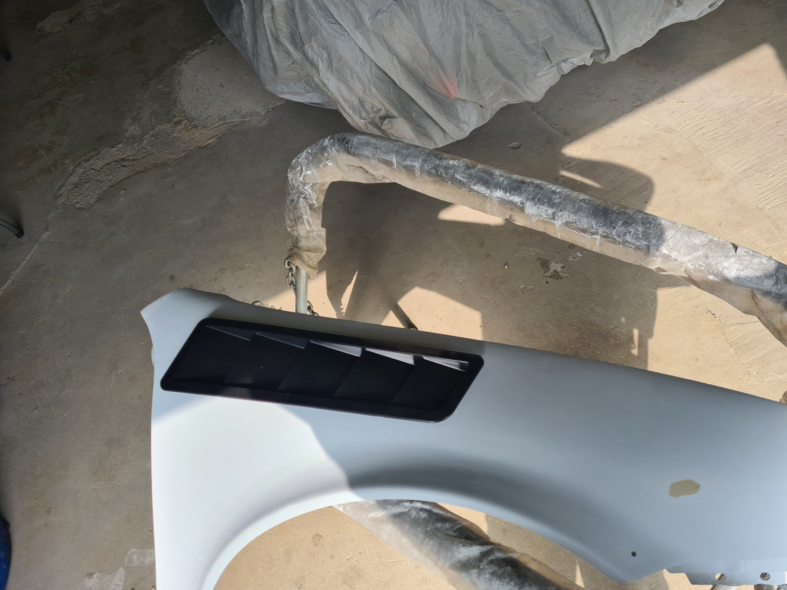

Right... you lot got 10 mins to vote...
Sort side along the top
Long side
Or no vents.
The idea is to draw out the hot air from the brakes and to remove the air from the arches that comes in over the coolers too. Help stop the build up of air and help reduce drag.
Right vote away...pics to follow
Long side View attachment 26953
Or no vents.
I get the reason but a) they don’t look great and b) there’s other ways to go with the air (arch vents don’t reduce drag btw, those would increase drag)
If it were me I’d seal the coolers at the front off from the arches and vent the air downwards, if you use a flap on the leading edge of the vent then it draws air out venturi or gurney style, and also acts as drag reduction device by creating an air fence in front of the tyres (Porsche and Ferrari use this).
As for air in the arches. I’m not saying don’t use vents but (again personally) the vent position is too high, there’s interference from the top edge of the wing plus from the wing mirror, lower and further back should see better results whilst keeping it away from spilling to the underside.
My understanding was brake heat should be getting ejected through the wheels but on that I’m only up to date on road cars (sizing for drag reduction vs brake requirements)
I couldn't think of the proper word. But I got coolers in the front of the arches with ducting going to them so will have air being forced in the the arches fron the front I could drag the air out with ducting at the floor and then out under the sills

Its a no from me.
I know its function over form but there must be another way.
Sorry, was editing my post to reflect my reasoning
