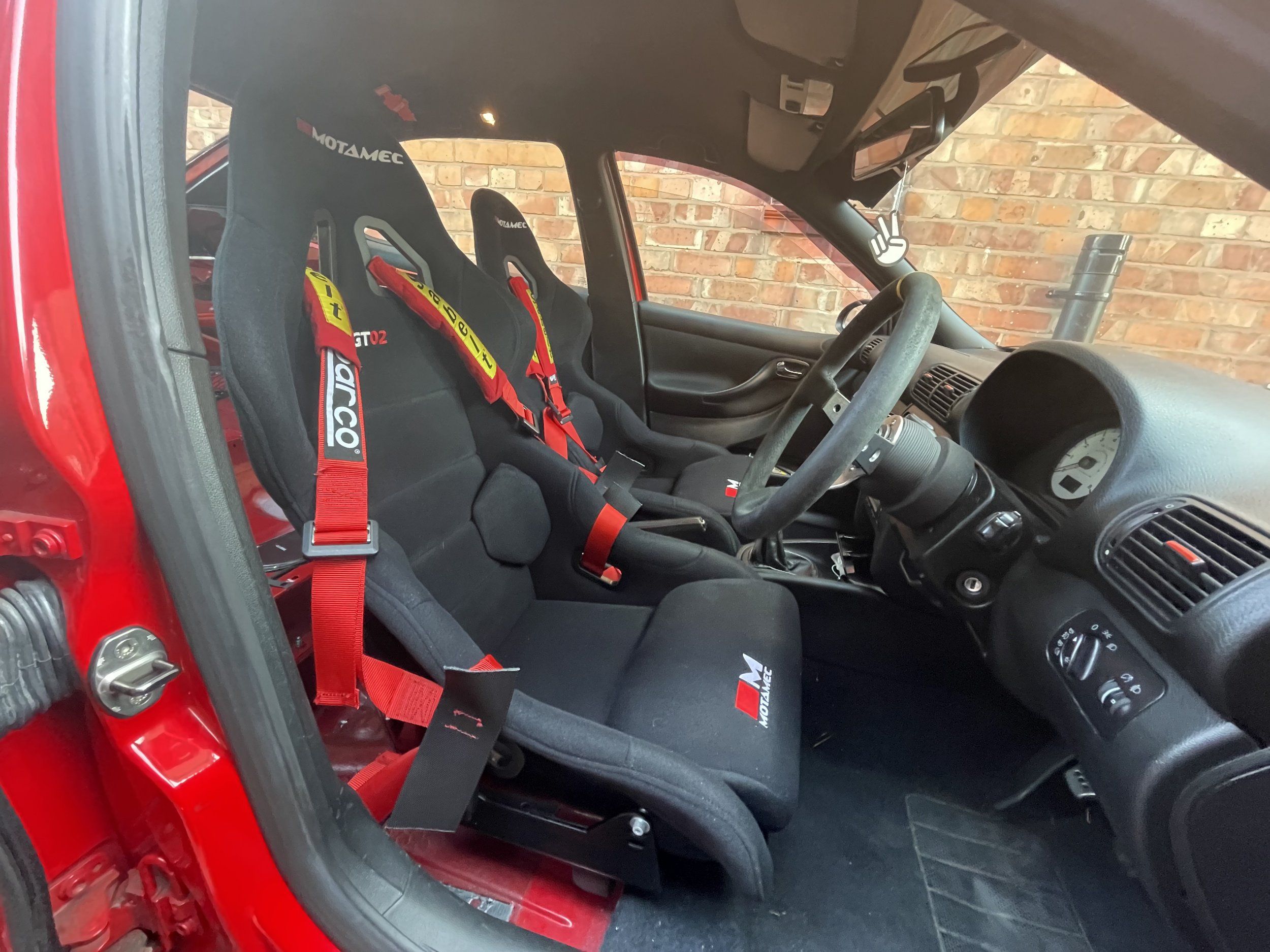

Fitted new seats & went for a drive!

There's something to be said for not having carpets/sound deadening, something I found out after a water bottle decided it fancied a change of career and leaked in the passenger footwell on a road trip.
It was fun bailing it out in a motorway services
Reactions: iammooks and Rich.T
Sl1ced
Oct 10, 2020
772
397
Drill a hole in the floor
