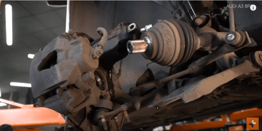

LCR AL
Jun 5, 2020
82
49
I can't tell from your pic if the arb drop link has been removed for more lower arm travel?
When I did my suspension (lcr), I removed the 3 bolts on the ball joint end and levered the lower arm down with my jack handle.
It was a pain without the proper splitter tool and yes a hammer was involved!
Sent from my SM-A405FN using Tapatalk
Took the drop link bolt out when I was taking everything apart, and that definitely gave me more room to play with.
I think removal was easier because I could compress the shock, and because they were shagged, there was no real pressure pushing the shock back out to its full length. Because the new ones are fully pressurised, and so it’s both harder to compress, but also returns to its full length really quickly even if I can compress it.
I’m going to give it another go this morning with the ball joint out of the control arm. The trouble is I’m knackered now, and that makes me do stupid things.
It’s just weird though - there are loads of videos on YouTube where they just put the top in and tighten the top mounts, and then there’s loads of room underneath to get the lower into the knuckle - even without undoing the ball joint or the driveshaft - they just slot it in and jack it up to tighten.
