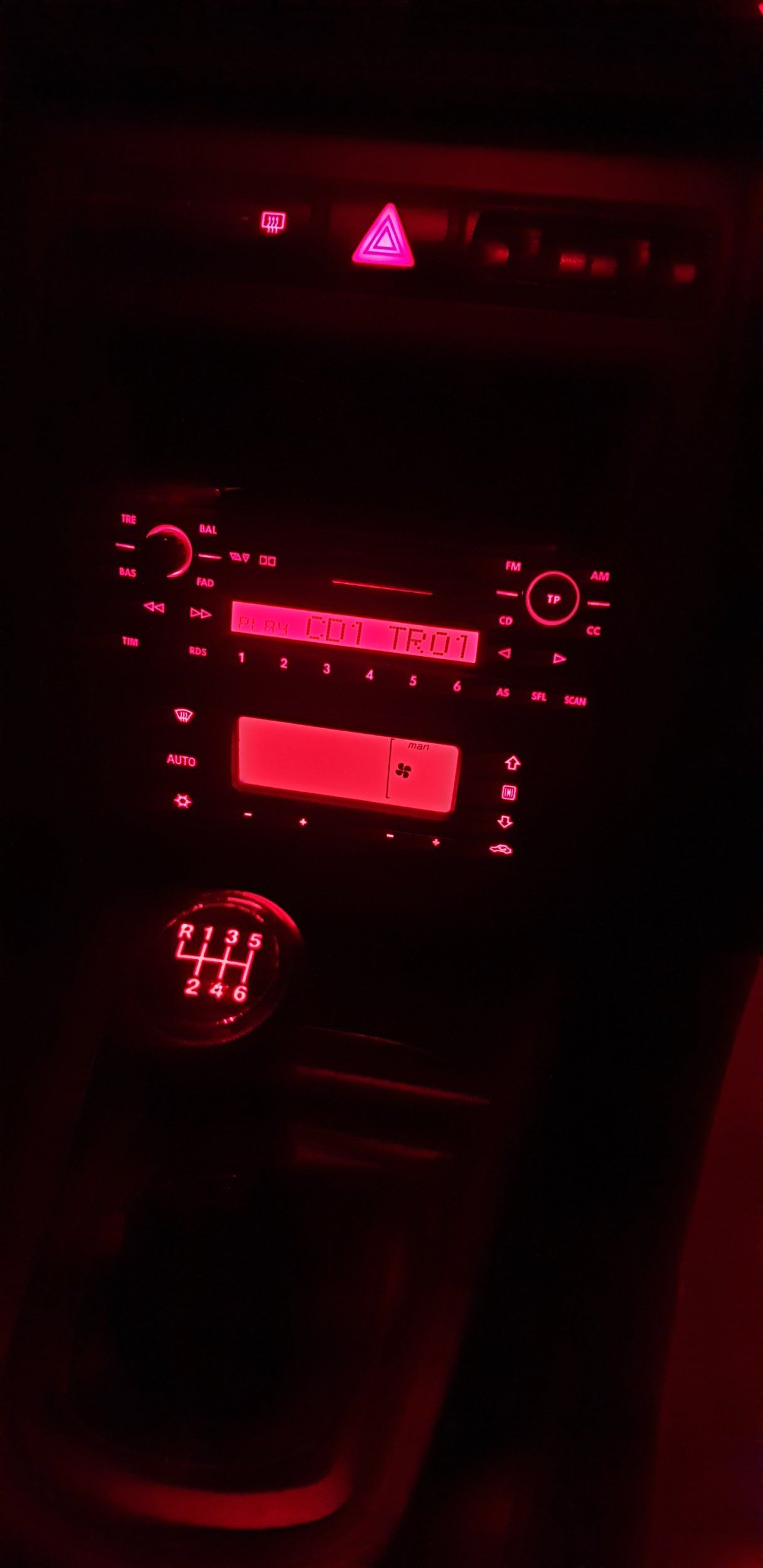

Changed the LCD light in my gamma stereo from blue to red, so it matches the rest :D

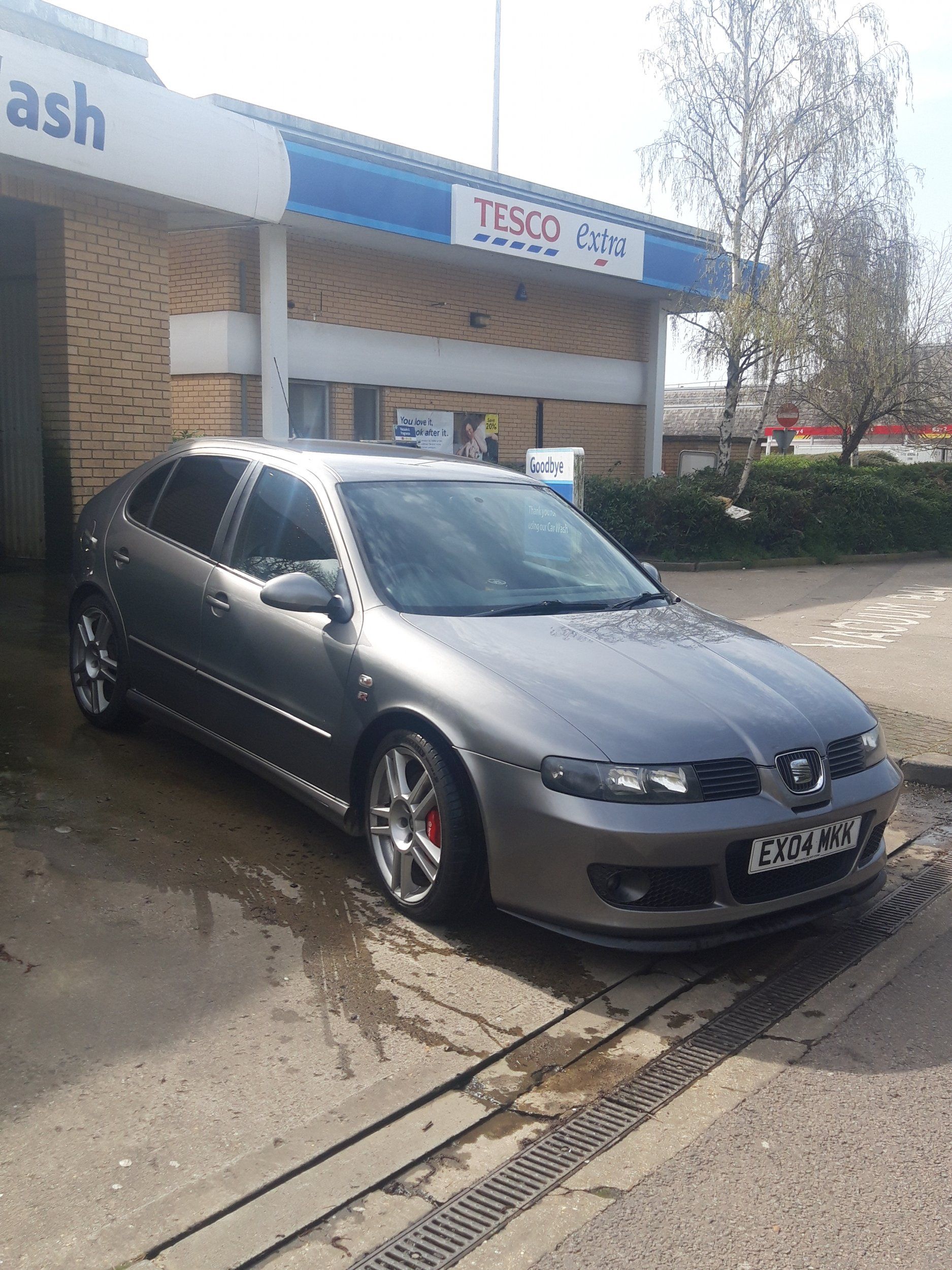

Took it for a hand car wash. Parked it at work yesterday. Found out that id be kipping in my lorry last night so, not only was i hanging today, to was the car (parked under a tree). Then it started to rain!

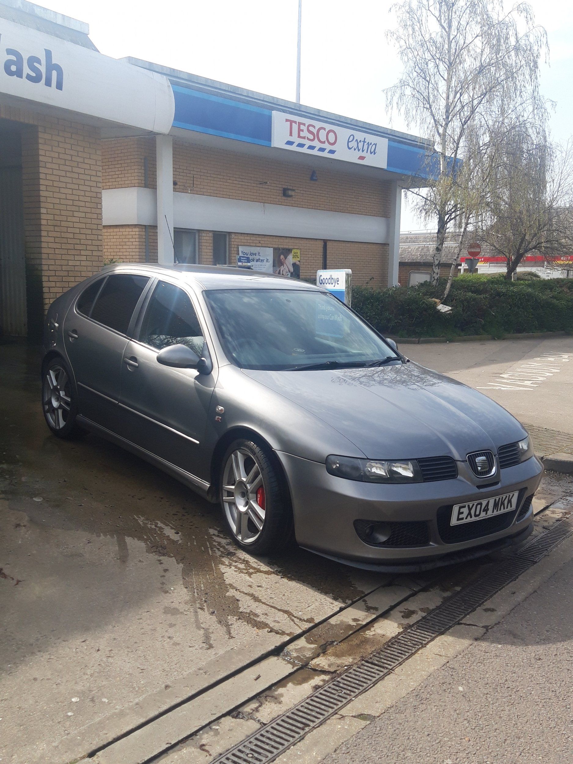

You're the first person outside of Cornwall I've heard use the word 'hanging' in that way...
