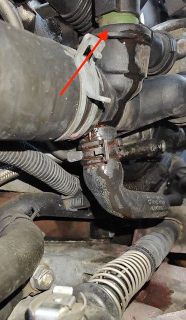

I seemed to have an intermittent coolant leak - found a pool of the stuff on the top of the gearbox casing. Turned out the coolant temp sensor was weeping.
Re-seated it and noted the re
taining clip was somewhat bendy so orderded a replacement Febi/Blstein CTS that came with a new clip. The replacement clip was way more substantial and stiffer - in fact what came off had quite a lot of moulding flash on it so I'm assuming it was a poor copy part.
Thankfully seems to be holding pressure and coolant ok now, though if it plays up will switch in the new CTS along with fresh o-ring.
