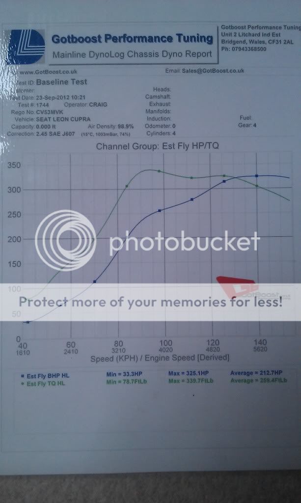

My latest Power graphs from last weeks RR at Gotboost (Highly recommended)
Power at the wheel
Power at the fly

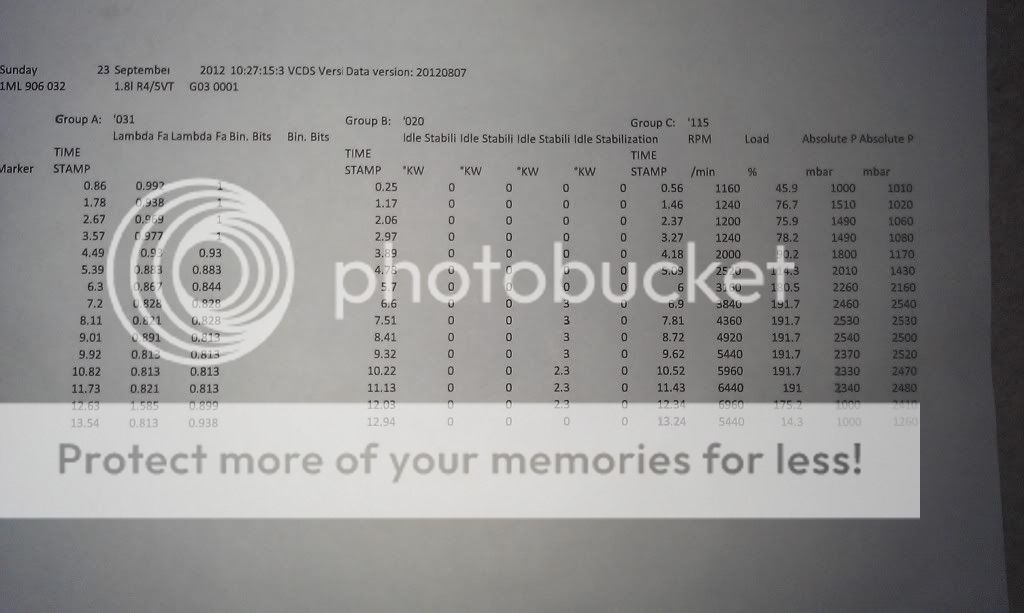

Vagcom logs from a run on the day.
I lost some power and torque low down by injecting wmi too early? Hoping to find another 25bhp with future mods and tweaking.
