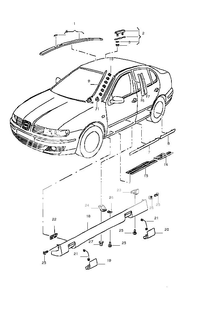

i need the part number of the plastic trim that fits either side of the windscreen as mine appears to have a chunk missing from the passenger side. any ideas of price also?

thanks for that, bit of a misunderstanding on the windscreen trim, the bit i need is the black strip on the outside. also, does this just pull off?
think they're item 9 then
(9) 1M0854327B
