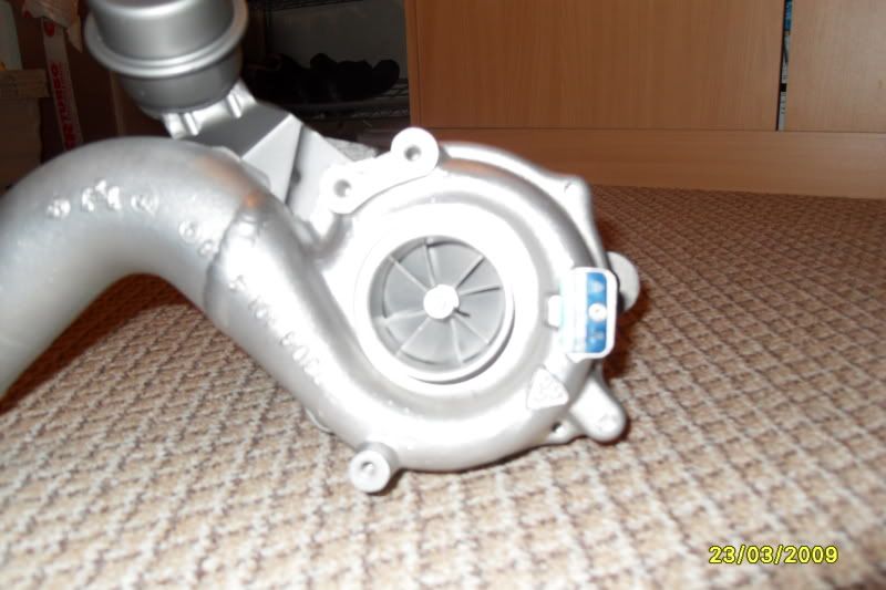

After deciding not to sell after the crap six months i had with the car i decided to start where i left off.
I`ve decided that im going down the k03s hybrid route as it saves alot of hassle messing around with DP`s water/oil lines etc.. everything attaches to the mods i have in place now manifold DP etc.. the only things i have to uprate are the injectors to LCR (bam) ones and also a 3" MAF housing and turbo intake pipe, i`ve also uprated the fuel pump to a BAM item for peace of mind on the flow side of things. Im hoping it should produce hopfuly a touch more than the k04, hopfully in the region on 280 - 290bhp and around 290lbft.
Mapping will be done by Bill at badger5 using CC3, in my eyes hes the right man to get the best out of the setup.
Abit miffed about the colour match of the TIP and elbow but im thinking of replacing this with a CAI into the wing or an alloy 45deg elbow.
There will be more updates as the im having a change around in the bay, trying to move away from the polished as its been done to death now, hoping for more of a motorsport look incorporating abit of euro, im going for matt black and red with touches of chrome plus trying to minimise things in the bay, header tank is now gone the battery and washer bottle will be relocated to the boot and alot of wire tucks/tidying.
Its turned out that ill also be able to afford a nice set of brembos aswell the only thing really missing IMO. Pics to follow.
