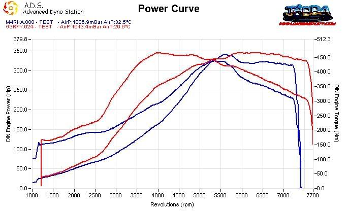

comparison of a IHI VF34 compared to a backdraft kit GT2871R with a .63 housing.
red line is our IHI turbo kit. The blue line is the backdraft kit
The first line that comes up is the torque that then crosses over with the horsepower as that comes up.

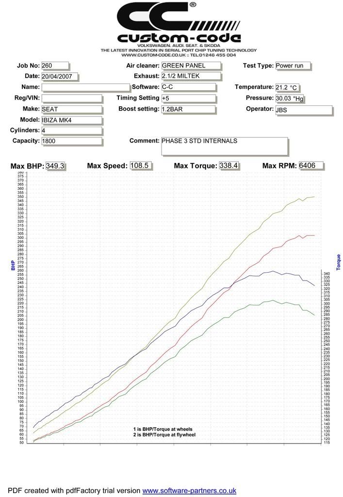

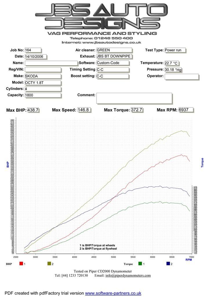

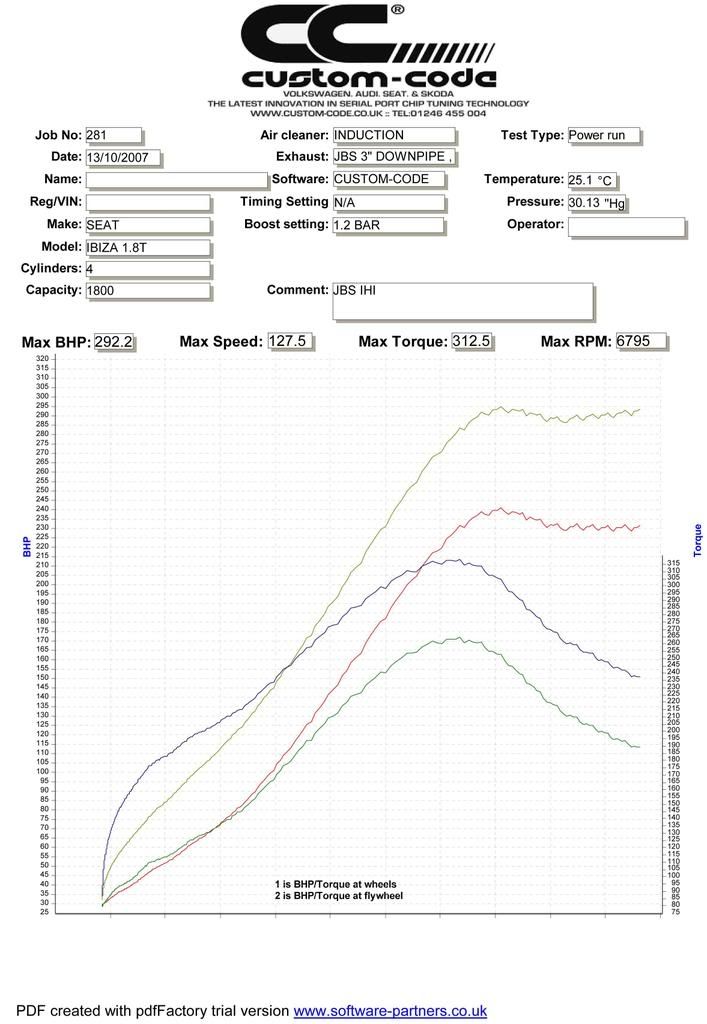

Sent to me for jabba sport but it dosent look right to me?
JBS sent me 4 grarphs
1st is GT30 2 of them are IHI stage 1 and 1 is IHI stage 2
How do they look?

Gt2871 has alot more in it while the ihi is maxed out.
IHI pushing that graphed bhp level is going to be 1.6bar at least.. hard for a vf34
GT2871R for that same level is more airflow... and will be more power.
If I plotted a GT35R on 0.3bar boost and a k03s on 1.4bar boost which one will make the higher power, and what would those plots look like?
(extreme example, just making the point, more info req'd on the plots to see whats going on or make judgement)

The jabba IHI plot looks very maxed out I was told them turbos can only make 330bhp
the gt2871r looks like it could do more not a very good advert for backdraft
sorry guys dont know why every one has got it in for them lol

how is it not a good advert for BDMS.....
as Bill said, need more info i.e. boost levels etc as it could be running a conservative map

because that is what jabba sent me to show there IHI kit vs BDMS GT2871r kit
your rite there is no info on it they must of just cut it off lol
because I asked them for a GT28 kit priced up
jamiebennett81
so an unbias source of information then if Jabba sent it to you for comparing their map against BDMS's one then?

i think jabba had a car in with a backdraft kit on but they mapped it hence why they have the 2 graphs to compare:)
its a comparison between an Jabba IHI and a BD kit done on Jabba rollers.
is it like for like boost wise?
it will likely be different mapping, or is it?
just a few too many knowns to make judgement based on the graphs.
indicative i guess, but ipsofacto? :no:
