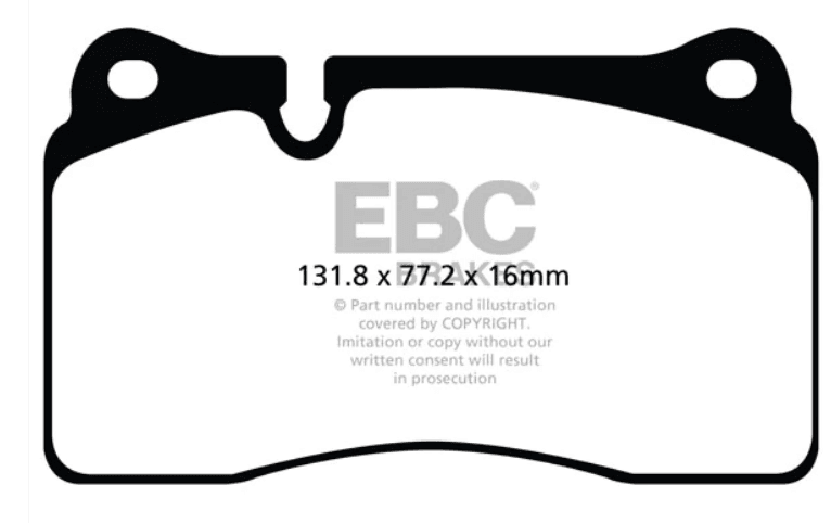

Yes, they'll fit the caliper - its just a common brembo pad shape - but with no WI notch, so not ideal for a road car!
I would just cable tie the WI out the way behind the wheel arch liner.
The EBC ones according to their ident drawing have a WI notch. We'll see?
Those rear EBC pads have an R90 number on them - but can't see any images of the back of DP32070C, so it will be interesting to see if they also have an Reg 90 number? (probably E11 90R ..... ) If not they are actually illegal for road use. Whether anyone will check/insurance? Probably a very low chance.

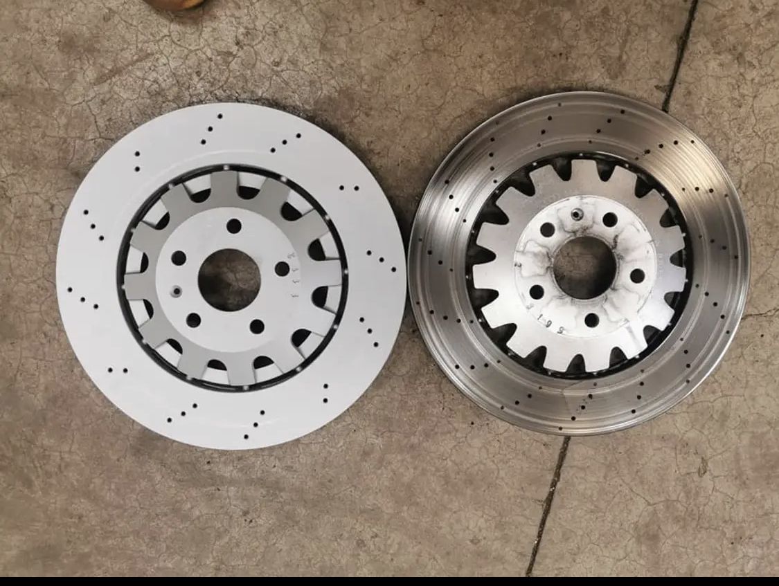

To be clear, the Zimmerman discs are not 1kg lighter than the OEM discs.
I have seen the OEM discs listed at 11.29kg and killer brakes have them at 24kg for 2x which may include the box?
So the OEM discs made by SHW in Germany are actually a little lighter than the 12.1kg Zimmerman's
This makes sense as Zimmerman have changed the tophat design and include more alloy than the SHW.
Incidentally SHW invented/patented this pinned composite disc design with an alloy hub, first used on the old M3's, and subsequently used on the majority of serious high performance cars with an M/RS/AMG badge. The original R32 had SHW pinned discs - but the later versions and even the R Golf has full cast iron (cheaper and heavier!).
These OEM discs are a lovely piece of machining - but they are expensive!

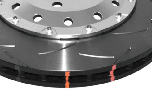

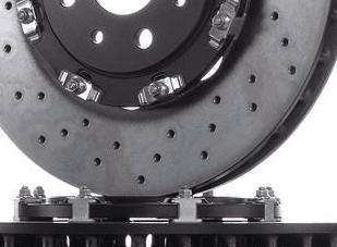

Agreed on the weight saving not being important or even noticeable.
Not a fan of the DBA rigidly bolted mounting the bell to the friction ring TBH. Prefer the SHW pinned design or fully floating.
As the disc friction surface gets hot it expands radially. Usually 'racing' discs which a floating have slots and bobbins to alloy the discs to expand and contract uniformly without distorting and coning.
The SHW OEM disc pins are centrally located which minimises coning, where as the DBA bolted design is offset to one friction plate - which has the same limitations as standard full cast iron discs.

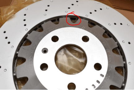

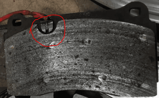

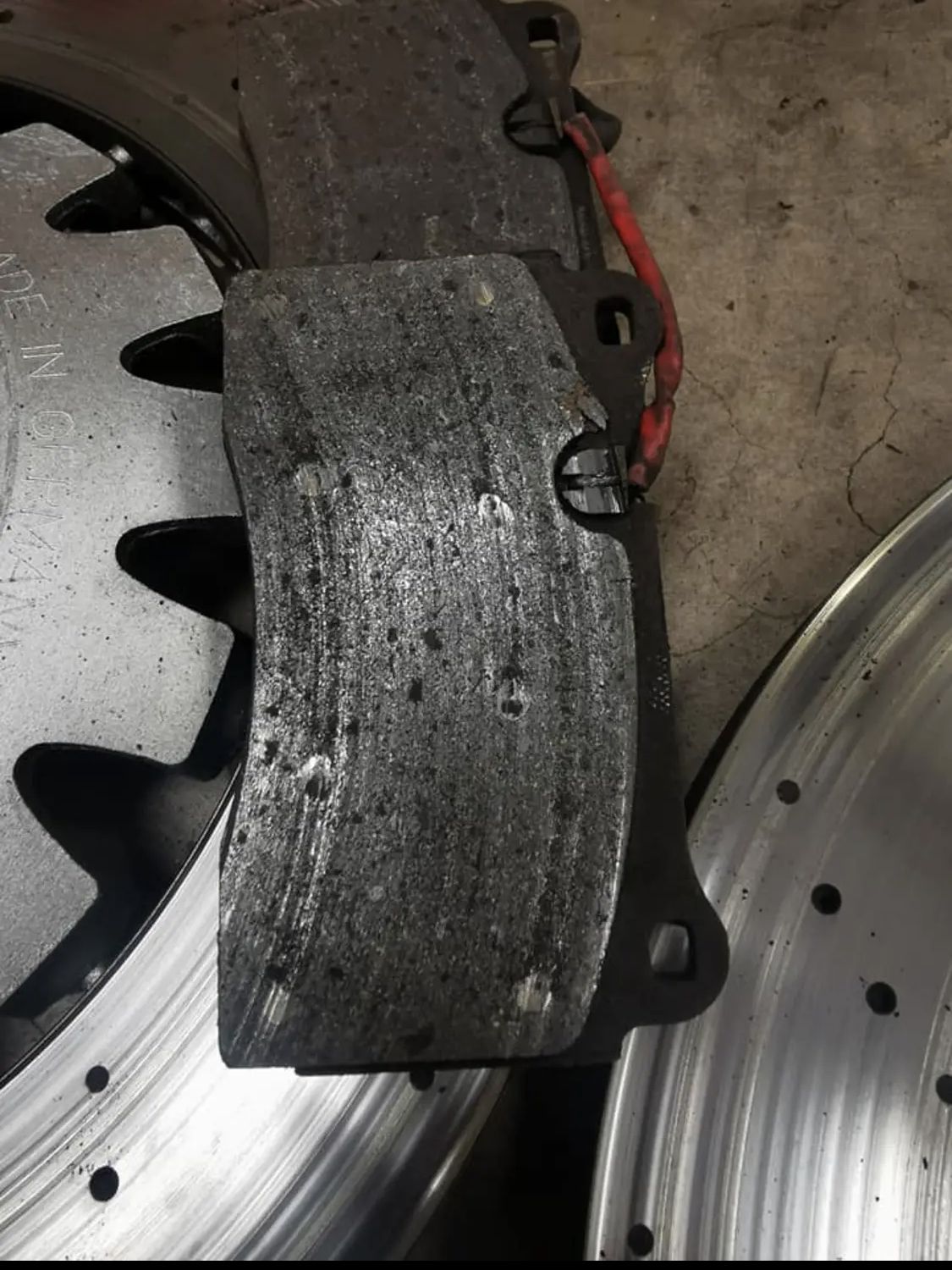

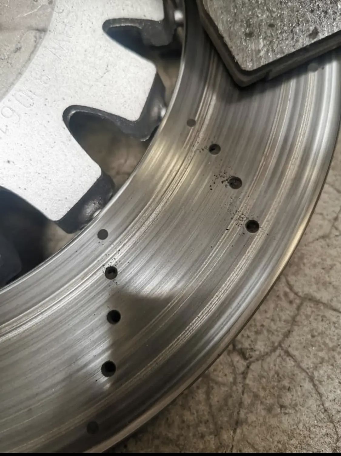

How much material did/do you have left on the pads? Would like to see photos of the worn pads and discs?
My pads are about half worn now, Ive not had them off yet, but my disk is looking like the one in this picture from another R ST user.
Note the last one is Zimmerman vs OEM disc for comparison of design

These are off another R ST?
The wear indictor has been worn so judging by this they are probably due for a change.
Yes they are off another R ST, I’ll post pics of mine when I do the change in a few weeks.
My disk looks the same as that one in the picture thou so I’d assume my pads are the same.

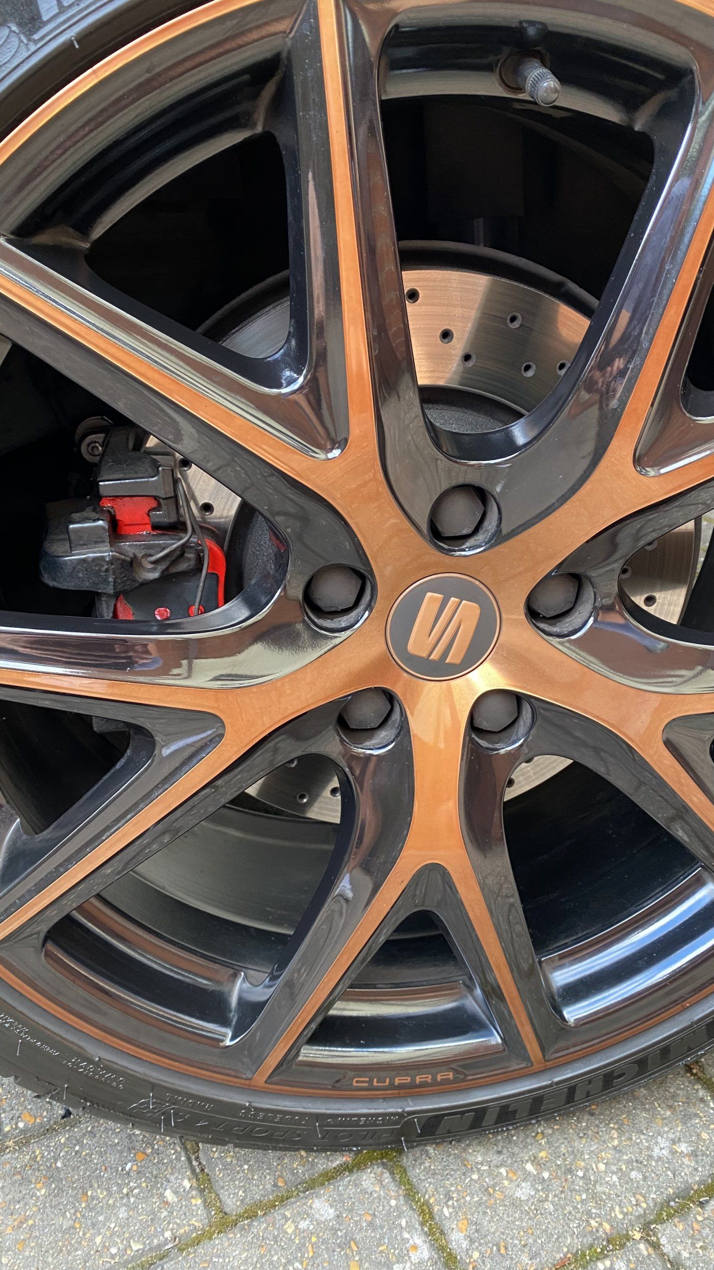

Just a little update on this.
I did the disc and pad change a few weeks ago and very happy with the results.
My disc and pads were starting to look just like the ones in the pictures posted above (scoring on disc from the pads)
I was so focused on doing the job I forgot to take pics as I went along, so pics below are taken the other day after a few hundred miles of the new discs and pads.
Very happy with the EBC red pads, minimal dust and after bedding in properly there is a noticeable improvement in stopping power over oem.
The Zimmerman front discs at half the price of OEM seem like a good buy, good quality and have the anti rust coating that the OEM discs lack.
I did weigh them before putting on and came in at 12.1kg.
The OEMs coming off were 11.9kg so there were a tad lighter after all that, but they do have ~5m lip front and back where they have been worn down, so it’s conceivable they were heavier when new ??
The rear Brembo discs were a little lighter than the oems coming off (sorry can’t remember the figures) so that offset and extra weight if any of the Zimmerman fronts on the cars overall weight. Negligible amounts here anyway tbh.
Quality of these rear Brembos is very very good and for £77 a pair are great value imo.
Disc part numbers are listed in posts 3, and EBC Pads in post 5 for reference for anyone.
Car is 2019 R ST with 4pot brembos on the front.
