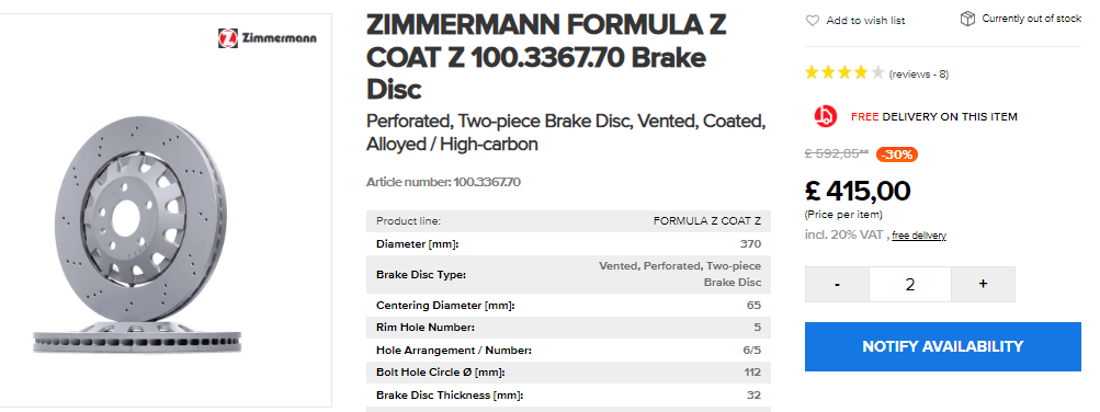

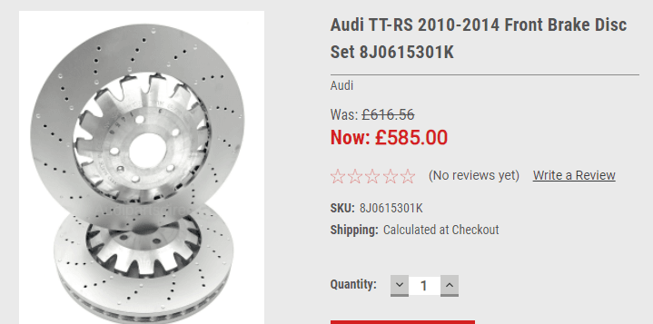

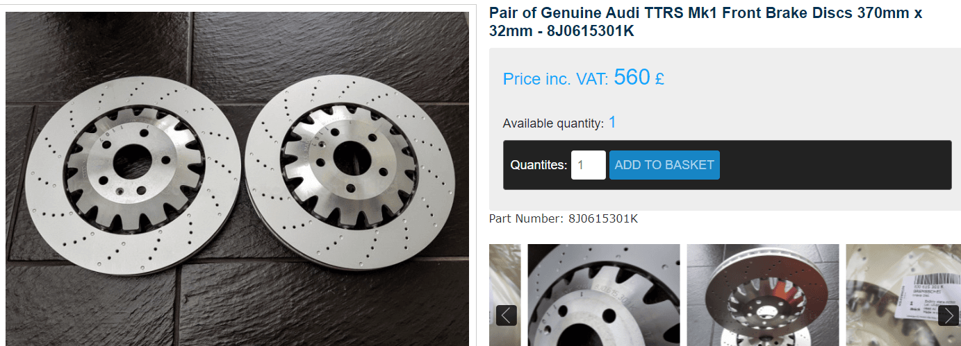

I'm not sure what prices you found?
But quick searching I see the Zimmerman at £415 each discs (autodoc) and the OEM £585-£560 for a pair of discs! £292-£280 each.
Just found an ebay link for the Zimmerman's at £600 for a pair so similar price to the OEM!

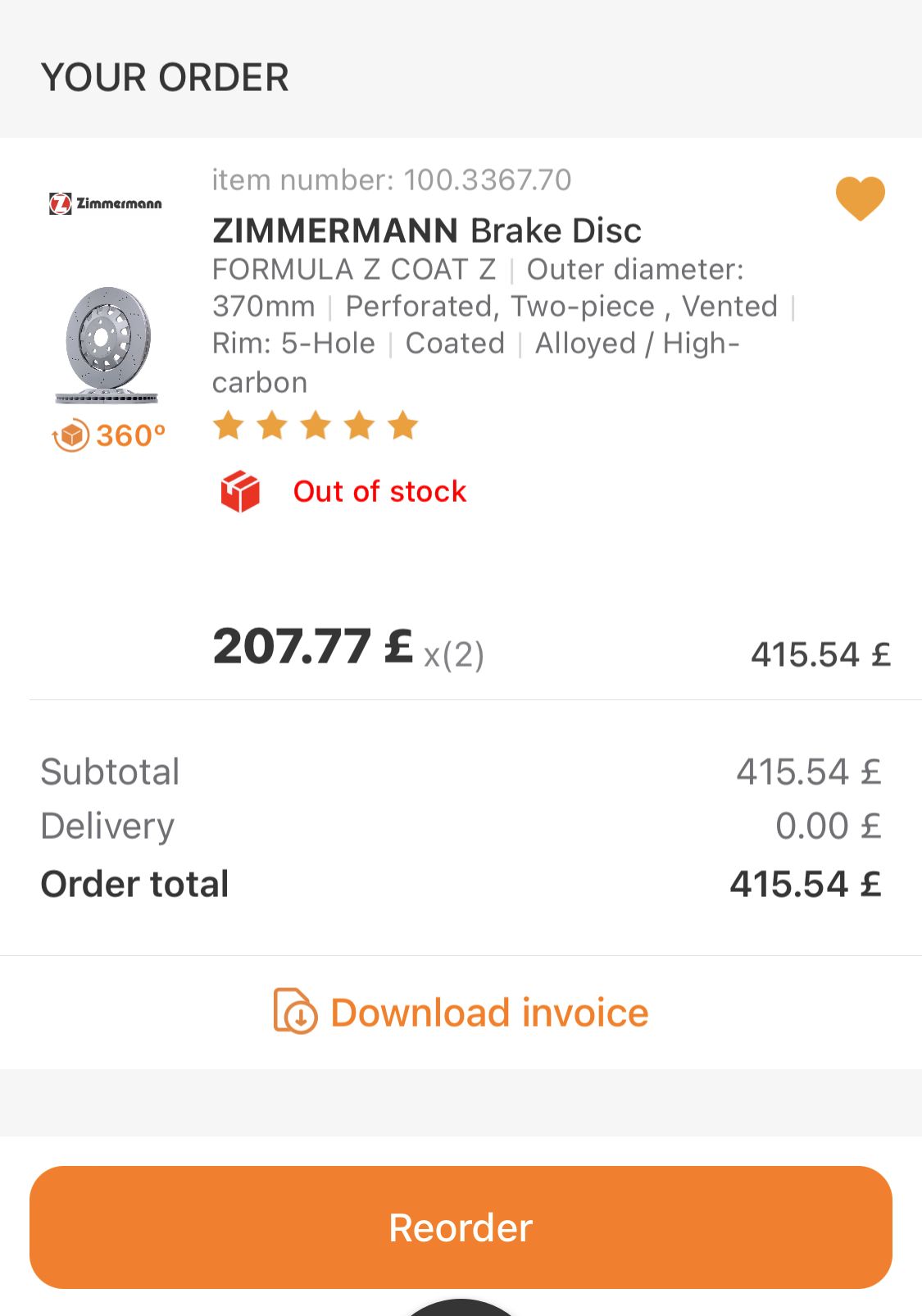

I paid £400 for the pair from Autodoc for my Zimmermans, couldn’t find any OEMs at the time for less than £680, but this was a few months ago.
To be honest, even priced the same I would have probably choosen the Zimmermans, my OEM ones were rust buckets so I’d be keen to try something else.
Time will tell how they hold up, but I short term impressions are very good for the (what looks now like a bargain) price I paid.
Wow some price increase! Currently £415 each! Though no stock!
Yep double the price !!!!
I was given the heads up on them by another R ST owner who paid £380 for a pair a few weeks before me, so I was annoyed paying £415 (not £400 previously said) for a pair !

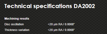

Personally I'm not a fan of on car brake disc turning.
Modern discs are machined to very high tolerances (less than 10microns thickness variation!) and on car 'lathes' are relying on your own wheel bearing for running accuracy and stability!
The only specification I can find (they normally don't say what runout & DTV tolerance you can expect which again is a red flag!) was <20 microns. Double the requirement!
Not good enough for a modern high performance car! Probably ok for a Transit or a Landrover!

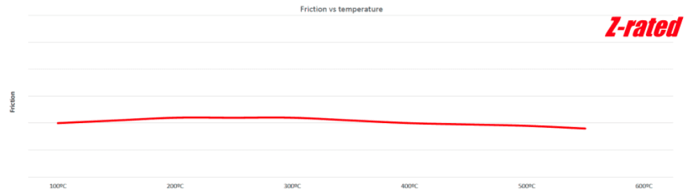

I wouldn't bother with oem pads. For the money there are plenty of real high performance options. I would go for Hawk pads or DS2500 for this kind of money. At the moment I run PFC Z-rated which is an all around performance pad. Zero noise, zero fade in the track and very gentle with the disks. The same applies for the previous set of Hawk I had which were even better when it came to initial bite.
