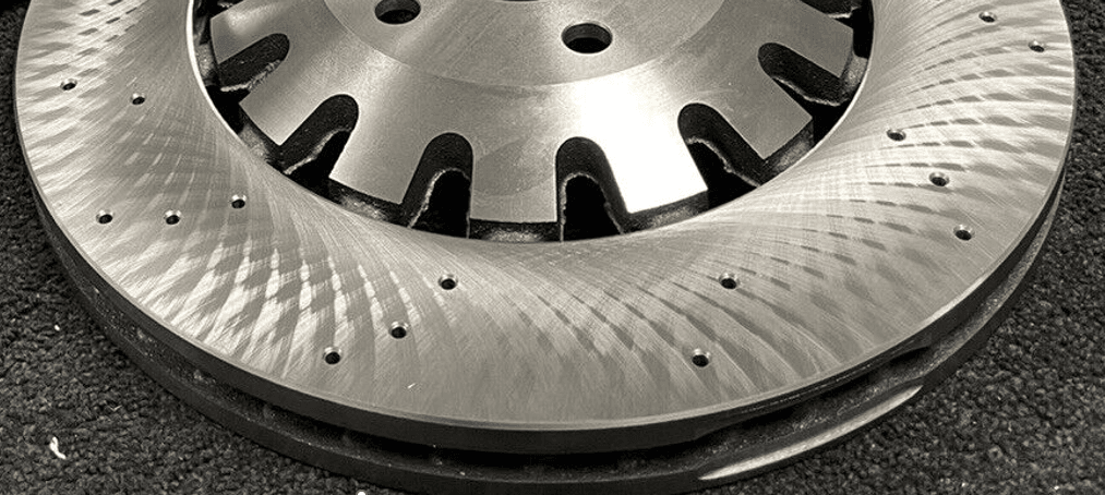

I think the discs are early TT-RS parts, I've seen what look to be the same discs for around £400.
Those on ebay for £389 look terrible.
Sure they should bolt on and be fine for putting around town but I would not want to heat cycle them! - the casting quality, not to mention the design looks bad. They are one-piece cast iron, trying to replicate the steel pins/alloy tophat/composite design of the OEM.
That is a very small section of cast iron to be in shear!

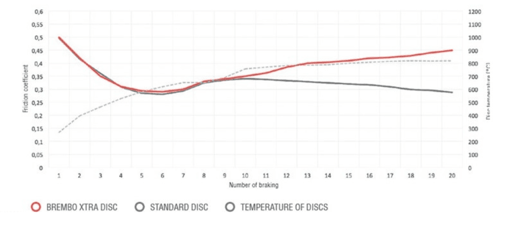

I googled this, and Brembo appear to disagree with you...
From Brembo and their "5 reasons for purchasing drilled discs" - their ONLY actual data (meaning the other 4 points are just marketing BS) is regarding gas dispersion (pad off-gassing) and for reducing brake fade.
There are so many important nuances to this - mainly in the pad friction material temperature stability - but you can see in 'their' data the only variance between drilled and plain discs occurs above 750deg C (dotted line)! You will never ever see these temps on the road, and even then, the difference in Mu (friction coefficient) will be gradual and still less than the fade around stop 6!
A different pad friction material will have drastically more influence on high temp fade than any disc holes.
