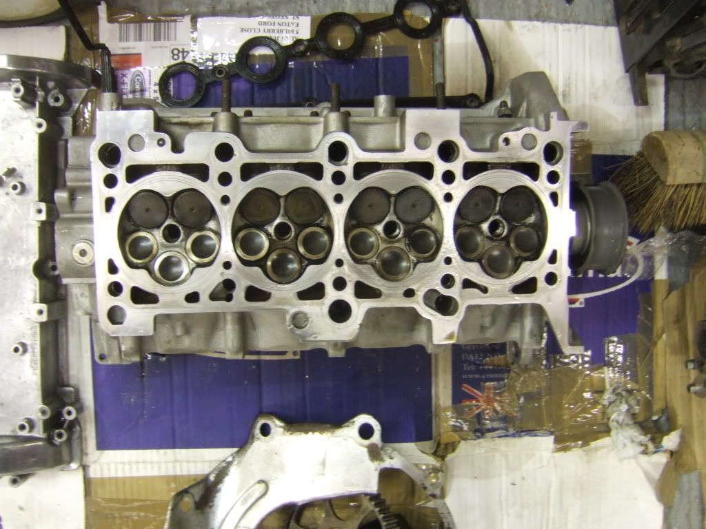

After closer inspection I realised it actually has an ADR largeport head rather than a ported smallport.
Does anyone know if there is a largeport inlet manifold avaliable? (cant afford a SEM right now) or shall I just gasket match my original manifold..
could you use a N/A inlet manifold as they are realy comon and im sure most are largeport arnt they?

AGU/AEB is the only big port inlet manifold, i used the AGU to make a custom one.

I think im just going to gasket match mine for now sure it will be fine for the hybrid.

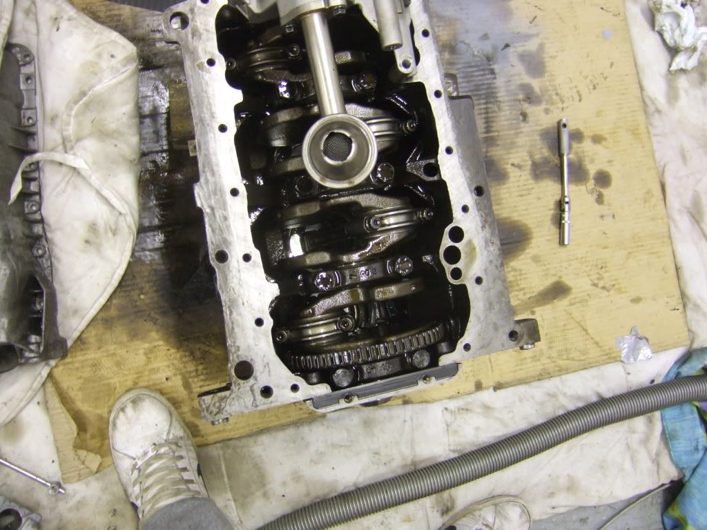

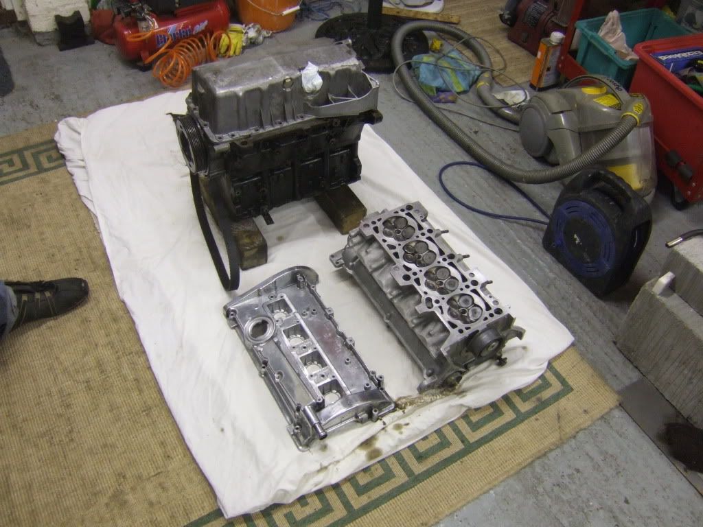

Had a big clean up today. Block just needs a lick of paint tomorrow and she will look like new.
Some sexy forged internals

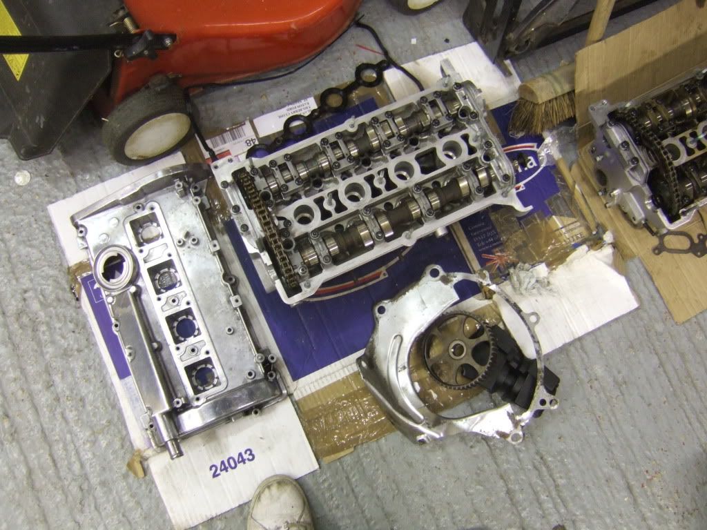

Cleaned up head..

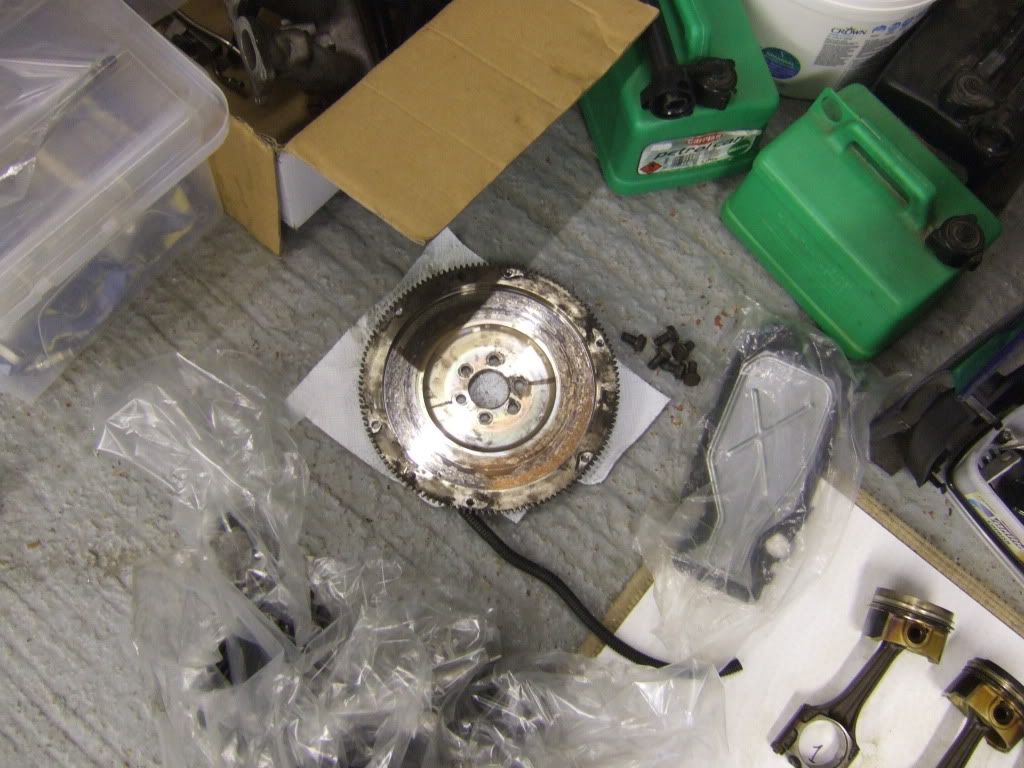

And a lightened G60 flywheel to 4.4kg

What are the inlet sizes on the head? All the info I have seems to point to the ADR being small port. Good cams in there tho.
Next too my smallport they are HUGE 54mm i think where as my smallport was 40something
Just googled "ADR largeport" and it confirms it is
